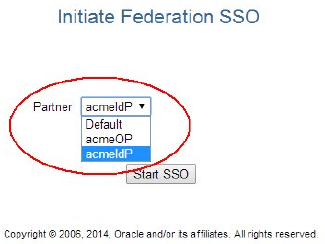

34.1.2.1 Starting Federation SSO Flow
- Navigating to the Test SP application through a browser
- Selecting the IdP to perform Federation SSO
- Starting the operation
To start Federation SSO:

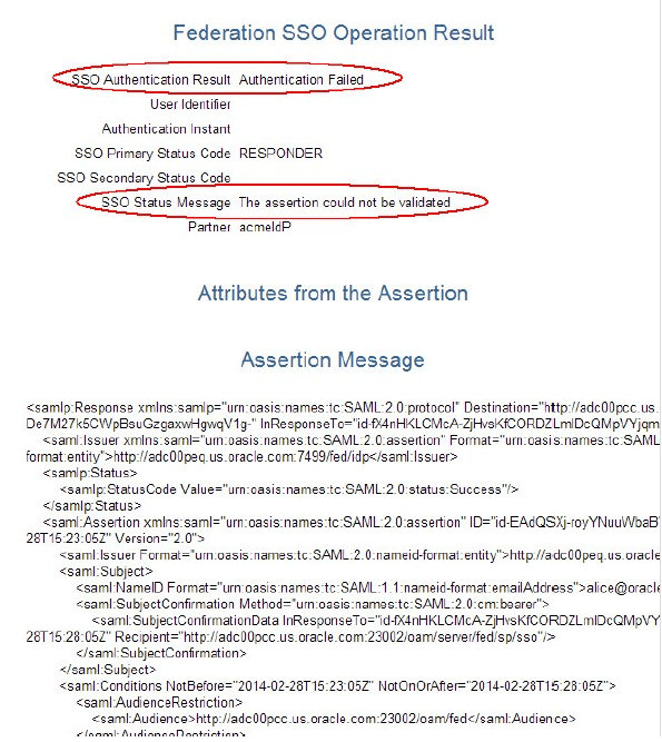

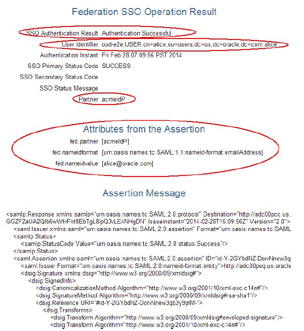

34.1.2.2 Displaying Test SP Operation Result
When the IdP redirects the user with the SAML Assertion/OpenID Response to OIF/SP,
the server validates the response and maps it to an LDAP user record.
- The result of the authentication operation.
- The canonical user ID to which the response was mapped that contains the Identity Store Name, User DN, and User ID.
- The authentication instant.
- The IdP partner name.
- Attributes from the SSO Response that are stored in the OAM session.
- The decrypted/decoded SSO response.

In the following example, the IdP and OIF/SP administrators agreed to use SAML 2.0 but the IdP is not signing the assertion as required by OIF/SP.
- The authentication operation failed message.
- The assertion could not be validated message.
- The SAML message.
