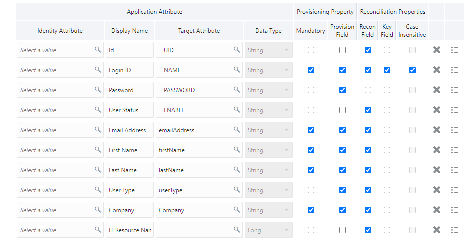

3.3.1 Attribute Mappings for the Target Application
The Schema page for a target application displays the default schema (provided by the connector) that maps Oracle Identity Governance attributes to target system attributes. The connector uses these mappings during reconciliation and provisioning operations.
The following table lists the user-specific attribute mappings between the process form fields in Oracle Identity Governance and Oracle Primavera target application attributes. The table also lists whether a specific attribute is used during provisioning or reconciliation and whether it is a matching key field for fetching records during reconciliation.
If required, you can edit the default attribute mappings by adding new attributes or deleting existing attributes as described in Creating a Target Application Creating a Target Application in Oracle Fusion Middleware Performing Self Service Tasks with Oracle Identity Governance.
Table 3-3 Default Attributes for Oracle Primavera Target Application
Display Name Target Attribute Data Type Mandatory Provisioning Property? Provision Field? Recon Field? Key Field? Case Insensitive?
Id __UID__ String No No Yes No Not Applicable
Login ID __NAME__ String Yes Yes Yes Yes Yes
Password __PASSWORD__ String No Yes No No Not applicable
User Status __ENABLE__ String No No Yes No Not applicable
Email Address emailAddress String Yes Yes Yes No Not applicable
First Name firstName String Yes Yes Yes No Not applicable
Last Name lastName String Yes Yes Yes No Not applicable
User Type userType String No Yes Yes No Not applicable
Company Company String Yes Yes Yes No Not applicable
IT Resource Name __ Long No No Yes No Not applicable
The following figure shows the default User account attribute mappings.
Figure 3-1 Default Attribute Mappings for Oracle Primavera User Account

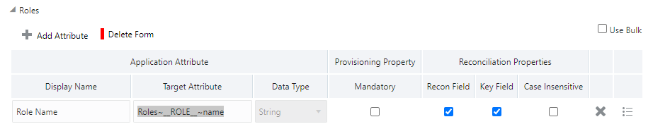

Oracle Primavera Role Entitlement
The following table lists the roles forms attribute mappings between the process form fields in Oracle Identity Governance and Oracle Primavera target application attributes. The table lists whether a given attribute is mandatory during provisioning. It also lists whether a given attribute is used during reconciliation and whether it is a matching key field for fetching records during reconciliation.
If required, you can edit the default attribute mappings by adding new attributes or deleting existing attributes as described in Creating a Target Application in Oracle Fusion Middleware Performing Self Service Tasks with Oracle Identity Governance.
The following table shows default Attribute Mappings for Roles
Table 3-4 Default Attribute Mappings for Roles
Display Name Target Attribute Data Type Mandatory Provisioning Property? Recon Field? Key Field? Case Insensitive?
Role Name Roles~__ROLE__~name String No Yes Yes No
The following figure shows the default Roles Entitlement mapping.
Figure 3-2 Default Attribute Mappings for Oracle Primavera Roles

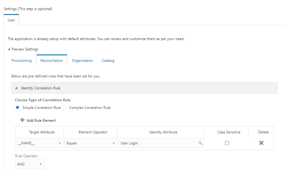

Predefined Identity Correlation Rules
By default, the Oracle Primavera connector provides a simple correlation rule when you create a target application. The connector uses this correlation rule to compare the entries in Oracle Identity Governance repository and the target system repository, determine the difference between the two repositories, and apply the latest changes to Oracle Identity Governance.
The following table lists the default simple correlation rule for an Oracle Primavera connector. If required, you can edit the default correlation rule or add new rules. You can create complex correlation rules also. For more information about adding or editing simple or complex correlation rules, see Updating Identity Correlation Rules in Oracle Fusion Middleware Performing Self Service Tasks with Oracle Identity Governance.
Table 3-5 Predefined Identity Correlation Rule for an Oracle Primavera Connector
Target Attribute Element Operator Identity Attribute Case Sensitive?
__NAME__ Equals User Login No
In this identity rule:
  • __NAME__ is a single-valued attribute on the target system that identifies the user account.
  • User Login is the field on the OIG User form.
The following shows the Simple Correlation Rule for Oracle Primavera Target Application
Figure 3-3 Simple Correlation Rule for Oracle Primavera Target Application

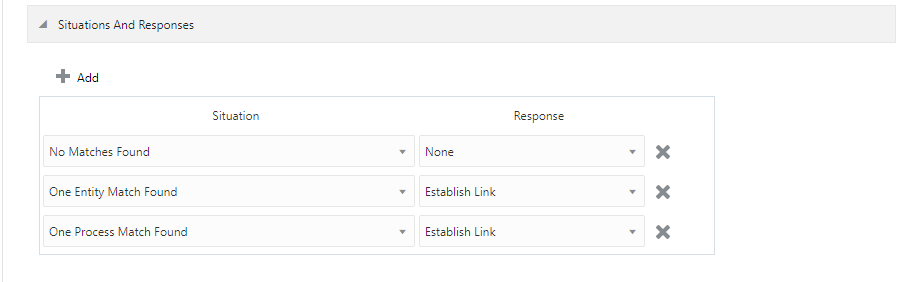

Predefined Situations and Responses
The Oracle Primavera connector provides a default set of situations and responses when you create a target application. These situations and responses specify the action that Oracle Identity Governance must take based on the result of a reconciliation event.
The following lists the default situations and responses for an Oracle Primavera Target application. If required, you can edit these default situations and responses or add new ones. For more information about adding or editing situations and responses, see Updating Situations and Responses Updating Situations and Responses in Oracle Fusion Middleware Performing Self Service Tasks with Oracle Identity Governance
Table 3-6 Predefined Situations and Responses for an Oracle Primavera Target Application
Situation Response
No Matches Found None
One Entity Match Found Establish Link
One Process Match Found Establish Link
The following figure shows the situations and responses for an Oracle Primavera that the connector provides by default.
Figure 3-4 Predefined Situations and Responses for an Oracle Primavera Target Application
