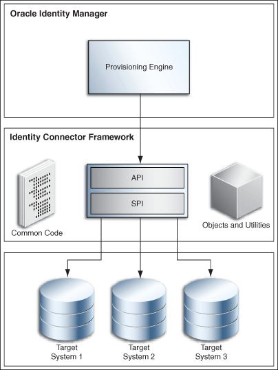

4.2.1 Identity Connector Framework Deployment
The ICF API and SPI are situated between Oracle Identity Manager and the target system.
The API implementation always post-processes the results returned by the SPI Search operation. This double-checks the SPI implementation if the connector bundle does not implement all Filter types, or does not implement them properly for all attributes. If the implementation of Search in the SPI returns every object of the specified type, then the API implementation discards every object that does not match the specified Filter. Post-processing in the API implementation is expensive in terms of processing-time and network-bandwidth, and therefore, it is more efficient if each connector-bundle supports every type of filter (search predicate or logical operator) that the target application can support natively. See the details for Filter Translator in Common Classes.
Figure 4-1 illustrates that the calling application sees only the ICF API. The ICF API dedicates a classloader to each connector bundle, so that the calling application is not exposed to the classes and libraries in the implementation of the connector-bundle (SPI). Bundle classloader also ensures isolation between the bundles as well as making any bundled library available to the connector bundle only, thereby avoiding conflicts between dependencies.
Figure 4-1 Identity Connector Framework Deployment
Description of Figure 4-1 follows
Description of "Figure 4-1 Identity Connector Framework Deployment"

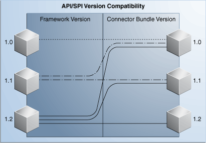

4.2.2 Compatibility Between the ICF and Connector Bundles
Newer versions of the ICF are backward-compatible with existing connector bundle.
Figure 4-2 illustrates the backwards compatibility of the ICF. Newer bundles may be deployed without affecting existing ones. In addition, newer versions of the ICF are generally backward-compatible with existing bundles. Therefore, any connector should work with a new version of framework.
Figure 4-2 Compatibility Between the ICF and Connector Bundles
Description of Figure 4-2 follows
Description of "Figure 4-2 Compatibility Between the ICF and Connector Bundles"

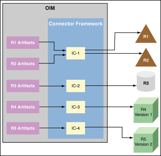

4.2.3 Deployment Methodology to Support Multiple Versions of Same Target
The ICF deployment methodology supports multiple versions of the same target.
Figure 4-3 illustrates deployment methodology of the ICF. Framework supports LCM to clone connector to support multiple versions of the same target. In addition, Framework supports connection pooling.
Figure 4-3 Deployment Methodology to Support Multiple Versions of Same Target
Description of Figure 4-3 follows
Description of "Figure 4-3 Deployment Methodology to Support Multiple Versions of Same Target"

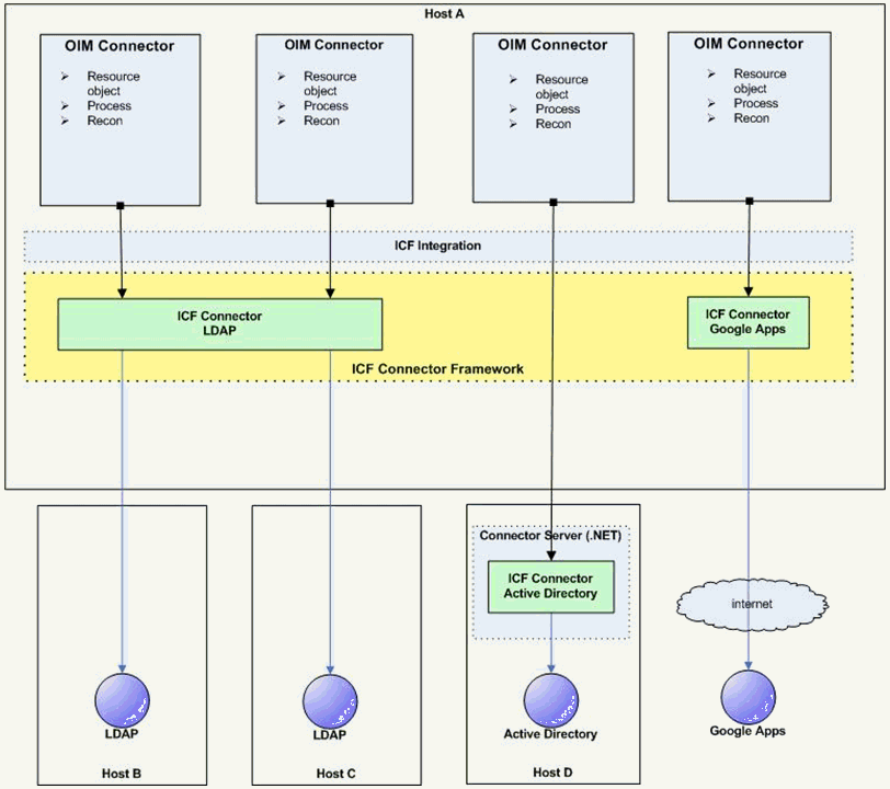

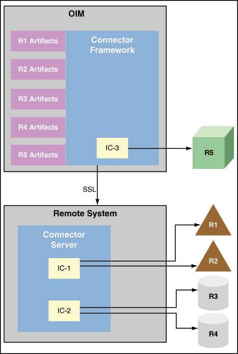

4.2.4 Connector Server Remote System Framework
Connector server remote system framework enables remote execution of connector server using Java or .NET implementation with targets being local or remote to connector bundles.
Figure 4-4 illustrates Framework installed on remote system. This enables remote execution of connector server using Java or .NET implementation with targets being local or remote to connector bundles. This is required when a connector bundle is not directly executed with in an application and ICF allows the application to communicate with externally deployed bundles. In addition, the connector artifacts can be same for local or remote system.
Figure 4-4 Connector Server Remote System Framework
Description of Figure 4-4 follows
Description of "Figure 4-4 Connector Server Remote System Framework"

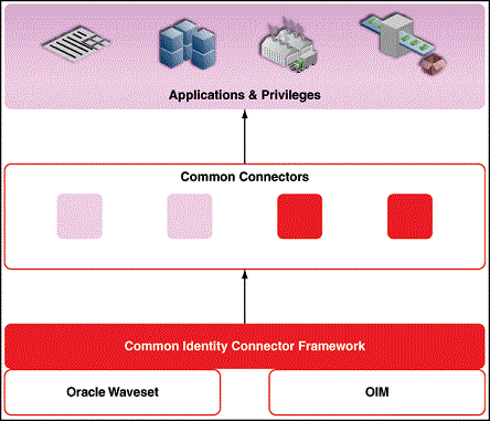

4.2.5 ICF Framework
The ICF Framework enables the convergence of Oracle Identity Manager and Oracle Waveset (OW) connectors to a single connector, best of both.
Figure 4-5 illustrates the ICF Framework.

An identity connector server is required when an identity connector bundle is not directly executed within your application. By using one or more identity connector servers, the ICF architecture permits your application to communicate with externally deployed identity connector bundles.
Identity connector servers are available for Java™ and Microsoft .NET Framework applications. A single connector server can support multiple ICF connectors, and these ICF connectors may be of different connector types. A single ICF connector can be used to communicate with multiple targets.
Figure 4-6 shows how Oracle Identity Manager connectors integrate with resources via ICF connectors:
Figure 4-6 ICF Connectors and Connector Server
Description of Figure 4-6 follows
Description of "Figure 4-6 ICF Connectors and Connector Server"
In Figure 4-6:
  • Oracle Identity Manager connectors do not directly interact with the target resource. Instead, the create, read, update, delete, and query (CRUDQ) operations are performed via the appropriate ICF connector.
  • A single ICF Connector can be used to connect to multiple resources of the same resource type. In Figure 4-6, an ICF Connector for LDAP is used to connect to a local LDAP resource, as well as being used to connect to a remote LDAP resource.
  • The .NET Connector Server is used to deploy .NET ICF Connectors on the target host. An Active Directory resource is connected in this manner.
  • An ICF Connector for Google Apps provides a connection to Google Apps across the Internet.
  • While not shown in the diagram, a Connector Server can support multiple ICF Connectors of different resource types.

A Java Connector Server is used when you do not want to execute a Java Connector Bundle in the same Java Virtual Machine (JVM) as the application.
This deployment may be beneficial in terms of performance as the bundle works faster when deployed on the same host as the managed target system. In addition, use Java Connector Server to eliminate possibility of an application JVM crash because of faulty JNI-based connector.

The use of a .NET Connector Server is useful when an application is written in Java but a Connector Bundle is written using C#.
Because a Java Platform, Enterprise Edition (JEE™) application cannot load C# classes, you can deploy the C# bundles under a .NET Connector Server. The Java application can then communicate with the .NET Connector Server over the network. The .NET Connector Server serves as a proxy to provide any authenticated application access to the C# bundles. The following sections contain additional information:
