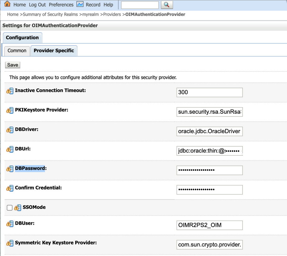

26.1.2.6 Modifying OIMAuthenticationProvider Configuration
To change OIMAuthenticationProvider configuration, on Host A, which is the computer that hosts the freshly configured domain:

26.2.5.6 Changing OIMAuthenticationProvider Configuration
To change OIMAuthenticationProvider configuration:
- In the WebLogic Administrative console, navigate to Security Realms, myrealm, and then Providers.
- Click OIMAuthenticationProvider.
- Click Provider Specific.
- In the DBPassword field, enter the new Oracle Identity Governance database schema password.
- Click Save to save the changes.

26.3.4.4.2 Updating Oracle Identity Governance Authenticators
The existing Oracle Identity Governance authenticators in the WebLogic server are configured against Non-SSL DB details and they do not use datasources for communicating with Oracle Identity Governance DB. In order to use SSL DB details in the authenticators, you must perform the following:
Ensure that Datasources are configured to SSL.
In WebLogic Administrative console, navigate to Security Realms, myrealm, Providers.
Remove OIMAuthenticationProvider.
Create an authentication provider of type "OIMAuthenticator" and mark the control flag as SUFFICIENT.
Create an authentication provider of type "OIMSignatureAuthenticator" and mark the control flag as SUFFICIENT.
Reorder the authenticators as:
DefaultAuthenticator
OIMAuthenticator
Other providers if any
Restart all servers.
