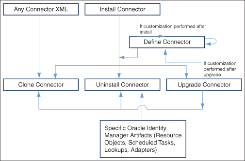

Figure 10-1 depicts the connector lifecycle:

Connector LCM operations such as Upgrade, Clone, and Uninstall needs a source for each connector where all the connector objects reside. The Connector Install stores the Deployment Manager (DM) XML in Oracle Identity Governance database.
Typically, you will install the shipped connector and then perform one or both of the following operations:
Customize the connector by, for example, add/ modify existing object definitions, add additional adapters
(Re) Configure the connector by, for example, changing attribute names and key fields
The DM XML in Oracle Identity Governance database, which will be the reference for all Connector LCM operations need to be updated for customization changes. Oracle Identity Governance provides Define feature to update the DM XML stored in Oracle Identity Governance database with customization changes. Define feature is similar to Export where user need to add all the connector objects related to a specific connector. The end result of defining a connector is an XML file, which will be updated in Oracle Identity Governance database.
At this point, the customized or re-configured connector is not the same as the Oracle-released connector. The connector XML file for the Oracle-released connector might not be valid for the customized or re-configured connector.
In the Advanced Administration page of the Oracle Identity System Administration, you can define a customized or re-configured connector. Defining a connector is equivalent to registering the connector with Oracle Identity Governance.
You must add only those Oracle Identity Governance artifacts that are specific to the connector and do not add default objects or any other connector objects that are shared across connectors. The defined XML is the source for life cycle operations such as upgrade, clone, and uninstall. If an object is used in define and is shared across connectors or a default Oracle Identity Governance object, then there will be un-intended behavior. For example, a Lookup Definition which is there by default in Oracle Identity Governance is added as a part of define, then clone operation will create another copy of the object, which is not required. The uninstall will delete this default object from Oracle Identity Governance as it is defined specific to a connector. Such incorrect definition will have impact on Oracle Identity Governance functionality. Therefore, you must be careful while adding an object while defining a connector.
When you define a connector, a record representing the connector is created in the Oracle Identity Governance database. If this record already exists, then it updates:
The name of the connector. For example,
Microsoft Active Directory. -
The release number of the connector. For example,
9.1.1. -
The connector XML definitions.
You can define the connector XML definitions in the form of an XML file. See the "Exporting Connector Object Definitions in Connector XML Format" section of the connector guide for more information. You can then use this connector XML file to build the installation package for installing the connector on a different Oracle Identity Governance installation.
Oracle recommends defining a connector immediately after customizing the connector or updating the DM XML file with the customization changes.
A connector is automatically defined when you install it using the Install Connectors feature or when you upgrade it using the Upgrade Connectors feature. Therefore, if you install a connector and want to clone it without customizing the connector, then there is no need to define the connector.
You must manually define a connector, otherwise newer version (which basically pertains to entry in CIH table) of connector may not be reflected even though import of new XML was successfully completed. Perform this procedure only if:
You import the connector by using the Deployment Manager.
You customize or reconfigure the connector.
You can continue to use a connector without defining it after you customize or reconfigure a connector or after you upgrade Oracle Identity Governance. However, if you want to upgrade, clone, or uninstall the connector, then you must first define it.
You upgrade Oracle Identity Governance.
It is a custom connector that you develop.

Cloning a connector involves performing a two-step procedure:
Step 1: Create the connector XML file for the cloned connector
Oracle Identity Governance supports two different ways of cloning a connector, Cloning Connector from XML and Cloning Connector from Installed Connectors.
Step 2: Install the clone connector

10.8 Upgrading Connectors
Upgrading connectors involve understanding the uses cases and connector object changes supported by the connector upgrade feature and the impact of upgrading a connector. Connector upgrade procedures include upgrading a connector, post upgrade tasks, and upgrading the 9.x connector version to an ICF connector.
This section describes how to upgrade a connector. It contains the following topics:
10.8.1 About Upgrading Connectors
The Connector Upgrade utility is responsible for upgrading the Oracle Identity Governance artifacts from the source version to the target version. The upgrade operation is performed by retaining the customization performed on the source connector.
Connector upgrade does not handle connector library upgrade/update. Users need to manually upgrade the libraries involved in connector.The following are sample scenarios that describe a need for upgrading a connector:
Reconfiguring or customizing an existing connector
After you install a connector, you might customize or reconfigure it according to your requirements. For example, you might add new attributes for reconciliation and provisioning and modify the scheduled tasks for reconciliation or lookup field synchronization. Ideally, you would make these changes to the connector on a staging server. You would then want to upgrade the connector deployed on your production server to the version that you create by making changes on the staging server.
Upgrading a customer-developed connector
You might have developed your own connector. When an Oracle-released upgrade is available for your connector, you might want to upgrade from your connector to the Oracle-released connector. For example, suppose you have developed and are using a connector for IBM Lotus Notes and Domino. When Oracle ships a new release of Oracle Identity Governance Connector for IBM Lotus Notes and Domino, you might want to use some of the features included in the new release. You can use the Upgrade Connectors feature to upgrade from your connector to the Oracle-released connector.
Upgrading an Oracle-released connector
Oracle ships connector upgrades. An upgrade includes enhancements and fixes that you might need. For example, if you are currently using SAP User Management release 9.1.2, then you might want to upgrade to release 9.1.2.3 of the same connector when that release is available.
In scenarios such as these, you can use the Upgrade Connectors feature to upgrade the connector.
Upgrading connectors can be done by two ways:
Silent mode upgrade: Used in staging and production environments
Wizard mode upgrade: Used in development environment
In this guide, Wizard upgrade, which is performed using Oracle Identity System Administration pages is described.
10.8.2 Upgrade Use Cases Supported by the Connector Upgrade Feature
Typical use cases for connector upgrade include custom-developed source connector, Oracle-released connector that is installed and customized, and cloned connector.
The following types of source connectors are supported by the Upgrade Connectors feature:
Customer-developed connectors
Oracle-released connectors that are not supported by the Install Connectors feature
Oracle-released connectors that are supported by the Install Connectors feature
Oracle-released connectors that are supported by the Install Connectors feature and have been customized
Cloned connectors

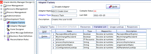

If there are changes in the IT Resource Type Definition Parameter names, you need to update the custom adapters for the parameter changes. To do so:
Log in to Design Console.
Open the custom adapter using the adapter factory.
Go to the variable list and check if there are any variables of type IT Resource, as shown in Figure 10-3:
Figure 10-3 The Variable List Tab of the Adapter Factory Form
Description of "Figure 10-3 The Variable List Tab of the Adapter Factory Form" -

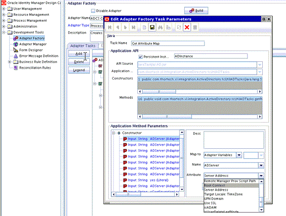

If there is a variable of IT Resource, then go to the task details and change the mapping of the IT Resource parameter mapping to the new target field (if the parameter is changed/deleted).
Figure 10-4 shows the Edit Adapter Factory Task Parameters dialog box that enables you to change the mapping of the IT Resource parameter mapping to the new target field:
Figure 10-4 The Edit Adapter Factory Task Parameters Dialog Box
Description of "Figure 10-4 The Edit Adapter Factory Task Parameters Dialog Box" -

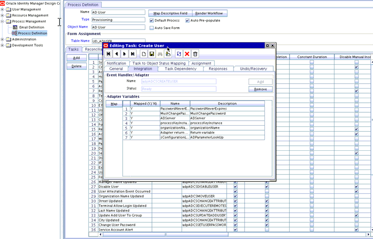

To verify the adapter mappings:
Verify the mapping for process task adapter. To do so, log in to Design Console. Go to Process Definition. Click the task, and then click the Integration tab, as shown in Figure 10-5:
Figure 10-5 The Integration Tab of the Editing Task Dialog Box

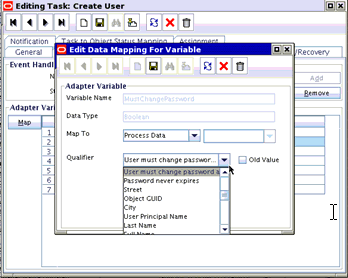

Description of "Figure 10-5 The Integration Tab of the Editing Task Dialog Box"Check if the adapter variable is mapped to the deleted/modified form attribute. If yes, remap such attributes to adapter variables. Repeat this step for all process tasks of all process definitions of the connector.
Figure 10-6 shows the Editing Data Mapping for Variable dialog box that enables you to view and edit the adapter variable mapping to the form attribute:
Figure 10-6 The Editing Data Mapping for Variable Dialog Box
Description of "Figure 10-6 The Editing Data Mapping for Variable Dialog Box" -

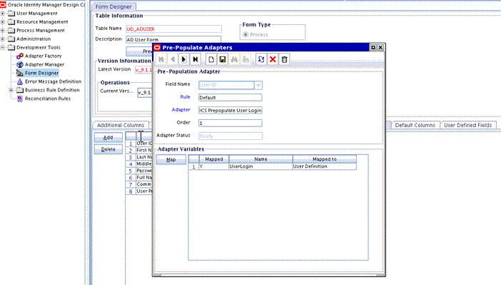

Prepopulate adapter mappings, log in to Design Console. Go to Form Designer, Pre-Populate Adapters, as shown in Figure 10-7:
Figure 10-7 The Pre-Populate Adapters Dialog Box
Description of "Figure 10-7 The Pre-Populate Adapters Dialog Box"Click Map to map adapter variable and check if any of the fields are mapped to the process data attributes. If it is mapped, then verify the process form attribute is not deleted as part of upgrade. If the process form attributes are deleted, then remap them to the correct form attribute data.
Figure 10-8 shows the Map Adapter Variable dialog box:
Figure 10-8 The Map Adapter Variable Dialog Box
Description of "Figure 10-8 The Map Adapter Variable Dialog Box"Note:
Repeat the procedure for all the prepopulated fields of all the process forms of the connector. If there are any entity adapter, then check the adapter variables mapping for these adapters in Data Object Manager.
