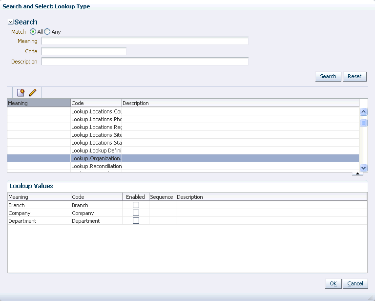

15.1 Searching a Lookup Type
Use the Search and Select: Lookup Type Window to search for lookup types.
To search for a lookup type:

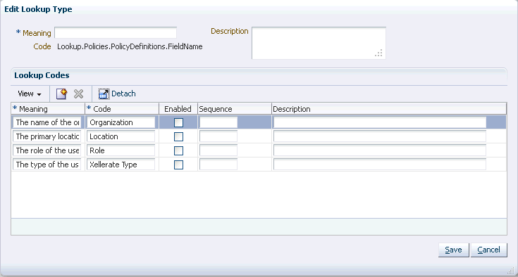

15.3 Modifying a Lookup Type
Use the Edit Lookup Type dialog box to edit an existing lookup type.
To modify a lookup type:
