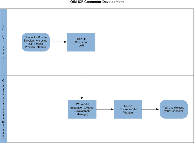

OIM-ICF connector development architecture lets you develop connector bundle using ICF SPI and integrate them with OIM.
Figure 7-1 is the ICF-OIM integration architecture.
Figure 7-1 OIM-ICF Connector Development Architecture
Description of "Figure 7-1 OIM-ICF Connector Development Architecture"

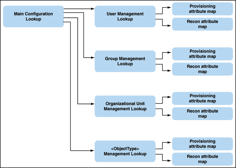

Figure 7-2 illustrates the global Oracle Identity Manager lookups from which most of the Connectors use the User Management Lookups.
Figure 7-2 Oracle Identity Manager Connector Lookup Hierarchy
Description of "Figure 7-2 Oracle Identity Manager Connector Lookup Hierarchy"
7.3.2 Main Lookup Configuration
IT Resource parameter Configuration Lookup points to Main Configuration Lookup, which encapsulates all the Oracle Identity Manager specific configuration information.
Configuration lookup, denoted as Lookup.CONNECTOR_NAME.Configuration, is the top level entry that refers to subordinate lookups for reconciliation and provisioning. The configuration lookup has the structure shown in Table 7-1:

Main Configuration Lookup Lookup.CONNECTOR_NAME.Configuration
Key Value Description objectType Configuration Lookup
Lookup.<ConnectorName>.<objectType>.ProvAttrMap
Group Configuration Lookup
Lookup.LDAP.Group.ProvAttrMap
Example for LDAP Group
Provisioning Lookup Lookup.CONNECTOR_NAME.OBJECT_TYPE.ProvAttrMap
Key Value Description FORM_FIELD_LABEL_ON_THE_PROCESS_FORM
Target system attribute name
Attribute mapping between Oracle Identity Manager and the connector.

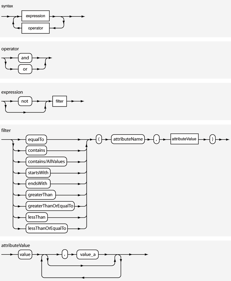

7.8 ICF Filter Syntax
GroovyFilterBuilder allows to create sophisticated filtration expressions in order to speed up/refine scheduled task execution.
WARNING:
The GroovyFilterBuilder uses the connector attribute name for filtration. See Connector documentation for the attribute name.
7.8.1 Filter Examples
Filter examples can include limiting or filtering the number of reconciled accounts.
The following example could limit the number of reconciled accounts to only those, where account name starts with letter "a", this filter is denoted by the following expression:
startsWith('__NAME__', 'a')
Some more advanced search could require to filter only those account names, which end with "z" letter, therefore the filter is:
startsWith('__NAME__', 'a') & endsWith('__NAME__', 'z')
Figure 7-3 shows the graphical scheme of Filter Syntax.
Figure 7-3 Graphical Representation of Filter Syntax
Description of "Figure 7-3 Graphical Representation of Filter Syntax"
It is also possible to use a shortcut for and/or operators.
For example, <filter1> & <filter2> instead of and (<filter1>, <filter2>) , analogically replace or with |.
7.8.2 Definition in EBNF Format
The following is the Extended Backus–Naur Form (EBNF) description of the expression language used for Search Filters in reconciliation.
syntax = expression ( operator expression )*
operator = 'and' | 'or'
expression = ( 'not' )? filter
filter = ('equalTo' | 'contains' | 'containsAllValues' | 'startsWith' | 'endsWith' | 'greaterThan' | 'greaterThanOrEqualTo' | 'lessThan' | 'lessThanOrEqualTo' ) '(' 'attributeName' ',' attributeValue ')'
attributeValue = singleValue | multipleValues
singleValue = 'value'
multipleValues = '[' 'value_1' (',' 'value_n')* ']'
7.8.3 Keywords and Syntax for the Filter Attribute
Filter syntax can be for String filters, Equality or Inequality filters, and Complex filters.
Table 7-15 lists the filter syntax that you can use and the corresponding description and sample values.
