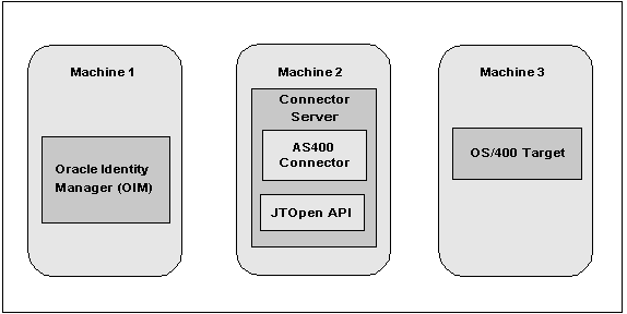

The following figure shows the AS400 connector deployment architecture with the Connector Server.
Figure 2-1 Connector Deployment Architecture With the Connector Server
Description of Figure 2-1 follows
Description of "Figure 2-1 Connector Deployment Architecture With the Connector Server"
  • Machine 1 has Oracle Identity Manager deployed.
  • Machine 2 has the AS400 connector installed in the Connector Server. The Connector Server is part of the Identity Connector Framework (ICF).
    The jt400.jar file from the JTOpen library must be installed in the CONNECTOR_SERVER_HOME/lib directory.
    For detailed installation information, see Installing the Deploying the Connector Bundle in a Connector Server.
  • Machine 3 has the OS/400 target deployed.

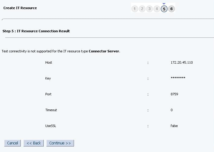

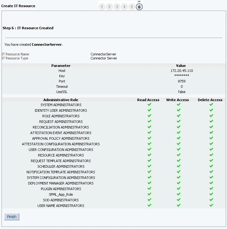

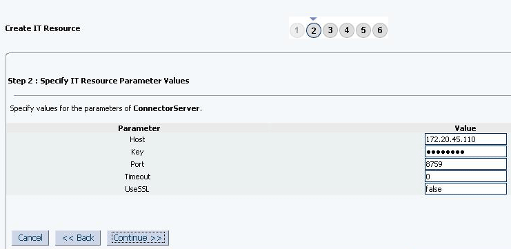

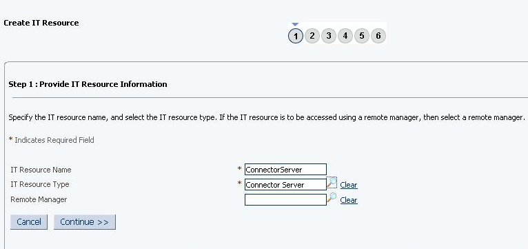

  5. After the Connector Server is running, create a Connector Server IT Resource in Oracle Identity Manager.
  6. Set the "Connector Server Name" parameter on the AS400 Resource to the IT Resource name you created in the previous step.

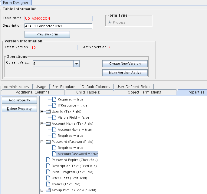

Setting AccountPassword property for Password Change Operations for Oracle Identity Manager 11.1.2.1.0 or Later
In Oracle Identity Manager release 11.1.2.1.0 or later, you can reset password for an account after logging in as the user by navigating to My Access, Accounts tab.
To set the AccountPassword property for Password Change Operations for Oracle Identity Manager release 11.1.2.1.0 or later:
  1. Log in to Oracle Identity System Administration.
  2. In the left pane, under Configuration, click Form Designer.
  3. Enter UD_AS400 in the Table Name field and click the Query for records button.
  4. Click Create New Version.
  5. In the Create a New Version dialog box, specify the version name in the Label field, save the changes, and then close the dialog box.
  6. From the Current Version list, select the newly created version.
  7. Click the Properties tab.
  8. Select the password field, and click Add Property.
  9. From the Property Name list, select AccountPassword.
  10. In the Property Value field, enter true.
  11. Click Save.
    The password field is tagged with the AccountPassword = true property as shown in the following screenshot:
    This screenshot displays the Form Designed tab.
  12. Click Make Version Active.
  13. Update the application instance with the new form as described in Updating an Existing Application Instance with a New Form.

  4. On the Step 1: Provide IT Resource Information page, perform the following steps:
    • IT Resource Name: Enter a name for the IT resource.
    • IT Resource Type: Select Connector Server from the IT Resource Type list.
    • Remote Manager: Do not enter a value in this field.
  5. Click Continue. Figure 2-2 shows the IT resource values added on the Create IT Resource page.
    Figure 2-2 Step 1: Provide IT Resource Information

  6. On the Step 2: Specify IT Resource Parameter Values page, specify values for the parameters of the IT resource and then click Continue. Figure 2-3 shows the Step 2: Specify IT Resource Parameter Values page.
    Figure 2-3 Step 2: Specify IT Resource Parameter Values
    Description of Figure 2-3 follows
    Description of "Figure 2-3 Step 2: Specify IT Resource Parameter Values"

  13. The Step 5: IT Resource Connection Result page displays the results of a connectivity test that is run using the IT resource information. If the test is successful, then click Continue. If the test fails, then you can perform one of the following steps:
  14. Click Finish. Figure 2-7 shows the IT Resource Created Page.
    Figure 2-7 Step 6: IT Resource Created
    Description of Figure 2-7 follows
    Description of "Figure 2-7 Step 6: IT Resource Created"
IT Resource Parameters
Table 2-5 provides information about the parameters of the IT resource.
Table 2-5 Parameters of the IT Resource for the Connector Server
Parameter Description
Host
Enter the host name or IP address of the computer hosting the connector server.
Sample value: RManager
Key
Enter the key for the Java connector server.
Port
Enter the number of the port at which the connector server is listening.
Default value: 8759
Timeout
Enter an integer value which specifies the number of milliseconds after which the connection between the connector server and Oracle Identity Manager times out.
Sample value: 300
UseSSL
Enter true to specify that you will configure SSL between Oracle Identity Manager and the Connector Server. Otherwise, enter false.
Default value: false
Note: It is recommended that you configure SSL to secure communication with the connector server. To configure SSL, run the connector server by using the /setKey [key] option. The value of this key must be specified as the value of the Key IT resource parameter of the connector server.
