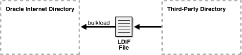

Migrating LDAP Data Using LDIF File and Bulk Loader
To use this method, you must first export data from the third-party directory to an LDIF file.
See Figure 38-1.
Figure 38-1 Using an LDIF File and Bulk Loader
Described in text.
To migrate data to Oracle Internet Directory using an LDIF file and bulk loader:

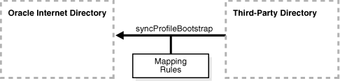

Migrating LDAP Data Using Directory Integration Assistant Directly
The syncProfileBootstrap operation can take data either directly from a third-party LDAP-compliant directory or from an LDIF file, tagged file, or CSV file. You must provide mapping rules, either as a synchronization profile or in a configuration file.
For syncProfileBootstrap syntax information, configuration file properties, information about input file types, and examples, see Oracle Directory Integration Platform Tools in Reference for Oracle Identity Management and Directory Bootstrapping Using syncProfileBootstrap in Administering Oracle Directory Integration Platform.
If you must perform mapping when migrating the data from the third-party directory to Oracle Internet Directory, and if the data is small in size, you can use syncProfileBootstrap. As shown in Figure 38-2, you can use the third-party directory itself as input to syncProfileBootstrap.
Figure 38-2 Using syncProfileBootstrap Directly
Using dipassistant Directly

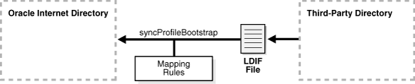

Migrating LDAP Data Using LDIF File and Directory Integration Assistant
If you do not have direct access to the third-party directory, you can have the administrator export the data to an LDIF file.
SeeFigure 38-3, syncProfileBootstrap can take its input from an LDIF file. You could also use Oracle directory integration server to migrate the data.
Figure 38-3 Using an LDIF File and syncProfileBootstrap
Described in text.

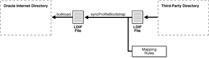

Migrating LDAP Data Using Directory Integration Assistant, Bulk Loader, and LDIF Files
If you have a large amount of data and you must perform mapping on the data, you can use a combination of tools.
See Figure 38-4, you can export the data from the third-party directory to an LDIF file, then use syncProfileBootstrap to perform the mapping into another LDIF file, which you then load with bulkload.
Figure 38-4 Using syncProfileBootstrap, bulkload, and LDIF Files
Described in text.
