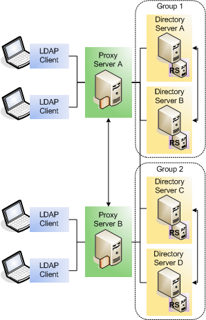

6.3.1.1 About Topology with the Replication Servers and Directory Servers on the Same Host
In this topology, the directory servers and replication servers are installed on the same host.
If a single host contains both a replication server and a directory server, and those servers are associated with the same ORACLE_HOME directory, the servers are stopped and upgraded at the same time.
In the following figure, Group 1 and Group 2 refer to configured replication groups. For more information about replication groups, see About Replication Groups in Administering Oracle Unified Directory.
Figure 6-1 Replicated Topology with Proxy Servers - RS and DS on the Same Host
6.3.1.2 Upgrading a Topology with the Replication Servers and Directory Servers on the Same Host
To upgrade a topology with the directory servers and replication servers installed on the same host:

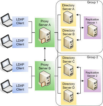

6.3.1.3 About Topology with Replication Servers and Directory Servers on Different Hosts
In this topology, the directory servers and replication servers are installed on different hosts. In the following figure, Group 1 and Group 2 refer to configured replication groups. For more information about replication groups, see About Replication Groups in Administering Oracle Unified Directory.

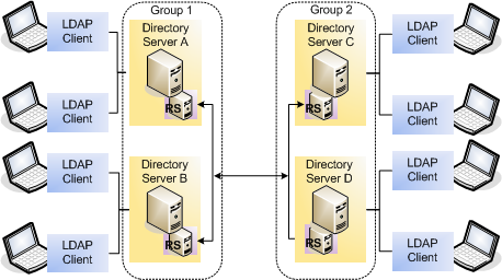

6.3.2 Upgrading a Topology That Does Not Include a Proxy Server
In a topology that does not include any proxy server instances, you must upgrade your client applications so that they point to an alternative directory server each time you take a directory server down for an upgrade.
The following diagram shows a replicated topology that does not include a proxy server. This topology assumes that the directory servers and replication servers are installed on the same ORACLE_HOME directory.
In this diagram, Group 1 and Group 2 refer to configured replication groups. See About Replication Groups in Administering Oracle Unified Directory.
Figure 6-3 Replicated Oracle Unified Directory Topology Without Proxy Servers
To upgrade a topology that does not include a proxy server:
