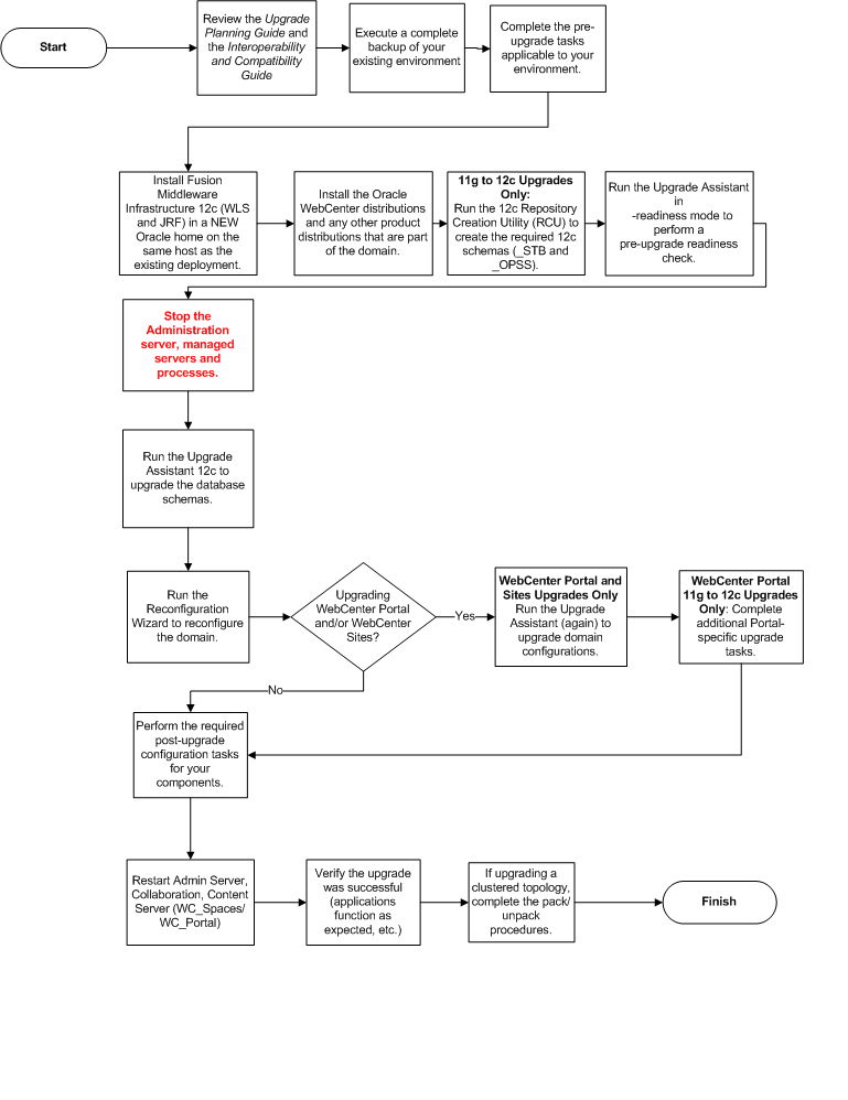

About the Oracle WebCenter Upgrade Process to 12c (12.2.1.3.0)
Review the process flow for upgrading WebCenter products to 12c to get a better understanding of the procedures you will perform and when you will preform them.
This process flow shows the high-level procedures for upgrading a WebCenter domain to 12c (12.2.1.3.0). The actual procedures you will perform depends on your pre-upgrade environment and the components you will be upgrading.
Figure 3-1 Upgrading Oracle WebCenter to 12c (12.2.1.3.0)
Description of Figure 3-1 follows
Description of "Figure 3-1 Upgrading Oracle WebCenter to 12c (12.2.1.3.0)"
Task Description
Required
Complete all of the Oracle Fusion Middleware standard pre-upgrade tasks, as well as any additional component-specific tasks you may be required to perform.
Pre-Upgrade Tasks for Oracle WebCenter Components
Required
Install the product distributions for all the products that are part of the domain.
Note that in 12c, the WebLogic Server and JRF are part of the Infrastructure distribution and must be installed first.
The binaries should be installed into a new Oracle home on the same host as the existing deployment.
For 11g to 12c Upgrade Only:
Run the 12c Repository Creation Utility (RCU) to create the required 12c schemas (_STB and _OPSS).
The Service Table (_STB) schema is required in 12c.
The OPSS (_OPSS) schema is required if an OID-based policy store was used in 11g.
If you are upgrading from a previous 12c release, then you will already have these schemas in your repository.
Optional
Run a pre-upgrade readiness check with the Upgrade Assistant.
When run in -readiness mode, the Upgrade Assistant performs a read-only check to determine if there might be problems in the starting point environment that would prevent a successful upgrade.
The checks vary by component and a complete report is generated to help troubleshoot any potential issues.
Required
Stop the Administration Server, Managed Servers and any other running applications in your existing deployment.
Failure to shut down the existing environment during the upgrade can corrupt your schemas and/or component configurations.
Required
Run the Upgrade Assistant to upgrade individually selected schemas or all schemas used by the domain.
Oracle recommends that you allow the Upgrade Assistant to upgrade all schemas within the selected domain whenever possible.
Required
Run the Reconfiguration Wizard to reconfigure the domain. The Reconfiguration Wizard is a new tool in Oracle Fusion Middleware 12c.
WebCenter Portal and Sites Users Only: Run the Upgrade Assistant (again) to upgrade any remaining component configurations.
WebCenter Content Users Only: You will not run the Upgrade Assistant as the necessary configuration changes are performed automatically at server startup (post upgrade) without user intervention.
Upgrading Domain Component Configurations
WebCenter Portal Users Only: You must complete a set of additional procedures to upgrade Oracle WebCenter Portal to 12c.
Upgrading Oracle WebCenter Portal 11g Installations
Required
Complete all of the required post-upgrade tasks described in your component-specific documentation.
Some components will not work correctly if these tasks are not performed after the upgrade.
Performing Post-Upgrade Configuration Tasks
Required
Restart the administration server and the managed servers.
Required
Verify the upgrade was successful (applications function as expected, etc.)
Verifying the New Applications Work as Expected
Optional
Upgrade WebCenter for a cluster topology, if applicable
Upgrading WebCenter in a Clustered Topology

You can ignore the missing index error in the readiness report. This is a known issue. The corresponding missing index is added during the schema upgrade operation. This error does not occur if the schema to be upgraded was created in 12c using the RCU.
Stopping Servers and Processes
Before you run the Upgrade Assistant to upgrade your schemas and configurations, you must shut down all of the pre-upgrade processes and servers, including the Administration Server and any managed servers.
An Oracle Fusion Middleware environment can consist of an Oracle WebLogic Server domain, an Administration Server, multiple managed servers, Java components, system components such as Identity Management components, and a database used as a repository for metadata. The components may be dependent on each other, so they must be stopped in the correct order.
The procedures in this section describe how to stop the existing, pre-upgrade servers and processes using the WLST command-line utility or a script. You can also use the Oracle Fusion Middleware Control and the Oracle WebLogic Server Administration Console. See Starting and Stopping Administration and Managed Servers and Node Manager.
To stop your pre-upgrade Fusion Middleware environment, navigate to the pre-upgrade domain and follow the steps below:
Step 1: Stop System Components
To stop system components, such as Oracle HTTP Server, use the stopComponent script:
  • (UNIX) EXISTING_DOMAIN_HOME/bin/stopComponent.sh component_name
  • (Windows) EXISTING_DOMAIN_HOME\bin\stopComponent.cmd component_name
You can stop system components in any order.
Step 2: Stop the Managed Servers
To stop a WebLogic Server Managed Server, use the stopManagedWebLogic script:
  • (UNIX) EXISTING_DOMAIN_HOME/bin/stopManagedWebLogic.sh managed_server_name admin_url
  • (Windows) EXISTING_DOMAIN_HOME\bin\stopManagedWebLogic.cmd managed_server_name admin_url
When prompted, enter your user name and password.
Step 3: Stop Oracle Identity Management Components
Stop any Oracle Identity Management components, such as Oracle Internet Directory:
Step 4: Stop the Administration Server
When you stop the Administration Server, you also stop the processes running in the Administration Server, including the WebLogic Server Administration Console and Fusion Middleware Control.
To stop the Administration Server, use the stopWebLogic script:
  • (UNIX) EXISTING_DOMAIN_HOME/bin/stopWebLogic.sh
  • (Windows) EXISTING_DOMAIN_HOME\bin\stopWebLogic.cmd
When prompted, enter your user name, password, and the URL of the Administration Server.
Step 5: Stop Node Manager
To stop Node Manager, close the command shell in which it is running.
Alternatively, after setting the nodemanager.properties attribute QuitEnabled to true (the default is false), you can use WLST to connect to Node Manager and shut it down. See stopNodeManager in WLST Command Reference for WebLogic Server.
Upgrading Product Schemas
After stopping servers and processes, use the Upgrade Assistant to upgrade supported product schemas to the current release of Oracle Fusion Middleware.
The Upgrade Assistant allows you to upgrade individually selected schemas or all schemas associated with a domain. The option you select determines which Upgrade Assistant screens you will use.
Identifying Existing Schemas Available for Upgrade

Starting the Upgrade Assistant
Run the Upgrade Assistant to upgrade product schemas, domain component configurations, or standalone system components to 12c (12.2.1.3.0). Oracle recommends that you run the Upgrade Assistant as a non-SYSDBA user, completing the upgrade for one domain at a time.
To start the Upgrade Assistant:
Before you start the Upgrade Assistant, make sure that the JVM character encoding is set to UTF-8 for the platform on which the Upgrade Assistant is running. If the character encoding is not set to UTF-8, then you will not be able to download files containing Unicode characters in their names. This can cause the upgrade to fail.
  1. Go to the oracle_common/upgrade/bin directory:
    • (UNIX) NEW_ORACLE_HOME/oracle_common/upgrade/bin
    • (Windows) NEW_ORACLE_HOME\oracle_common\upgrade\bin
  2. Start the Upgrade Assistant:
    • (UNIX) ./ua
    • (Windows) ua.bat

Upgrading Oracle WebCenter Schemas Using the Upgrade Assistant
Navigate through the screens in the Upgrade Assistant to upgrade the product schemas.
To upgrade product schemas with the Upgrade Assistant:
  1. On the Welcome screen, review an introduction to the Upgrade Assistant and information about important pre-upgrade tasks. Click Next.
    For more information about any Upgrade Assistant screen, click Help on the screen.
  2. On the Selected Schemas screen, select the schema upgrade operation that you want to perform:
    • Individually Selected Schemas if you want to select individual schemas for upgrade and you do not want to upgrade all of the schemas used by the domain.
      Caution:
      Upgrade only those schemas that are used to support your 12c (12.2.1.3.0) components. Do not upgrade schemas that are currently being used to support components that are not included in Oracle Fusion Middleware 12c (12.2.1.3.0).
    • All Schemas Used by a Domain to allow the Upgrade Assistant to discover and select all components that have a schema available to upgrade in the domain specified in the Domain Directory field. This is also known as a domain assisted schema upgrade. Additionally, the Upgrade Assistant pre-populates connection information on the schema input screens.
      Oracle recommends that you select All Schemas Used by a Domain for most upgrades to ensure all of the required schemas are included in the upgrade.
    Click Next.
  3. If you selected Individually Selected Schemas: On the Available Components screen, select the components for which you want to upgrade schemas. When you select a component, the schemas and any dependencies are automatically selected.
  4. On the Prerequisites screen, acknowledge that the prerequisites have been met by selecting all the check boxes. Click Next.
    The Upgrade Assistant does not verify whether the prerequisites have been met.
  5. On the Schema Credentials screen(s), specify the database connection details for each schema you are upgrading (the screen name changes based on the schema selected):
    • Select the database type from the Database Type drop-down menu.
    • Enter the database connection details, and click Connect.
    • Select the schema you want to upgrade from the Schema User Name drop-down menu, and then enter the password for the schema. Be sure to use the correct schema prefix for the schemas you are upgrading.
      The component ID or schema name is changed for UCSUMS schema as of release 12.1.2, which means the Upgrade Assistant does not automatically recognize the possible schemas and display them in a drop-down list. You must manually enter the name in a text field. The name can be either prefix_ORASDPM or prefix_UMS, depending on the starting point for the upgrade.
      11g to 12c Upgrades Only: The UCSUMS schema is not auto-populated. Enter prefix_ORASDPM as the user. The upgrade environment uses _ORASDPM as the schema name, whereas in the 12c environment it is referred to as _UMS.
  6. On the Examine screen, review the status of the Upgrade Assistant as it examines each schema, verifying that the schema is ready for upgrade. If the status is Examine finished, click Next.
    If the examine phase fails, Oracle recommends that you cancel the upgrade by clicking No in the Examination Failure dialog. Click View Log to see what caused the error and refer to Troubleshooting Your Upgrade in Upgrading with the Upgrade Assistant for information on resolving common upgrade errors.
    • If you resolve any issues detected during the examine phase without proceeding with the upgrade, you can start the Upgrade Assistant again without restoring from backup. However, if you proceed by clicking Yes in the Examination Failure dialog box, you need to restore your pre-upgrade environment from backup before starting the Upgrade Assistant again.
    • Canceling the examination process has no effect on the schemas or configuration data; the only consequence is that the information the Upgrade Assistant has collected must be collected again in a future upgrade session.
  7. On the Upgrade Summary screen, review the summary of the schemas that will be upgraded and/or created.
    Verify that the correct Source and Target Versions are listed for each schema you intend to upgrade.
    If you want to save these options to a response file to run the Upgrade Assistant again later in response (or silent) mode, click Save Response File and provide the location and name of the response file. A silent upgrade performs exactly the same function that the Upgrade Assistant performs, but you do not have to manually enter the data again.
    Click Next .
  8. On the Upgrade Progress screen, monitor the status of the upgrade.
    Caution:
    Allow the Upgrade Assistant enough time to perform the upgrade. Do not cancel the upgrade operation unless absolutely necessary. Doing so may result in an unstable environment.
    If any schemas are not upgraded successfully, refer to the Upgrade Assistant log files for more information.
    The progress bar on this screen displays the progress of the current upgrade procedure. It does not indicate the time remaining for the upgrade.
    Click Next.
  9. If the upgrade is successful: On the Upgrade Success screen, click Close to complete the upgrade and close the wizard.
    If the upgrade fails: On the Upgrade Failure screen, click View Log to view and troubleshoot the errors. The logs are available at NEW_ORACLE_HOME/oracle_common/upgrade/logs.
    If the upgrade fails, you must restore your pre-upgrade environment from backup, fix the issues, then restart the Upgrade Assistant.
Verifying the Schema Upgrade
After completing all the upgrade steps, verify that the upgrade was successful by checking that the schema version in schema_version_registry has been properly updated.
If you are using an Oracle database, connect to the database as a user having Oracle DBA privileges, and run the following from SQL*Plus to get the current version numbers:
SET LINE 120
COLUMN MRC_NAME FORMAT A14
COLUMN COMP_ID FORMAT A20
COLUMN VERSION FORMAT A12
COLUMN STATUS FORMAT A9
COLUMN UPGRADED FORMAT A8
SELECT MRC_NAME, COMP_ID, OWNER, VERSION, STATUS, UPGRADED FROM SCHEMA_VERSION_REGISTRY ORDER BY MRC_NAME, COMP_ID ;
In the query result:
  • Check that the number in the VERSION column matches the latest version number for that schema. For example, verify that the schema version number is 12.2.1.3.0.
    However, that not all schema versions will be updated. Some schemas do not require an upgrade to this release and will retain their pre-upgrade version number.
  • The STATUS field will be either UPGRADING or UPGRADED during the schema patching operation, and will become VALID when the operation is completed.
  • If the status appears as INVALID, the schema update failed. You should examine the logs files to determine the reason for the failure.
  • Synonym objects owned by IAU_APPEND and IAU_VIEWER will appear as INVALID, but that does not indicate a failure.
    They become invalid because the target object changes after the creation of the synonym. The synonyms objects will become valid when they are accessed. You can safely ignore these INVALID objects.
