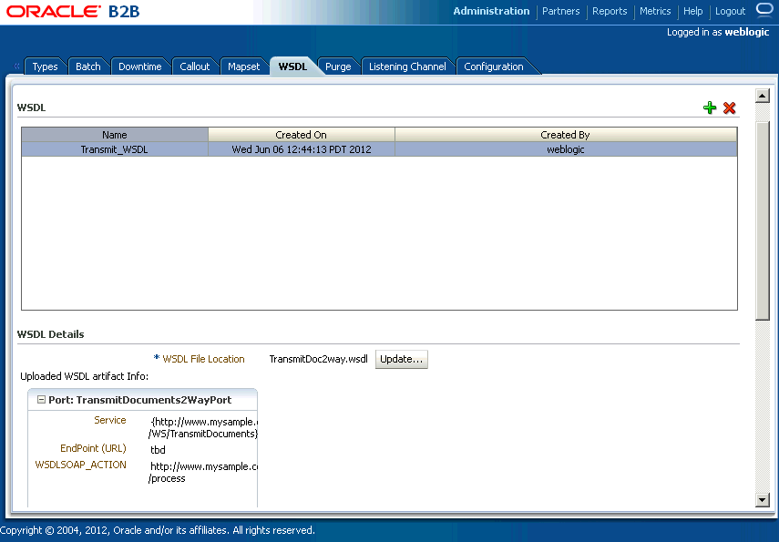

Uploading the WSDL
As the first task, you need to upload the WSDL file that is required to register a Web service to exchange messages. You can upload the WSDL in the either of the following ways:
Inline WSDL - a normal WSDL file where the XSD information is defined within the WSDL itself
A ZIP file containing a WSDL file and an XSD file
A ZIP file containing multiple WSDL and XSD files
To upload a WSDL:
Log on to the Oracle B2B console (http://<hostname>:<port>/b2bconsole), where hostname is the name of the computer where Oracle SOA Suite is hosted and port is typically
8001(in the case of a non-SSL connection). -
Click the Administration link and then click the WSDL tab.
Click the + button (Add WSDL). An entry for the new WSDL gets created in the WSDL table.
Specify a name for the WSDL such as Transmit_WSDL. In case of multiple WSDLs that have been zipped and uploaded, the start WSDL or the root WSDL has to be selected.
In the WSDL section, click the Browse button to select the WSDL to be uploaded. For this example, the WSDL selected is TransmitDoc2way.wsdl. You can see the details of the WSDL is listed under the Uploaded WSDL artifact Info section as shown in Figure 21-1.
Click Save and then click OK in the confirmation dialog.
After the uploaded WSDL file is referenced by any other metadata such as channels and they are deployed as a part of agreements, any update to the WSDL is disabled. After these references are inactivated, only then you can update the uploaded WSDL.

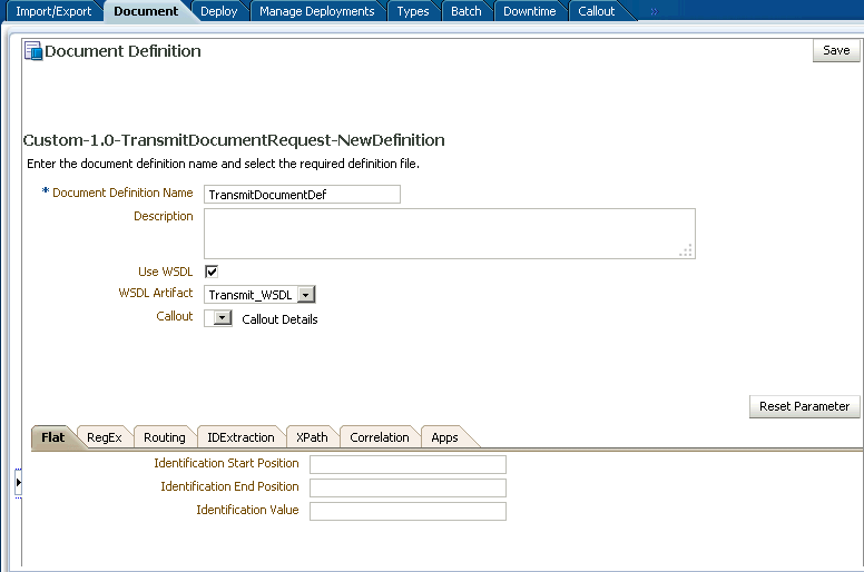

Creating a document
The next task is to create a document for the outbound flow. Please note that currently, the only supported document type is custom.
To create a custom document:
Create document definitions as specified in Creating Document Definitions. Specify:
Document Version - 1.0
Document Type - TransmitDocumentRequest
Document Definition - TransmitDocumentDef
Select Use WSDL.
Select the relevant WSDL Artifact, which in this case is Transmit_WSDL.
Select the required WSDL Message, which in this case is the TransmitDocumentsRequestMessage as shown in Figure 21-2.
Select any required callout from the Callout list.
Click Save.

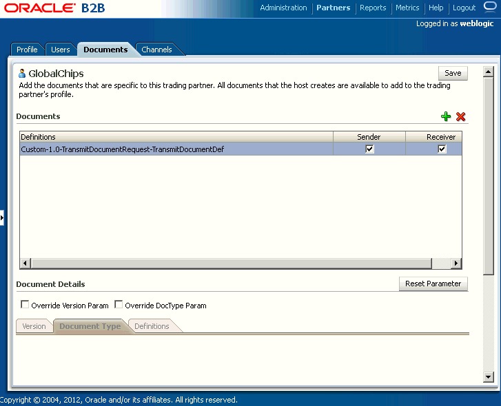

Adding the document to as a part of partner documents
The third task is to add the newly created custom document as a part of the Partner documents.
To add the document:
Click the Partners link and then click the Documents tab.
Click to select the remote trading partner name (GlobalChips) under the partner section.
Under the Documents section on the right-hand pane, click the + button (Add Document Definition) to display the Select Document Definition window.
Navigate to the required document definition and click Add to add the document definition.
Click Save in the Documents tab.
The document gets added to the list of partner documents as shown in Figure 21-3.

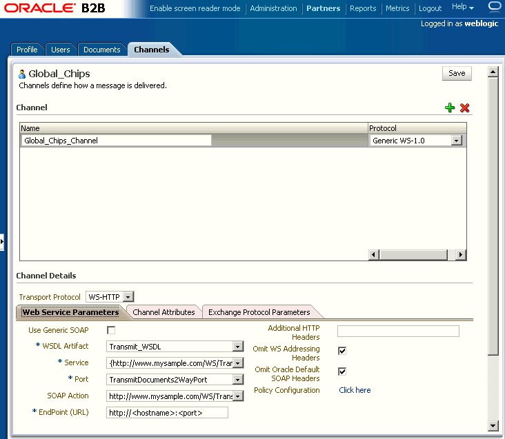

Creating a Trading Partner Delivery Channel
After adding the documents, you need to create a trading partner delivery channel to send messages.
To add a trading partner delivery channel:
Click to select the trading partner (GlobalChips) under Partner on the left.
Click the Channels tab.
Click the + (Add Channel to Trading Partner) button.
In the Channel section, specify a name for the channel (such as GlobalChips_Channel).
Select Generic WS-1.0 from the Protocol list.
In the Channel details section, in the Web Service Parameters tab:
Select Transmit_WSDL, the WSDL that you uploaded from WSDL Artifact from the WSDL Artifact list.
Select the available service (TransmitsDocumentService in this case).
Oracle B2B allows you to specify services, ports, and actions manually. This is useful when you want to specify additional service, port, or action beyond and over what is available as part of the selected WSDL. You can also provide string values for the preceding parameters manually. In the case of manually providing the service name, it should be in the following format, else there would be a validation error:
{namespace}ServiceName
The namespace must match the target namespace of the WSDL, else, the Security Policy Configuration will not be applied.
Select the available port (TransmitDocuments2WayPort).
Select the SOAP action (available from the WSDL).
Enter the URL where the server is listening as the Endpoint (URL), which is the URL of the GlobalChips trading partner.
Enter any additional HTTP headers, if required.
Select Omit WS Addressing Headers if you want to discard WS Addressing headers as a part of the message to be exchanged.
Select Omit Oracle Default SOAP Headers if you do not want Oracle B2B Web services outbound channel to send the default SOAP headers such as From, To, Doctype, and DocRevision as a part of the message.

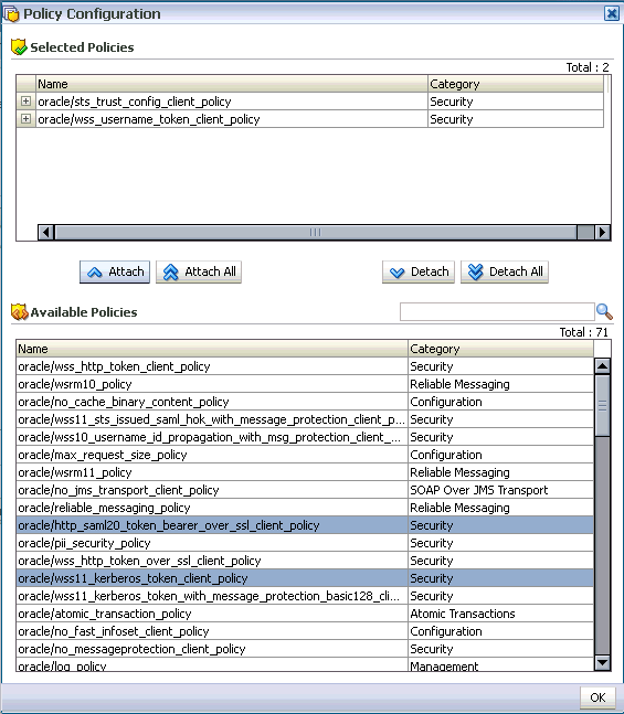

Click the Policy Configuration Click here link to display the Policy Configuration window. The policy Configuration window lists all the available Web services security policies that you can attach to the channel locally. Attaching a policy locally to a channel provides granular control over the security of the channel as opposed to setting global policies at the Oracle Fusion Middleware Enterprise Manager Control console level.
In the Policy Configuration window, from the list of available Web services policies under Available Policies, select the policy that you want to attach to the channel. You can select multiple policies by pressing the Control key and clicking the policy names.
Click Attach to attach the selected policy or policies to the channel. You can click the Attach All button to attach all the available policies to the channel and click OK as shown in Figure 21-4.
Figure 21-4 Attaching Web Services Policies
Description of "Figure 21-4 Attaching Web Services Policies"Note:
Some policies are contradictory to each other. If you try to attach such contradictory policies together to an endpoint, you will get an error.
For more information, see Overview of Global Policy Attachments Using Policy Sets in Understanding Oracle Web Services Manager.
You can also set the parameters, such as Additional SOAP Headers and Payload XPath in the Exchange Protocol Parameters tab.
Select the Additional SOAP Headers option to specify any additional SOAP headers that you want to pass along with the message. The Payload XPath option helps to select the payload based on the XPath; rest of the SOAP body is ignored.
Click Save as shown in Figure 21-5.
Click Attach to attach the selected policy or policies to the channel. You can click the Attach All button to attach all the available policies to the channel and click OK.

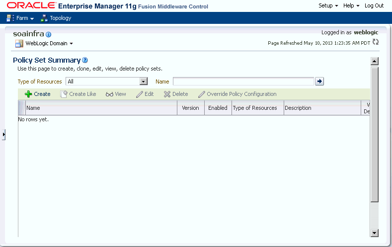

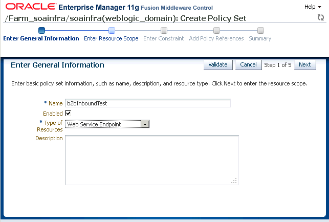

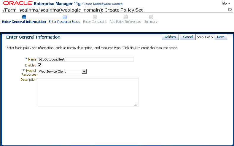

This section discusses how to attach policy sets to Web services by using the Oracle Fusion Middleware Enterprise Management Control console.
To create the UserName token policy and required credentials, you need to perform the following tasks:

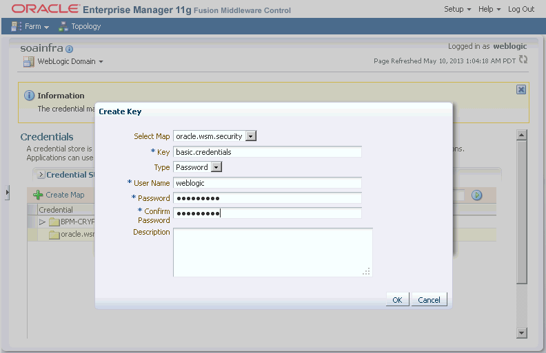

Creating Default Credentials Map and Key
The first task is to create credentials.
To create credentials:
Log on to Oracle Fusion Middleware Enterprise Management Control console by accessing the following URL:
http://<hostname>:<port>/em
Where:
hostname: The name of the computer running the Oracle SOA Suite
port: The port number of the Admin server; typically
7001.

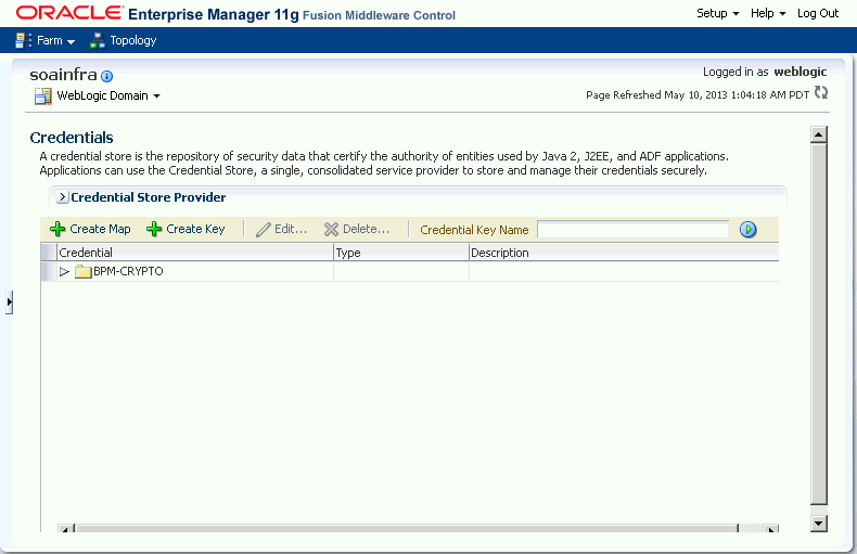

Expand the domain name, such as soainfra, under Weblogic Domain in the Target Navigation pane.
Right-click soainfra, and select Security > Credentials to display the Credentials page as displayed in Figure 21-6.
Figure 21-6 Accessing the Credentials Page
Description of "Figure 21-6 Accessing the Credentials Page" -

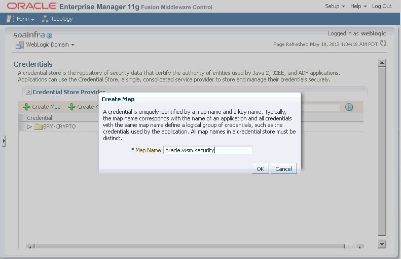

In the Credentials page, click Create Map.
In the Create Map dialog box, enter
oracle.wsm.securityas the map name as displayed in Figure 21-7 and click OK. -
Select oracle.wsm.security (the map that you created) and click Create Key to display the Create Key dialog box.
In the Create Key dialog box, do the following as displayed in Figure 21-8:
Enter the key name as basic.credentials in the Key field.
Select Password as Type.
Enter the Admin user name, which in this case is
weblogic. -
Enter a password in the Password field.
Confirm the password that you have entered in the last step.

To create an outbound policy set and attach it to Web services:
Click the Weblogic Domain list on the domain name (soainfra) page and select Web Services > Policy Sets to display the Policy Set Summary page as displayed in Figure 21-9.
In the Policy Set Summary page, click Create to display the Create Policy Set wizard.
Enter the name as
b2bOutboundTest, select Enabled, select Web Service Client from the Type of Resources list, and click Next as displayed in Figure 21-10.Figure 21-10 Create Policy Set - Enter General Information Page
Description of "Figure 21-10 Create Policy Set - Enter General Information Page" -

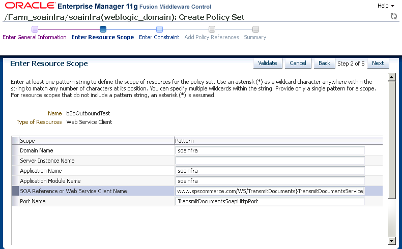

In the Enter Resource Scope page, enter the following as displayed in Figure 21-11 and click Next:
The domain name, such as
soainfra -
The application name, such as
soainfra -
The application module name, such as
soainfra -
The SOA reference, such as
{http://xmlns.example.com/soa/generic/soap}test -
The port name, such as
TransmitDocumentsSoapHttpPort
Figure 21-11 Create Policy Set - Enter Resource Scope Page
Description of "Figure 21-11 Create Policy Set - Enter Resource Scope Page" -

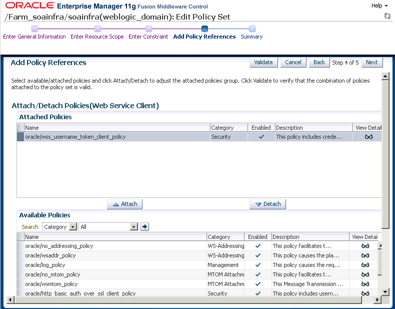

In the Add Policy References page, select the oracle/wss_username_token_client_policy from the Available Policies section, click Attach as displayed in Figure 21-12, and then click Next.
Figure 21-12 Create Policy Set - Add Policy References Page
Description of "Figure 21-12 Create Policy Set - Add Policy References Page" -
In the Summary page, click Save to return to the Policy Set Summary page.

To create an inbound policy set and attach it to Web services:
Repeat steps 1 and 2 from Creating and attaching outbound policy sets.
Enter the name as
b2bIutboundTest, select Enabled, select Web Service Endpoint from the Type of Resources list, and click Next as displayed in Figure 21-13.Figure 21-13 Create Policy Set - Enter General Information Page
Description of "Figure 21-13 Create Policy Set - Enter General Information Page" -

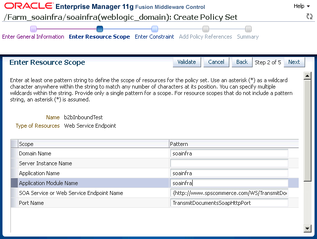

In the Enter Resource Scope page, enter the following as displayed in Figure 21-14 and click Next:
soainfra -
soainfra -
soainfra -
The SOA reference or Web service client name, such as
{http://www.spscommerce.com/WS/TransmitDocuments}TransmitDocumentsService -
Figure 21-14 Create Policy Set - Enter Resource Scope Page
Description of "Figure 21-14 Create Policy Set - Enter Resource Scope Page" -
