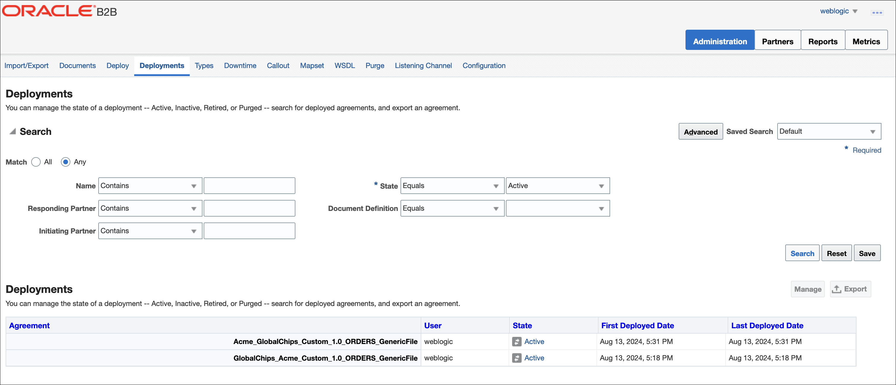

Figure 9-1 shows the Manage Deployment tab.

Searching for Deployed Agreements
You can search for deployed agreements using search parameters.
The search parameters aredescribed in Table 9-3.

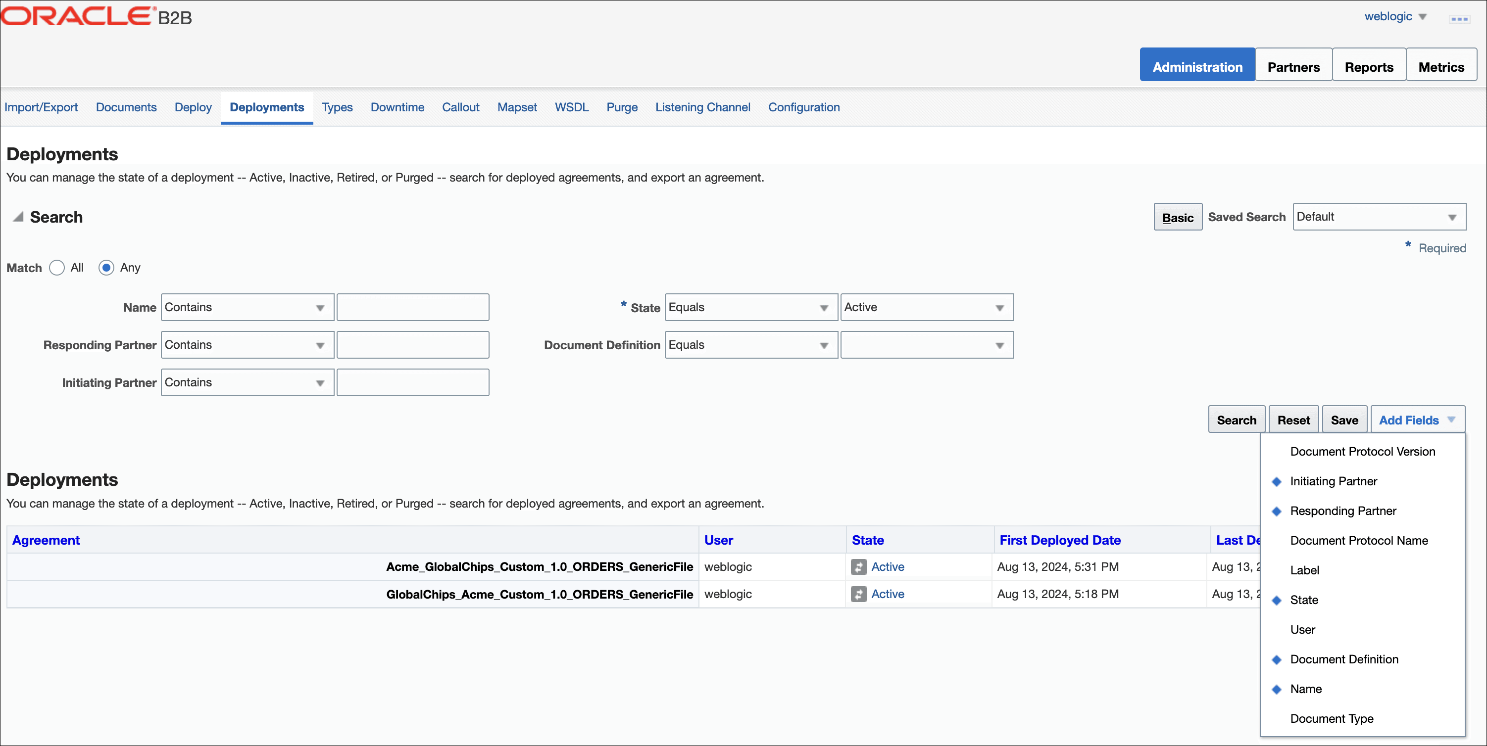

Click Advanced to select additional search parameters, as shown in Figure 9-2.
If you select the document search parameters from the Add Fields list, use them as follows: Select a document protocol name first to populate the list of document protocol versions; next select a document protocol version to populate the list of document types; and then select a document type to populate the list of document definitions.
The Saved Search feature is not available.
Note after the user has logged in, and the host trading partner is selected by default, no agreement is shown. The user can use quick search and advanced search to search for agreements in the system.To do so, the user can clear the quick search text, then search and no agreement is shown. If the user selects remote Trading Partner, all agreements related to that Trading Partner are shown, and quick search matches the names among only those agreements. Clear the quick search text, then search and all agreements related to that Trading Partner is shown.
