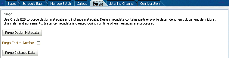

Purging Design Metadata and Instance Data
Use the Oracle B2B interface to purge design metadata and instance data. Purging does not remove artifacts that B2B creates in the Credential Store, such as passwords.
Design metadata contains partner profile data, identifiers, document definitions, channels, and agreements. When you purge this data, predefined data that is part of the installation (the host trading partner name, protocols, and identification types, for example) is not purged.
Instance data is created during runtime when messages are processed and contains the business messages and message-related data. Specific instance data can be purged from the Business Message tab of the Reports link. For more information, see Purging Messages.

To purge design metadata or instance data:
