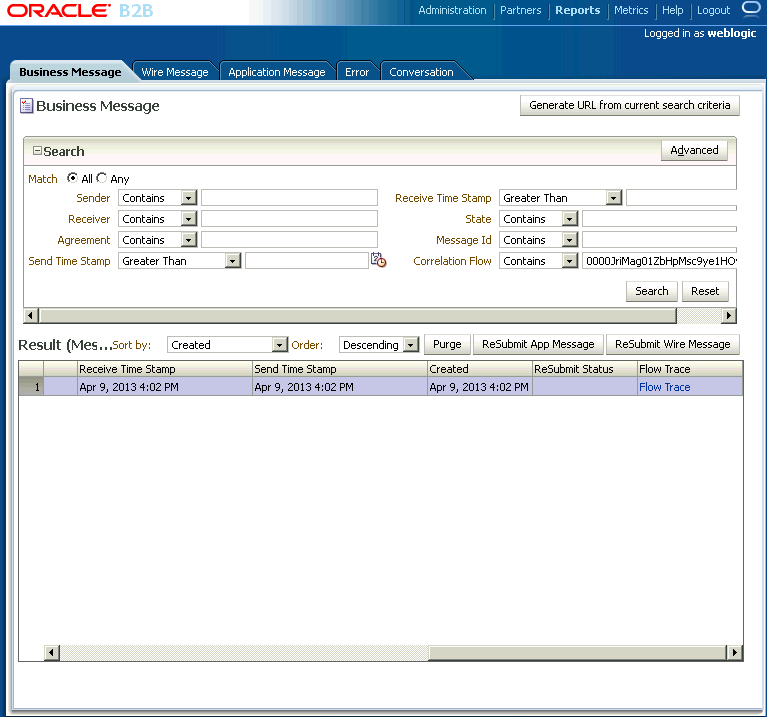

You can view the flow trace for a business flow event by clicking the Flow Trace link in a Business Report in the Oracle B2B console.
This is displayed in Figure I-1.
Figure I-1 The Flow Trace Link in Oracle B2B Business Message Report
Description of "Figure I-1 The Flow Trace Link in Oracle B2B Business Message Report"

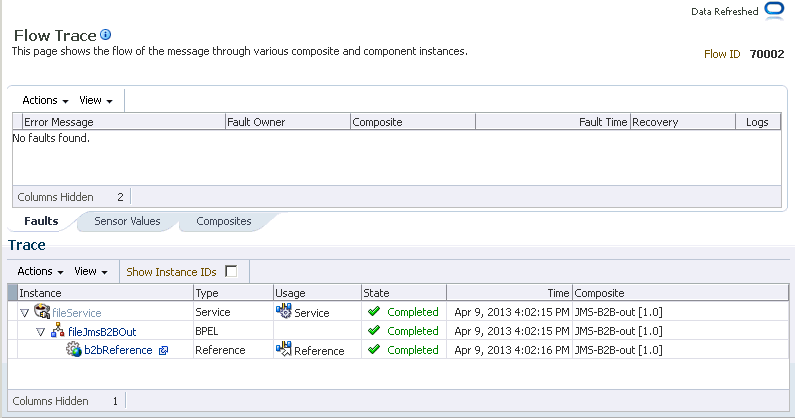

When you click the link, you will be redirected to the Oracle Fusion Middleware Enterprise Management control console, where you can view the Flow Trace as displayed in Figure I-2.
In a B2B High Availability environment, the Enterprise Management SOA Composite Flow Trace link the B2B Reports does not work.

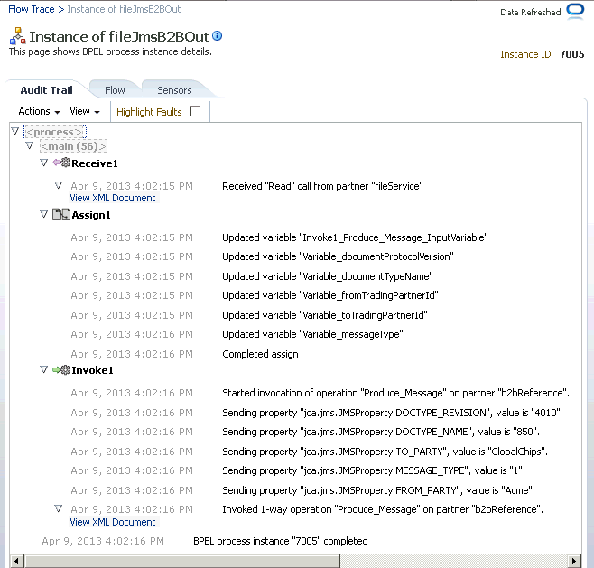

You can click the BPEL component link in the Flow Trace window to view the detailed trace as displayed in Figure I-3.
