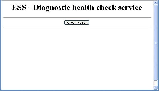

The Oracle Enterprise Scheduler health check enables verifying the Oracle Enterprise Scheduler installation using a web browser.
The health check web page submits a simple scheduled job so as to verify that Oracle Enterprise Scheduler works as it should.
How to Verify the Oracle Enterprise Scheduler Installation Using a Browser
You can verify the installation of Oracle Enterprise Scheduler using a web browser.
Access the Java health check servlet in a web browser. Access to the health check page is available only to users with administrator privileges.

The health check servlet schedules a job with Oracle Enterprise Scheduler as part of an HTTP request and waits for the job to either reach a terminal state, or run for 10 seconds
The health check servlet schedules a trivial job with Oracle Enterprise Scheduler as part of an HTTP request. After a few seconds, the servlet calls RuntimeServiceBean.getRequestState() to check the status of the job and constructs a response message within the servlet code. The servlet then returns a response indicating the success or failure of the job.
The servlet waits for the job to either reach a terminal state, or run for 10 seconds, whichever occurs first.
If the job reaches a terminal state in less than 10 seconds, the job results in a state of success.
If the job's terminal state does not change within 10 seconds, the job results in a state of success. However, the job is listed as not having been executed. This is because the system may be overloaded such that executing the job may take some time.
If any problems occur when submitting or executing the job, the job results in a state of failure.
