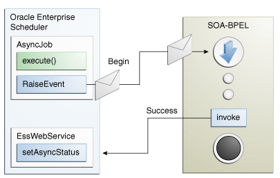

Oracle Enterprise Scheduler supports asynchronous Java job invocation with the following features:
From the Oracle Enterprise Scheduler user point of view there is no difference in scheduling asynchronous Java job invocation.
From Oracle Enterprise Scheduler perspective, the asynchronous Java job invocation job request is submitted and is added to the queue, and returns immediately after running (and the job request enters the
RUNNINGstate). Oracle Enterprise Scheduler continues operating until it hears back from the job at which point Oracle Enterprise Scheduler can apply post-processing or complete the job. -

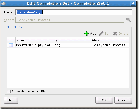

Correlation
The WSA messageID header is used to correlate the response message with the request. Oracle Enterprise Scheduler provides the method RequestExecutionContext.getIdString, which returns an ID to be used for the value of the WSA messageID header.

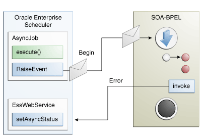

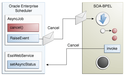

Sample Asynchronous Java Job Invoking a BPEL Process Through Event Delivery Network

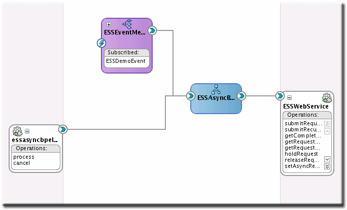

Using an asynchronous request you can invoke a BPEL process from Oracle Enterprise Scheduler. An asynchronous Oracle Enterprise Scheduler Java job is used to invoke the BPEL process. When the BPEL process completes, whether successfully, with an error or warning, or if it is canceled, the BPEL process notifies Oracle Enterprise Scheduler using a Oracle Enterprise Scheduler web service operation.
This method for invoking a BPEL process involves the following steps:
Create an asynchronous Oracle Enterprise Scheduler Java job.
Invoke a BPEL process from the Oracle Enterprise Scheduler Java job.
When the BPEL process is done, call back to the Oracle Enterprise Scheduler web service with the completion status. Use the web service operation method to inform Oracle Enterprise Scheduler of the request completion. For more information, see Using the Web Service to Notify When an Asynchronous Job Completes.
After Oracle Enterprise Scheduler has the completion information, it completes any required post-processing of the request (if required).

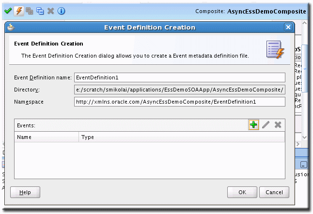

You can invoke the associated web service directly or you can publish an event telling the event mediator to start the BPEL process, as shown in Example 21-1.
Example 21-1 Job that Initiates a BPEL Process Through an Event Mediator

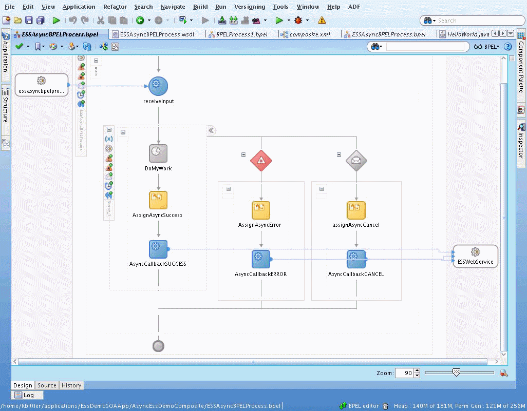

} // publishEventSample BPEL Process Design Time with Oracle Enterprise Scheduler

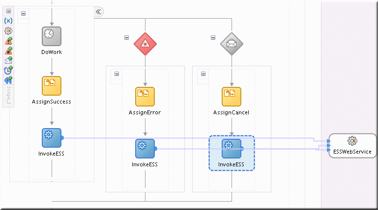

You can use an asynchronous Java job to run a BPEL process. The process initiated by an event, handled by the Event Mediator which starts the process. For an example, see Figure 21-1.
The real work of the process is done in the DoMyWork module.
If the work completes successfully, control flows to AssignAsyncSuccess/AsyncCallbackSUCCESS, which invokes the Oracle Enterprise Scheduler web service callback specifying
SUCCESSfor the status and no status message. -
If the Oracle Enterprise Scheduler request is canceled, the Oracle Enterprise Scheduler job's cancel method is called. The job object would then notify the remote job that it should be canceled. If the cancel succeeds, the remote job notifies Oracle Enterprise Scheduler using the callback mechanism, setting the status to CANCEL. In this case, control would jump to the branch on the far right.
If a fault occurs, control jumps to the middle branch. AsyncCallbackERROR invokes the Oracle Enterprise Scheduler web service callback specifying
ERRORfor the status and an error message from the fault. AsyncCallbackCANCEL invokes the Oracle Enterprise Scheduler web service callback specifyingCANCELfor the status and no status message.
Figure 21-1 Java Job to Call a BPEL Process and Return with Asynchronous Request
Description of "Figure 21-1 Java Job to Call a BPEL Process and Return with Asynchronous Request"

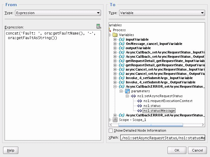

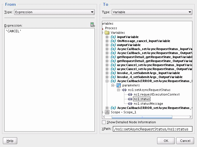

In the BPEL process, you need the web service operation values to the Oracle Enterprise Scheduler asynchronous callback, as shown in Figure 21-2, Figure 21-3, and Figure 21-4 for the AssignAsyncError assignment activity.
Figure 21-2 AsyncCallBackError Argument Mapping for statusMessage Element
Description of "Figure 21-2 AsyncCallBackError Argument Mapping for statusMessage Element"
Figure 21-3 AsyncCallbackError Argument Mapping for requestExecutionContext
Description of "Figure 21-3 AsyncCallbackError Argument Mapping for requestExecutionContext"
Figure 21-4 AsyncCallbackError Argument Mapping for status Element
Description of "Figure 21-4 AsyncCallbackError Argument Mapping for status Element"

Design Pattern Summary
Asynchronous Oracle Enterprise Scheduler jobs are Java jobs that implement the AsyncExecutable interface, which is invoked by Oracle Enterprise Scheduler by implementing the execute() method. This method enables initiating a long running or remote task where the execute() method completes (such as raising a business event), while Oracle Enterprise Scheduler keeps the job in RUNNING status. The remote task completes and notifies Oracle Enterprise Scheduler of its completion using a status message using one of the following implementations:
The
RuntimeServiceEJB -
The Oracle Enterprise Scheduler web service
setAsyncRequestStatusoperation.
This pattern assumes the remote task to be invoked is a BPEL process which is triggered by raising a business event in the execute() method of the asynchronous job. Upon termination of the process through completion, error or cancellation, the BPEL process invokes the Oracle Enterprise Scheduler web service and sets the status accordingly.
Involved Components
Oracle Enterprise Scheduler, SOA Meditator and BPEL, as shown in Figure 21-5.
Figure 21-5 BPEL Call from Oracle Enterprise Scheduler Asynchronous Job
Description of "Figure 21-5 BPEL Call from Oracle Enterprise Scheduler Asynchronous Job"
Introduction to the Recommended Design Pattern
There are use cases where Oracle Enterprise Scheduler jobs need to invoke BPEL processes in a bi-directional fashion to track completion of that BPEL before moving on to other jobs. As invoking asynchronous web services from Java code (Oracle Enterprise Scheduler or Oracle ADF Business Components) in Oracle Fusion Applications is prohibited, an Oracle Enterprise Scheduler job cannot invoke an asynchronous BPEL process directly and must rely on the asynchronous job implementation type.
This approach is recommended because it leverages existing functionality in Oracle Fusion Middleware, such as events and BPEL.

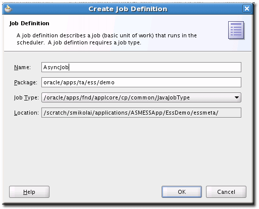

Use Case: Create the Asynchronous Job Definition
In your Oracle Enterprise Scheduler JDeveloper workspace, click "New', choose the Enterprise Scheduler Service technology group and select "Job Definition". Enter the name off your Oracle Enterprise Scheduler job definition, choose the provided "JavaJobType" and select the class build in step 1 as the overriding Java class for this job definition, as shown in Figure 21-6.
Now choose the class developed in Step 1 as the overriding Java class for this job definition, define parameters and access control as required by your use case, as shown in Figure 21-7.
Figure 21-7 Create Job Definition with Job Type Defined
Description of "Figure 21-7 Create Job Definition with Job Type Defined"

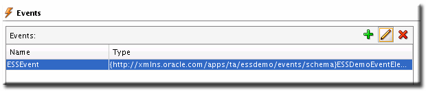

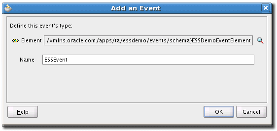

Use Case: Design the Event Payload Schema and Event Definition Files
The SOA composite designer has UI features to assist in designing business event payload definitions (EDL); however your schema (.xsd) must be designed first. Example 21-3 shows a sample XSD file.
With the payload element type completed, you can either create the EDL by hand or use the event definition builder. To use the builder, open the SOA composite editor and click the lightning bolt button at the top of the UI to open the Event Definition Creation window, as shown in Figure 21-8
Next, assign a name and name space and click Add to add a new event to this definition, as shown in Figure 21-9.
Click OK. The event definition summary displays the completed event definition. Add more events as needed for your requirements, as shown in Figure 21-10.
Example 21-4 shows a sample of the EDL file that is created.

Since this use case depends on BPEL functionality it is necessary to build a SOA composite which contains a Mediator for event subscription which can then transform the payload and initiate the BPEL process.
In your SOA workspace, create a new SOA composite. To setup the composite for this pattern, add a Mediator that subscribes to your Oracle Enterprise Scheduler raised event and wire it to a BPEL process. Add a service reference to the Oracle Enterprise Scheduler web service WSDL. For example,
http://myhost.com:7001/ess/esswebservice?WSDL
Continue to build the required functionality in the BPEL process using one or more nested scopes. Bear in mind that your functionality should reside within at least one primary scope on which you can add an onMessage event (for in-flight cancel message receipt) and fault handler branches, as shown in Figure 21-11.
Figure 21-11 Composite with BPEL and ESSWebService
Description of "Figure 21-11 Composite with BPEL and ESSWebService"
For more information about invoking the Oracle Enterprise Scheduler web service, see Using the Oracle Enterprise Scheduler Web Service .

BPEL Handling Cancellation
For example, if the end user interacts with the monitoring UI and requests that the job be canceled, Oracle Enterprise Scheduler then updates the job's status to CANCELLING and wait for the remote functionality to tidy up and confirm that it has canceled, as shown in Figure 21-12.
BPEL Handling Error
Additionally, when the remote functionality encounters a failure, the responsibility to notify Oracle Enterprise Scheduler of this failure falls on the shoulders of the remote functionality (in this case, BPEL) to notify Oracle Enterprise Scheduler that the job's status is ERROR and provide a status message in addition to any logging that was performed. This is illustrated in Figure 21-13.
In order to acknowledge cancellation and arbitrate proper status back to the Oracle Enterprise Scheduler infrastructure, BPEL must be designed within a certain layout to support receipt of the incoming cancellation message and trapping of any failures such that, in either case, the Oracle Enterprise Scheduler subsystem can be updated. For this purpose, in the BPEL Process, there should be at least one scope which contain the functionality for this asynchronous job. This allows sufficient control for handling cancel and error states which must then be sent to the Oracle Enterprise Scheduler web service in order to update the job's status in the Oracle Enterprise Scheduler runtime.
To build the basic process flow to support these states, the following steps should be completed in order:
- Create the correlation set and flag it for imitate on the incoming Receive activity.
- Create the
onMessagebranch with use of correlation set created in sub-step 1. - Create the fault handling branch.
- Populate the
onMessageand fault handling branches with cleanup activities as needed and invoke the Oracle Enterprise Scheduler web service with appropriate status.

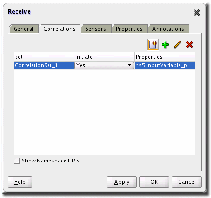

Create Correlation Set and Define Initiate Activity
In order to support receiving the cancel event while the BPEL process is in the middle of performing other activities or waiting for an asynchronous callback the process must be configured with a correlation set. A correlation set is key value that is built from one or more incoming payload attributes which are used to uniquely identify the BPEL process to the BPEL engine whereby additional service requests that contain matching sets of attributes can be routed to the process that is currently running instead of initiating a new one. While correlation is standard functionality used for asynchronous request responses, it can also be used to change the flow of execution in a BPEL process through scope-level onMessage branches.
To setup the correlation set, open the BPEL process in the designer, double-click the Receive activity and click the correlations tab.
Note that coarctation sets have an "initiate" property which indicates which activity is the starting point for this correlation set's life cycle. In this case, the start of the BPEL process is the point at which the correlation set's life cycle should begin allowing correlated events to route to this process at any point during the process.
To create a correlation set:
Click the "New" button in the Correlations tab of any Receive, Invoke or
onMessageactivity and provide a name for the correlation set. -
Next, click "Add" to define one or more property attributes to use as the correlation key.
Choose a variable attribute as the set property and click "OK".
Repeat steps 2 and 3 as necessary to build an attribute set that is always unique.
Set the initiate flag on the correlation to "Yes" on the activity for which the correlation set's life cycle should begin.
Primary (first) Receive Activity with Defined Correlation Set and "Initiate" flagged to "Yes", as shown in Figure 21-14.
Figure 21-14 Correlations for Receive Activity
Description of "Figure 21-14 Correlations for Receive Activity"
CorrelationSet_1 definition with a single property defined (define more as needed to ensure unique keys are created), as shown in Figure 21-15.

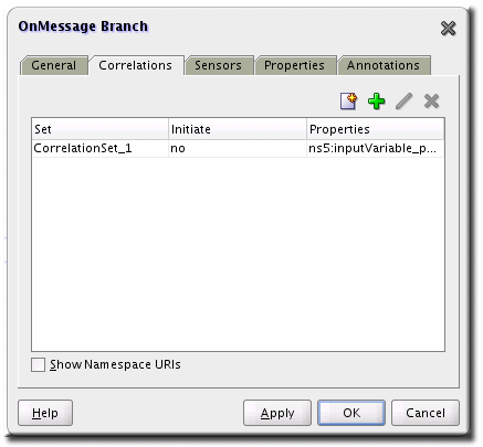

Create the onMessage Branch with Use of Correlation Set
After the correlation set has been defined and set for initiate it's now possible to create the onMessage branch on the scope that contains the activities necessary to accept the incoming cancellation message, perform any compensation or cleanup and then assign the job's completion status to CANCEL.
At this point, the onMessage branch could contain the invoke activity or finish allowing a higher order scope to perform the invoke, reducing the overall number of necessary invoke activities in the flow.
The following steps guide you through adding the previously created correlation set to the onMessage branch activity, as shown in Figure 21-16.
On the nested scope containing the process functionality, click the 'Add onMessage branch' button which should create a new flow off to the side of the scope.
Double-click the
onMessagebranch activity to open the activity editor. -
Choose the "Correlations" tab.
Click the Add '+' button and select the previously created correlation set ensuring that the initiate flag is set to 'No' and click "Ok".
Figure 21-16 BPEL OnMessage Branch

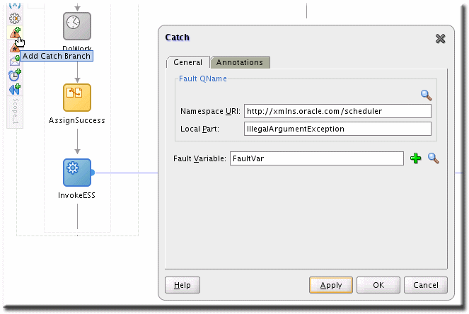

Create the Fault Branch
Through the course of performing the various activities in the nested work scope BPEL may encounter faults from business services or system functionality. In most cases, business services define one or more WSDL-defined faults that can be thrown back to the calling process. Ordinarily, a BPEL CatchAll fault branch traps any and all faults that are raised regardless of their type and origin but there may be cases where product teams have requirements to perform different sets of behavior in response to specific business faults. In cases where it's desirable to perform unique compensation behavior for specific business faults, the developer should create a named fault handling branch for each WSDL-defined fault. In addition to these named fault handler branches, it is still necessary to add a CatchAll fault handling branch to trap any system level or unmanaged faults that are raised from the scope.
Click the CatchFault and CatchAll scope buttons to create the desired fault handling branches, then double-click the named fault handling branches and define the named fault those branches catch.
Note the available status, as shown in Figure 21-17.
Populate the onMessage and Fault Branch
You need to populate the onMessage and Fault branch with cleanup activities as needed and invoke Oracle Enterprise Scheduler web service with appropriate status.
In the event of a fault or receipt of the cancellation message through the onMessage branch the Oracle Enterprise Scheduler infrastructure must be updated directly using the Oracle Enterprise Scheduler web service in order to reflect the job's status and status message properly in the monitoring UIs. As a result, each fault handling or onMessage branch should assign the correct status and status message value to the Oracle Enterprise Scheduler web service invoke variable and optionally contain the invoke activity or, by design, return to a higher order scope which is designed to be agnostic to the outcome of the job status and perform the invoke activity on the Oracle Enterprise Scheduler web service before completing.
Additionally, drag activities into the onMessage and fault branches as needed to cleanup/log/compensate.
Example scope with onMessage and Fault handling branches is shown in Figure 21-18.
