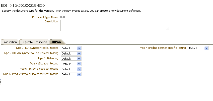

J.2.2 Configuring SNIP at the Document Level
You can configure SNIP validations at the Document level under the Administration link. Setting the SNIP level at the Document level makes the configuration global for all the Trading Partners that use that particular HIPAA document.
To configure SNIP validation at the Document level:
Figure J-1 displays a HIPAA document with the various validation types.
Figure J-1 Configuring SNIP at the Document Level
Description of "Figure J-1 Configuring SNIP at the Document Level"

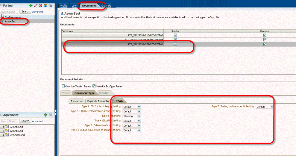

J.2.3 Configuring SNIP at the Trading Partner Level
You can configure SNIP validations at the Trading Partner level under the Partners link in the Documents tab. Setting the SNIP level at the Trading Partner level overrides the configuration set at the Document Type level.
Figure J-2 displays how to configure SNIP at the Trading Partner level.
