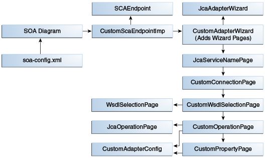

The following table describes, and the diagram shows the different classes that makes up the Custom Adapter. A Class Diagram follows.
Table 3-1 Custom Adapter Classes
| Class | Description |
| SOA Diagram | The graphical editor for the composite.xml. |
| SCA Endpoint | Provides a proxy between the SOA diagram and the Adapter framework. |
| JcaAdapterWizard | Allows you to add initial Wizard pages. |
| CustomAdapterWizard | Extends JcaAdapterWizard to enable overriding public methods |
| JcaServiceName Page | Provides the Service Name page. |
| CustomConnectionPage | Creates a page that will prompt for the connection-factory location and puts this information into the data model. |
| CustomWSDLSelectionPage | Provides the user the option to select a existing WSDL, portType, and operation rather than generating a default WSDL |
| CustomOperationPage | Add and remove wizard pages depending on the operation chosen. |
| CustomPropertyPage | Enables the user to set activation and interaction spec properties. |
