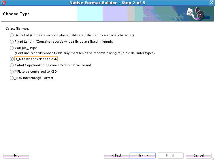

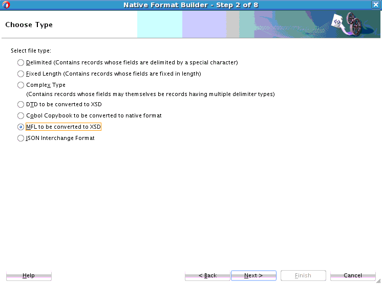

Supported File Formats
The Native Format Builder wizard guides you through the creation of a native schema file from the following file formats shown in Figure 4-2. You must have a sample data file format for the selected type to create a native schema. You can also select the option for editing an existing native schema created with this wizard, except for those generated from a Document Type Definition (DTD) or COBOL Copybook file types. For information on editing the native schema file, see Editing Native Schema Files.
Delimited
This option enables you to create native schemas for records, where the fields are separated by a value such as a comma or number sign (#).
Fixed Length (Positional)
This option enables you to create native schemas for records, where all fields are of fixed lengths.
Complex Type
This option enables you to create native schema for records, where the fields may themselves be records having multiple delimiter types.
DTD
This option enables you to generate native schema from the user-supplied DTD, which contains information about the structure of an XML document.

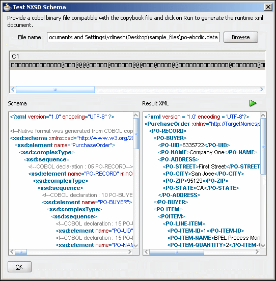

COBOL Copybook
This option enables you to generate native schema from the user-supplied COBOL Copybook definition.
A COBOL mainframe application typically uses a COBOL Copybook file to define its data layout. The converter creates a native schema from a COBOL Copybook so that the runtime translator can parse the associated data file.
A COBOL Copybook is typically a collection of group items (structures). These group items contain other items, which can be groups or elementary items. Elementary items are items that cannot be further subdivided. For example:

</element> User Inputs
You are expected to provide the following information:
Target namespace for the native schema to be generated
Character set of the host computer on which the data file was generated. By default, this is set to EBCDIC (
ebcdic-cp-us). -
Byte order of the host computer on which the data file was generated. By default, this is set to big-endian.
Record delimiter, which is typically the new line character, or no delimiter, or any user-supplied string.
Container tag name for generated native schema. By default, this is set to
Root-Element.

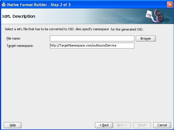

MFL to be Converted into XSD
Enables you to convert an MFL file into XSD format. For more information, see Converting an MFL Format File to Schema Format.

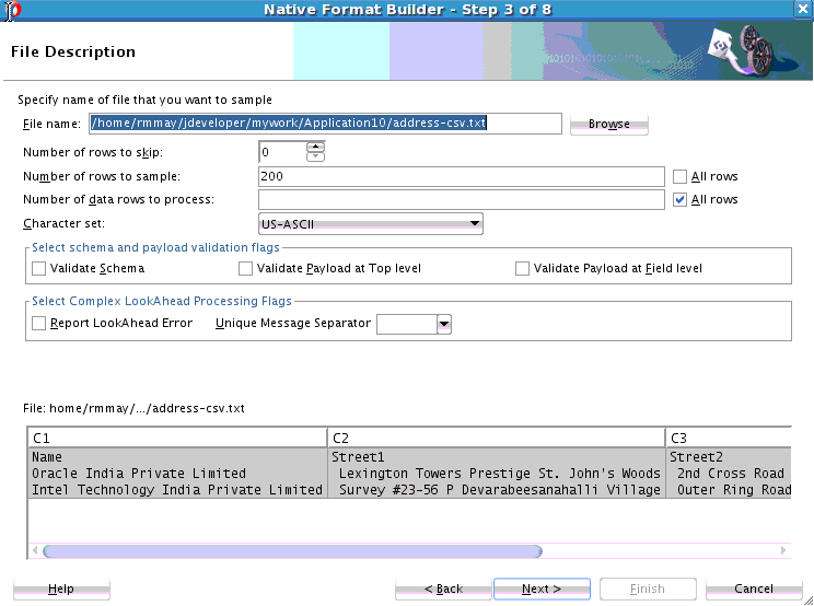

This option generates an NXSD schema from a JSON sample file or JSON file at a specified location. JSON (JavaScript Open Notation) is a text-based, open standard for human-readable data interchange. JSON comes from the JavaScript scripting language for representing simple data structures and associative arrays, called objects.

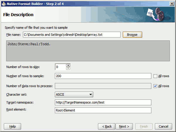

When you select this option, the Native Format Builder Wizard displays the JSON File Description screen. Here you can enter:
File Name—The name of the JSON file.
Target Namespace—Displays the target namespace.
Root Element—Specifies the JSON root level.
Character Set —Select the character set to use.

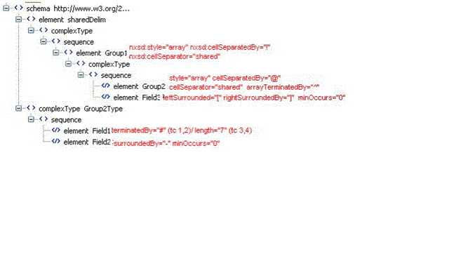

Native Schema Constructs
Get an overview of the various constructs of native schema used to translate the native format data to XML and also explains the usage of these native schema constructs.
Understanding Native Schema Constructs
All native schema constructs described in this topic belong to the
http://xmlns.oracle.com/pcbpel/nxsd namespace. You must add
a namespace declaration such as
xmlns:nxsd="http://xmlns.oracle.com/pcbpel/nxsd" and
prepend the namespace prefix nxsd to all schema constructs in
your schema. For example:
nxsd:style="array" nxsd:arrayLength="10" nxsd:stream="chars"

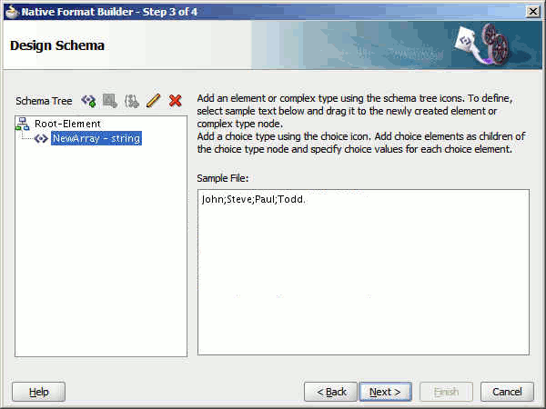

All Items Separated by the Same Mark, Including the Last Item (Unbounded)
The following sections explain the format of the data to be translated, the native schema, and the translated XML.
Native Data Format to be Translated
configure;startup;runtest;shutdown;
Native Schema:
<?xml version="1.0" encoding="US-ASCII"?>
<schema xmlns="http://www.w3.org/2001/XMLSchema"
xmlns:tns="http://xmlns.oracle.com/pcbpel/nxsd/smoketest"
targetNamespace="http://xmlns.oracle.com/pcbpel/nxsd/smoketest"
elementFormDefault="qualified"
attributeFormDefault="unqualified"
nxsd:stream="chars"
nxsd:version="NXSD">
<element name="list" type="tns:CommandSet" />
<complexType name="CommandSet" nxsd:style="list" nxsd:itemSeparatedBy=";">
<sequence>
<element name="Cmd1" type="string" />
<element name="Cmd2" type="string" />
<element name="Cmd3" type="string" />
<element name="Cmd4" type="string" />
</sequence>
</complexType>
</schema>
Translated XML Using the Native Schema
<list xmlns="http://www.oracle.com/ias/processconnect"> <Cmd1>configure</Cmd1> <Cmd2>startup</Cmd2> <Cmd3>runtest</Cmd3> <Cmd4>shutdown</Cmd4> </list>

Explicit Array Length
3;John;Steve;Paul;Todd;

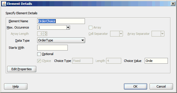

Conditional Processing
This section provides the following examples of conditional processing:

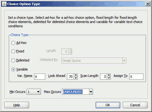

Processing One Element Within a Choice Model Group Based on the Condition
PO28/06/2004^|ABCD Inc.|Oracle OracleApps025070,000.00 Database 021230,000.00 ProcessCon021040,000.00 PO01/07/2004^|EFGH Inc.|Oracle DB2 021230,000.00 Eclipse 021040,000.00 SO29/06/2004|Oracle Apps|5 Navneet Singh PO28/06/2004^|IJKL Inc.|Oracle Weblogic 025070,000.00 Tuxedo 021230,000.00 JRockit 021040,000.00 IN30/06/2004;Navneet Singh;Oracle;Oracle Apps;5;70,000.00;350,000.00

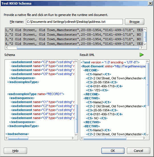

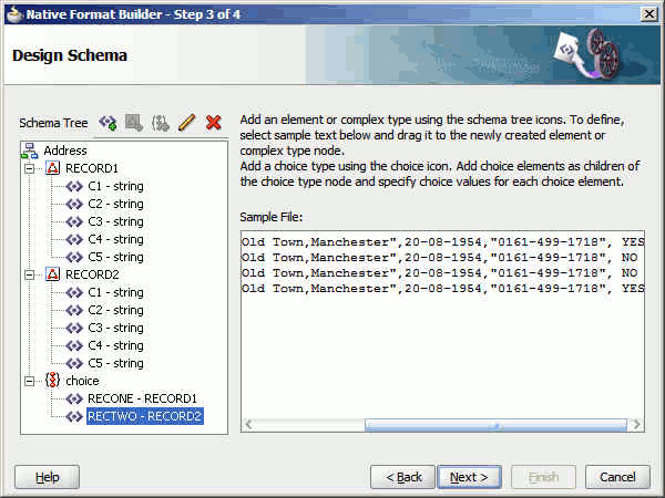

LookAhead: Type 2
In native schema, LookAhead X chars, read the value from a position using a style, and store that value in a variable to be used later.
Native Data Format to Be Translated
Name1,"2 Old Street, Old Town,Manchester",20-08-1954,"0161-499-1718", YES Name2,"2 Old Street, Old Town,Manchester",20-08-1954,"0161-499-1718", NO Name3,"2 Old Street, Old Town,Manchester",20-08-1954,"0161-499-1718", NO Name4,"2 Old Street, Old Town,Manchester",20-08-1954,"0161-499-1718", YES
Native Schema
nxsd:stream="chars"
nxsd:lookAhead="70" nxsd:scan="3"
<element name="LookAhead">
<complexType>
<choice maxOccurs="unbounded" nxsd:choiceCondition="${x}" nxsd:lookAhead="70"
nxsd:scanLength="3" nxsd:assignTo="${x}">
<element name="Record1" type="string" nxsd:conditionValue="YES"
nxsd:style="terminated" nxsd:terminatedBy="," nxsd:skipMode="after"
nxsd:skipUntil="${eol}" />
<element name="Record2" type="string" nxsd:conditionValue="NO "
</choice>
</complexType>
</element>
</schema>
Translated XML Using Native Schema
<LookAhead xmlns="http://xmlns.oracle.com/pcbpel/nxsd/smoketest"> <Record1>Name1</Record1> <Record2>Name2</Record2> <Record2>Name3</Record2> <Record1>Name4</Record1> </LookAhead>

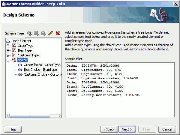

When you use the conditionValue construct along with the choiceCondition construct, you can specify match criteria such as equals (==) and not equals (!=), along with the Boolean operators AND and OR, for comparison between the value read and the value specified in the conditionValue construct.
Order, ID41678, 20May2000 Item1, GigaWidget, 60, $75 Item2, MegaBucket, 48, $125 Cust1, Hopkins Associates, ID26490 Order, ID41680, 20May2000 Item3, Rt.Clopper, 40, $100 Item4, Lt.Clopper, 50, $100 Cust2, Jersey WebInovaters, ID46786
Native Schema
<?xml version="1.0" ?>
<xsd:schema xmlns:xsd="http://www.w3.org/2001/XMLSchema"
targetNamespace="http://xmlns.oracle.com/pcbpel/nxsd/extensions/SampleNS"
xmlns:tns="http://xmlns.oracle.com/pcbpel/nxsd/extensions/SampleNS"
attributeFormDefault="unqualified" nxsd:encoding="US-ASCII"
nxsd:stream="chars" nxsd:version="NXSD">
<xsd:element name="Container">
<xsd:complexType>
<xsd:choice minOccurs="1" maxOccurs="unbounded"
nxsd:choiceCondition="terminated" nxsd:terminatedBy=",">
<xsd:element name="Customer" nxsd:conditionValue="(== Cust1) or (== Cust2)
and (!= emp)">
<xsd:complexType>
<xsd:sequence>
<xsd:element name="C1" type="xsd:string" nxsd:style="terminated"
nxsd:terminatedBy="," nxsd:quotedBy=""">
</xsd:element>
<xsd:element name="C2" type="xsd:string" nxsd:style="terminated"
nxsd:terminatedBy="${eol}" nxsd:quotedBy=""">
</xsd:element>
</xsd:sequence>
</xsd:complexType>
</xsd:element>
<xsd:element name="Item" nxsd:conditionValue="(== Item1) or (== Item2) or
(==Item3) or (== Item4)">
<xsd:complexType>
<xsd:sequence>
</xsd:element>
</xsd:element>
<xsd:element name="C3" type="xsd:string" nxsd:style="terminated"
</xsd:element>
</xsd:sequence>
</xsd:complexType>
</xsd:element>
<xsd:element name="Order" nxsd:conditionValue="Order">
<xsd:complexType>
<xsd:sequence>
</xsd:element>
</xsd:element>
</xsd:sequence>
</xsd:complexType>
</xsd:element>
</xsd:choice>
</xsd:complexType>
</xsd:element>
</xsd:schema>
<complexType>
<choice maxOccurs="unbounded" nxsd:choiceCondition="${x}" nxsd:lookAhead="70" nxsd:scanLength="3" nxsd:assignTo="${x}">
<element name="Record1" type="string" nxsd:conditionValue="YES" nxsd:style="terminated" nxsd:terminatedBy="," nxsd:skipMode="after" nxsd:skipUntil="${eol}" />
<element name="Record2" type="string" nxsd:conditionValue="NO " nxsd:style="terminated" nxsd:terminatedBy="," nxsd:skipMode="after" nxsd:skipUntil="${eol}" />
</choice>
</complexType>
</element>

Defining the Choice Condition Schema for a Complex File Structure
Defining Choice Condition With LookAhead for a Complex File Structure

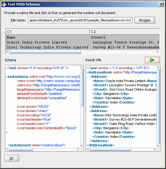

Defining the Schema for a Delimited File Structure
A comma-separated value (CSV) file is a common non-XML file structure.
Use the Delimited option in the Native Format Builder wizard, when creating the XML schema for this native file.
The nxsd:headerLines="1" schema attribute signifies that the first line must be treated as a header row and skipped in the native data before actually translating the rest of the data. The nxsd:stream="chars" schema attribute signifies that the data should be read as characters. If nxsd:stream is set as bytes, nxsd:stream="bytes", then this schema attribute signifies that the native data should be read as bytes. For each of the element declarations, Name, Street, City, State, and Country, which have a corresponding scalar data, the nxsd:style="terminated" attribute defines that the corresponding data is stored in terminated style. The actual terminator is then defined by the nxsd:terminatedBy="," attribute specified at that construct. See Defining Terminated Data for details on the terminated style.
In this use case, the Native Format Builder uses a delimited sample file type that contains the address details, such as name, street, city, state, and country. Every element in this sample native file is delimited by a comma (,). You can generate the corresponding NXSD and also test it. Perform the following steps to run the use case:
Defining a Asterisk (*) Separated Value File Structure
The use case defined in the previous example is just one specific case of the *SV class, where the wildcard can be substituted by any character or string. For example, for the native data containing a plus (+) separated value, substitute the wildcard with the plus (+) character.
Use the Delimited type option in the Native Format Builder wizard when creating the XML schema for this native file.
The following native data format is provided:
a+b+c+d+e f+g+h+i+j
Native Schema
The corresponding native schema definition is similar to the one in the previous use case except that instead of nxsd:terminatedBy="," you now define the terminated by format as nxsd:terminatedBy="+". See Defining Terminated Data for details about the terminated style.

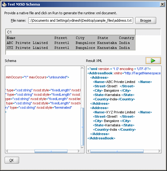

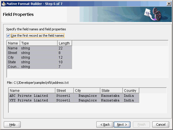

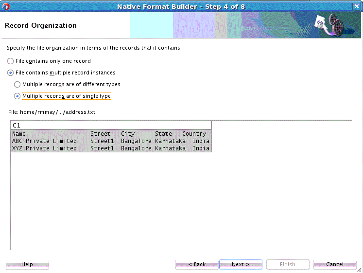

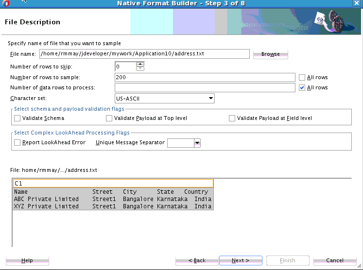

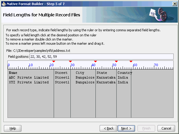

Defining the Schema for a Fixed Length File Structure
In this example, the native data used is the same as in the CSV case, but the data used is of type fixed length and not CSV.
Use the Fixed Length option in the Native Format Builder wizard, to create the XML schema for this native file.
In this use case, the Native Format Builder uses a fixed-length file type called address that contains the address details such as name, street, city, state, and country. Every element in this address native file has a fixed length. You can generate the corresponding NXSD and also test it. Perform the following steps to run the use case:

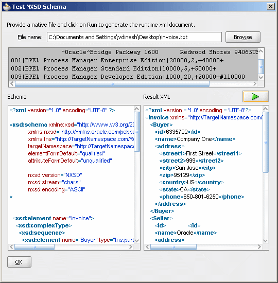

In this use case, the Native Format Builder uses invoice.txt, a complex file type called invoice, which contains multiple records such as buyer, seller, and items. Also, using this use case, you can generate the NXSD and test it. Perform the following steps to run this use case:
The data in a sample text file,
invoice.txt, is:6335722^Company OnêFirst Street 999 San Jose 95129USCA650-801-6250 ^OraclêBridge Parkway 1600 Redwood Shores 94065USCA650-506-7000 001|BPEL Process Manager Enterprise Edition|20000,2,+40000+ 002|BPEL Process Manager Standard Edition|10000,5,+50000+ 003|BPEL Process Manager Developer Edition|1000,20,+20000+#110000

Click Next. The Choose Type page is displayed, as shown in Figure 4-26.
Figure 4-26 Native Format Builder Wizard Choose Type Page
Description of "Figure 4-26 Native Format Builder Wizard Choose Type Page" -
Select Complex Type (Contains records whose fields may themselves be records having multiple delimiter types).

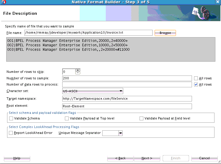

Click Next. The Native Format Builder File Description page is displayed.
Click Browse and select the
invoice.txtfile, and enterInvoicein the Root element field, as displayed in Figure 4-27.Figure 4-27 Native Format Builder Wizard File Description Page
Description of "Figure 4-27 Native Format Builder Wizard File Description Page" -

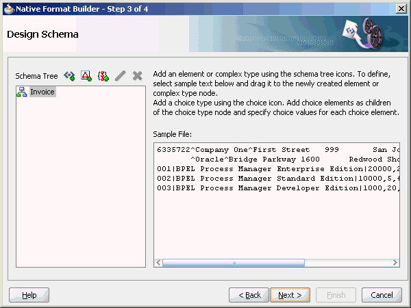

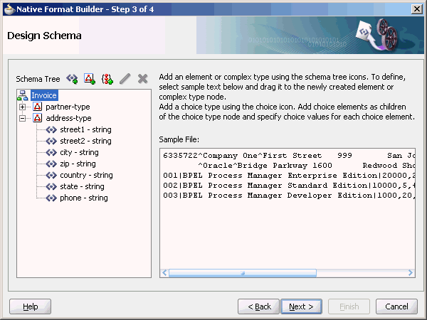

Click Next. The Native Format Builder Design Schema is displayed, as shown in Figure 4-28.
Figure 4-28 Native Format Builder Wizard Design Schema Page
Description of "Figure 4-28 Native Format Builder Wizard Design Schema Page"
Create the partner-type Complex Type
The schema structure that you can build using the invoice.txt sample is as follows:
Invoice
Buyer => partner-type
Seller => partner-type
Items => item-type
Invoice-total => double
The first line in the native data consists of buyer details, followed by seller details, followed by line items, and finally the total for the line items. Both buyer and seller elements have the same complex structure, as follows:
The first seven characters are the UID
This is followed by the buyer/seller name surrounded by "
This is followed by the address until the end of the line.

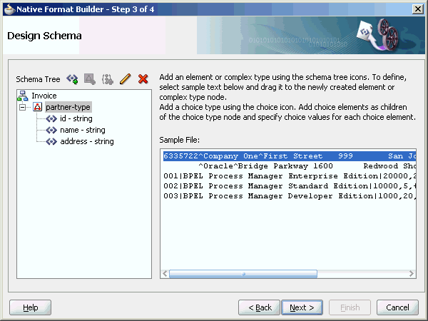

Select the first row of the sample text from the right-hand pane of the Sample File section, and drag and drop it on the <new_complex_type> node. The Complex Type Details dialog is displayed.
Enter
partner-typein the Complex Type Name field, as shown in Figure 4-30.Figure 4-30 Native Format Builder Wizard Design Schema Page - Complex Type Details Dialog
Description of "Figure 4-30 Native Format Builder Wizard Design Schema Page - Complex Type Details Dialog" -
Click the ruler at the desired position to mark fields on the sample text area, and then click the Generate Fields button. The system interprets the style of data for the defined fields.
For the Fixed Length or Mixed Delimiter type options, a ruler-based text area is displayed. You have to use the rulers to identify fields within the sample text. In case of delimited data, select or enter the appropriate delimiter in the Delimited By field.
Enter the id, name, and address in the Name field, as shown in Figure 4-31.
Click the pencil icon adjacent to each field to display the corresponding Edit Field Details dialog that enables you to edit the field properties. For example, click the pencil icon adjacent to the Name field. The Edit Field Details dialog is displayed, as shown in Figure 4-32.
Edit the following field properties, as shown in Figure 4-32.
Type: The data type of the sample text. Select String from the Type list.
Style: Represents the style of the complex type element. You can select any of the following four options:
fixed length
surrounded
terminated
left/right surrounded
In this example, select surrounded.
Surrounded By: This option is displayed when you select surrounded in the Style option. In this example, enter caret (
^) in the Surrounded By field.
The field properties displayed on this panel correspond to the NXSD attributes used in the schema.
Click OK. The Complex Type Details dialog is displayed with the field properties that you selected.
Verify or edit the field properties for
idandaddressName fields. -
Click OK in the Complex Type Details dialog. The Native Format Builder Design Schema page is displayed, as shown in Figure 4-33.
Figure 4-33 Native Format Builder Wizard Design Schema Page - partner-type Complex Type
Description of "Figure 4-33 Native Format Builder Wizard Design Schema Page - partner-type Complex Type"

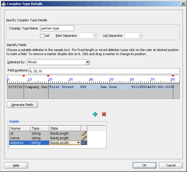

Create an address-type Complex Type
The address element can be further defined as another complex-type that contains a fixed-length street, city, and additional fields.
To do so:
Create another
<noncompliant>node in the Schema Tree. See Step 1 in Create the partner-type Complex Type. -
Drag and drop the address part in the first row of the sample text to the Complex Type,
<noncompliant>. The Complex Type Details dialog is displayed. -
Enter address-type in the Complex Type Name field.
Click the ruler to mark fields on the sample text area, and then click the Generate Fields button. Now, enter street1, street2, city, zip, country, state, and phone in the Name field, as shown in Figure 4-34.
Figure 4-34 Native Format Builder Wizard Design Schema Page - Complex Type Details Dialog
Description of "Figure 4-34 Native Format Builder Wizard Design Schema Page - Complex Type Details Dialog" -
Click OK. The Native Format Builder Design Schema page is displayed, as shown in Figure 4-35.
Figure 4-35 Native Format Builder Wizard Design Schema Page
Description of "Figure 4-35 Native Format Builder Wizard Design Schema Page"

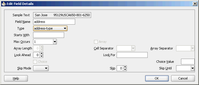

Assign the address-type Complex Type to the address field of partner-type Complex Type
You must assign the address-type complex type to the address field of the partner-type complex type. You can assign a complex type to an element by using one of the following methods:
Drag and drop the address-type node on the address field node of the partner-type complex type. This instantly assigns address-type to the address field element, or
Select the address field node of the partner-type complex type and then click the pencil icon.
The Edit Field Details dialog is displayed, as shown in Figure 4-36.
Select the address-type option in the Type list, and click OK. The address-type option is assigned to the address field element in the Native Format Builder Design Schema page, as shown in Figure 4-37.
Figure 4-37 Native Format Builder Wizard Design Schema Page
Description of "Figure 4-37 Native Format Builder Wizard Design Schema Page"

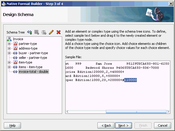

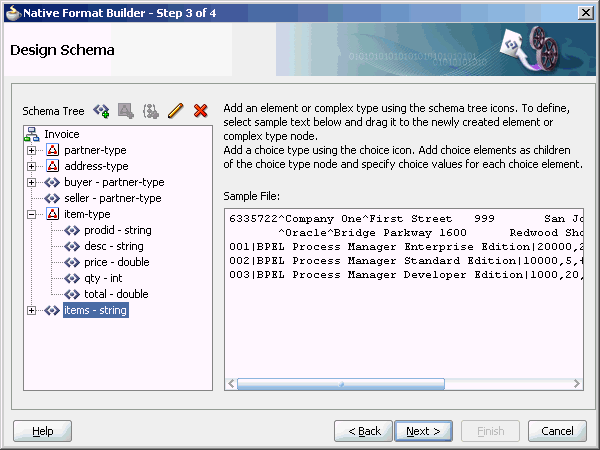

Create item-type Complex Type, and items and invoice-total Element Nodes
The items element can be considered an array of item-types. The last line item in the native file ends with the number sign (#), followed by the line-item total.
Select Invoice, and click the Add Element icon. An element,
<new_element>, is created in the Schema Tree under Invoice. -
Rename it to items.
Create the item-type complex type and define the field properties, as shown in Figure 4-39.
Figure 4-39 Native Format Builder Wizard Design Schema Page
Description of "Figure 4-39 Native Format Builder Wizard Design Schema Page" -
Drag and drop item-type complex type to the items element to assign item-type to this element.
Select items - item-type and click the pencil icon. The Element Details dialog is displayed.
Set the following properties in the Element Details dialog, as shown in Figure 4-40:
Max. Occurrence:
UNBOUNDED -
Select Array. The Cell Separator and Array Separator are enabled.
Cell Separator:
${eol} -
Array Separator:
The element
itemsis defined as an array ofitem-type. -
Click OK.
Create the invoice-total element, and drag and drop the sample text (
110000) on the <new_element> node. The Element Details dialog is displayed. -
Enter
invoice-totalin the Element Name field, and click Generate Fields. The Alert message is displayed, as shown in Figure 4-41.Figure 4-41 Element Details Dialog - Alert Message
Description of "Figure 4-41 Element Details Dialog - Alert Message"If a single field is identified in the sampled data for a global element, then the properties of this data are applied to the global element itself.
Click OK in the Alert message. The Element Details dialog is displayed.
Select double in the Data Type list, and click OK. The Native Format Builder Design Schema page is displayed, as shown in Figure 4-42.
Figure 4-42 Native Format Builder Wizard Design Schema Page - Complete Schema Tree
Description of "Figure 4-42 Native Format Builder Wizard Design Schema Page - Complete Schema Tree" -

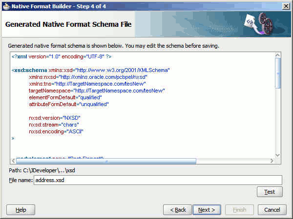

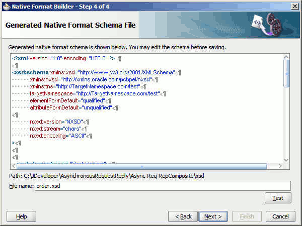

Click Next. The Generated Native Format Schema File page is displayed, as shown in Figure 4-43, which displays the native format file.
Figure 4-43 Native Format Builder Wizard Generated Native Format File Page
Description of "Figure 4-43 Native Format Builder Wizard Generated Native Format File Page"The native schema definition corresponding to the preceding native data can be defined as follows:
Example - Native Schema Definition
<schema attributeFormDefault="qualified" elementFormDefault="qualified" targetNamespace= "http://xmlns.oracle.com/ias/pcbpel /fatransschema/demo" xmlns:tns="http://xmlns.oracle.com /ias/pcbpel/ fatransschema/demo" xmlns="http://www.w3.org/2001/XMLSchema" xmlns:nxsd="http://xmlns.oracle.com/pcbpel/ nxsd" nxsd:version="NXSD" nxsd:stream="chars"> <element name="invoice" type="tns:invoiceType" /> <complexType name="invoiceType"> <sequence> <element name="purchaser" type="tns:partnerType" /> <element name="seller" type="tns:partnerType" /> <element name="line-item" type="tns:line-itemType" maxOccurs="unbounded" nxsd:style="array" nxsd:cellSeparatedBy="${eol}" nxsd:arrayTerminatedBy="#"/> <element name="total" type="double" nxsd:style="terminated" nxsd:terminatedBy="${eol}"/> </sequence> </complexType> <complexType name="partnerType"> <sequence> <element name="uid" type="string" nxsd:style="fixedLength" nxsd:length="7" nxsd:padStyle="tail" nxsd:paddedBy=" "/> <element name="name" type="string" nxsd:style="surrounded" nxsd:surroundedBy="^"/> <element name="address" type="tns:addressType" /> </sequence> </complexType> <complexType name="addressType"> <sequence> <element name="street1" type="string" nxsd:style="fixedLength" nxsd:length="15" nxsd:padStyle="tail" nxsd:paddedBy=" "/> <element name="street2" type="string" nxsd:style="fixedLength" nxsd:length="10" nxsd:padStyle="tail" nxsd:paddedBy=" "/> <element name="city" type="string" nxsd:style="fixedLength" nxsd:length="15" nxsd:padStyle="tail" nxsd:paddedBy=" "/> <element name="postal-code" type="string" nxsd:style="fixedLength" nxsd:length="5" nxsd:padStyle="none"/> <element name="country" type="string" nxsd:style="fixedLength" nxsd:length="2" nxsd:padStyle="none"/> <element name="state" type="string" nxsd:style="fixedLength" nxsd:length="2" nxsd:padStyle="none"/> <element name="phone" type="string" nxsd:style="terminated" nxsd:terminatedBy="${eol}"/> </sequence> </complexType> <complexType name="line-itemType"> <sequence> <element name="uid" type="string" nxsd:style="fixedLength" nxsd:length="3" nxsd:padStyle="none"/> <element name="description" type="string" nxsd:style="surrounded" nxsd:surroundedBy="|"/> <element name="price" type="double" nxsd:style="terminated" nxsd:terminatedBy=","/> <element name="quantity" type="integer" nxsd:style="terminated" nxsd:terminatedBy=","/> <element name="line-total" type="double" nxsd:style="surrounded" nxsd:surroundedBy="+"/> </sequence> </complexType> </schema> -

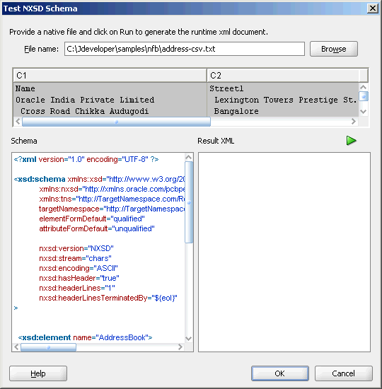

Click Test. The Test NXSD Schema dialog is displayed, as shown in Figure 4-44.
Click the Generate XML icon. The Result XML is displayed on the right pane of the Test NXSD Schema dialog, as shown in Figure 4-45.
Figure 4-45 Test NXSD Schema Dialog - Result XML
Description of "Figure 4-45 Test NXSD Schema Dialog - Result XML"The translated XML is shown in the following example.
Example - Translated XML
<invoice xmlns="http://xmlns.oracle.com/pcbpel/ demoSchema/invoice-nxsd"> <purchaser> <uid>6335722</uid> <name>Company One</name> <address> <street1>First Street</street1> <street2>999</street2> <city>San Jose</city> <postal-code>95129</postal-code> <country>US</country> <state>CA</state> <phone>650-801-6250</phone> </address> </purchaser> <seller> <uid/> <name>Oracle</name> <address> <street1>Bridge Parkway</street1> <street2>1600</street2> <city>Redwood Shores</city> <postal-code>94065</postal-code> <country>US</country> <state>CA</state> <phone>650-506-7000</phone> </address> </seller> <line-item> <uid>001</uid> <description>BPEL Process Manager Enterprise Edition</description> <price>20000</price> <quantity>2</quantity> <line-total>40000</line-total> </line-item> <line-item> <uid>002</uid> <description>BPEL Process Manager Standard Edition</description> <price>10000</price> <quantity>5</quantity> <line-total>50000</line-total> </line-item> <line-item> <uid>003</uid> <description>BPEL Process Manager Developer Edition</description> <price>1000</price> <quantity>20</quantity> <line-total>20000</line-total> </line-item> <total>110000</total> </invoice> -
Click OK. The Generated Native Format File page is displayed, as shown in Figure 4-43.

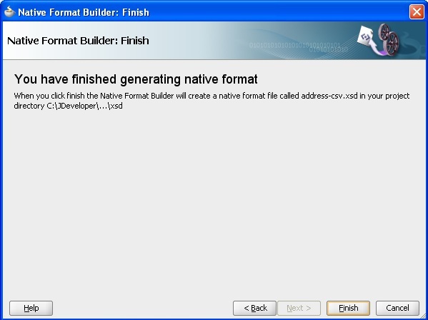

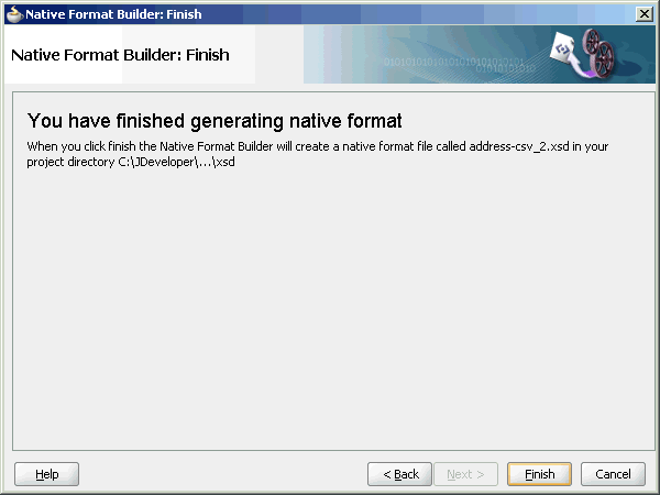

Click Next. The Native Format Builder Finish page is displayed, as shown in Figure 4-15.
Click Finish. The Adapter Configuration Wizard Messages page is displayed, containing the generated NXSD, as shown in Figure 4-16.
In this use case, the Native Format Builder uses order.txt, a
complex type file, which contains multiple record types such as order, customer, and items.
Also, using this use case you can generate the NXSD and test it. Perform the following steps
In this use case, the Native Format Builder uses address.txt, a complex type file, which contains multiple records with different addresses. In this use case, you would build a schema which has 2 record types. The RecOne record takes data for records ending with text "YES" and the RecTwo record takes data for records ending with text "NO ".
Defining Array Type Schema for a Complex File Structure
In this use case, the Native Format Builder uses array.txt, a
complex type file, which contains an array of items. The sample data has four names which
are separated by a semicolon and ending with a period. In this use case, you would create a
schema with array type which has member names separated by a semicolon and array terminated
by a period. Also, using this use case you can generate the NXSD and test it.

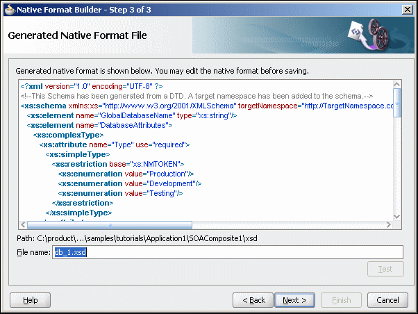

Defining the Schema for a DTD File Structure
This use case takes you through the procedure for defining the schema for the native data type, DTD file.
Use the DTD to be converted to XSD option in the Native Format Builder wizard when creating the XML schema for this native file.
In this use case, the Native Format Builder uses a DTD file type *.dtd. You can generate the corresponding NXSD and also test it. Perform the following steps to run the use case:

Command Line Tool for Testing NXSD Translator
You might want to test your nXSD schema to ensure that nXSD annotations are correct and that generated XML/native data conforms to your business semantics.
To test your nXSD schema, write a BPEL process with an inbound or outbound File Adapter partner link, or both, configured with the appropriate nXSD schema and test them on the SOA server. This is both time-consuming and error prone. A simple standalone test client is available that can enable you to verify your nXSD schemas. You can download the test tool jar from http://download.oracle.com/otndocs/test-translator.jar
Running the Test Tool
Learn how to run the test tool
Prerequisites
Before you use the test client to verify your nXSD schemas, add the following jars in the classpath. These jars (except for test-translator.jar) are available as a part of your SOA installation. You must use Java 6 to run the test client.
bpm-infra.jar. This is the nXSD runtime jar available under$SOA_HOME/soa/modules/oracle.soa.fabric_11.1.1 -
xmlparserv2.jar. This is the Oracle XDK library for parsing available under$FMW_HOME/oracle_common/modules/oracle.xdk_11.1.0 -
xml.jar. This is the Oracle XDK library for schema validation available under$FMW_HOME/oracle_common/modules/oracle.xdk_11.1.0 -
mail.jar. This is the Java mail API. -
test-translator.jar. You must rename the extension fromjarrtojar.
Now you can run java xlator.util.Translate -help and the usage should be displayed as shown in Figure 4-71. When supply the -help option, the tool supplies a list of options and defaults.
Figure 4-71 Running java xlator.util.Translate -help
Description of "Figure 4-71 Running java xlator.util.Translate -help"

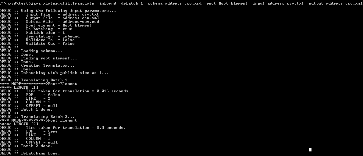

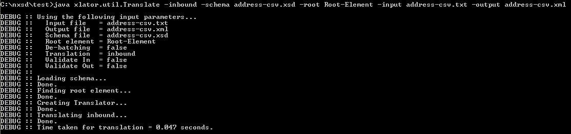

The following example sample execution of the test client converts the
address-csv.txt file to address-csv.xml.
The command is:
java xlator.util.Translate -inbound -schema address-csv.xsd -root Root-Element -input address-csv.txt -output address-csv.xmlFigure 4-72 Using the Test Tool to Convert txt to xml
Description of "Figure 4-72 Using the Test Tool to Convert txt to xml"
Sample execution of the test client to convert address-csv.xml to
address-csv.txt:
java xlator.util.Translate -outbound -schema address-csv.xsd -root Root-Element -input address-csv.xml -output address-csv.txt
Figure 4-73 Using the Test Tool to Convert xml to txt
Description of "Figure 4-73 Using the Test Tool to Convert xml to txt"
The following sample execution of the test client converts
address-csv.txt to a series of
address-csv.xml_batch_%SEQ%.xml files using debatching.
java xlator.util.Translate -inbound -debatch 1 -schema address-csv.xsd -root Root-Element -input address-csv.txt -output address-csv.xml
Figure 4-74 Using the Test Tool to Convert address-csv.txt to a Series of batch xml Files
Description of "Figure 4-74 Using the Test Tool to Convert address-csv.txt to a Series of batch xml Files"

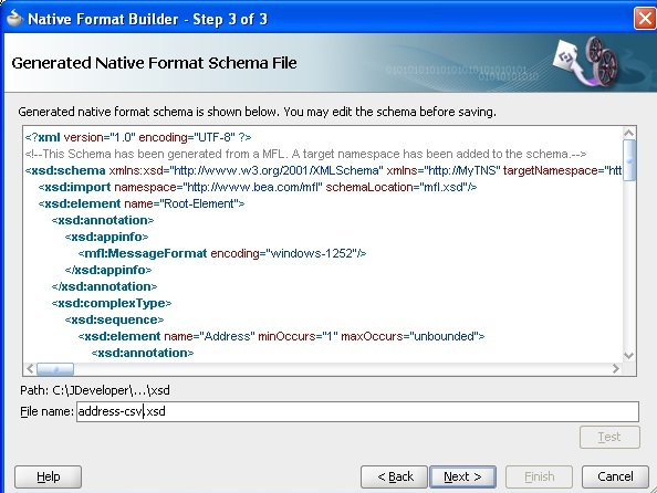

Using the Native Format Builder to Perform MFL Conversion
Oracle WebLogic integration uses a specific XML file format, called MFL format Language, which is a proprietary language that describes native data. MFL is an XML but not a schema file, and MFL cannot be used for SOA transformation/mapping without a an nXSD file.
The MFL conversion feature provides pluggability of MFL in the existing framework, and generates schema corresponding to the MFL format. You can then use the generated schema at runtime.
See the Open Service Bus documentation on MFL, "Defining Data Structures with Message Format Language" in Developing Services with Oracle Service Bus.
To accomplish the first step, you tell JDeveloper to convert MFL to NXSD Schema files.
Generating the Schema File and Adding it to the SOA Composite Process
You then use JDeveloper to generate the schema file, which is consumed by the Native Format Builder translator. Because MFL files do not have a target namespace associated with them, you must provide the target namespace for the generated schema file.
If you saved the generated schema file in SOA Project XSD directory when converting the MFL to Schema files, you can skip this step.
If you have generated the schema file in a directory other than that of SOA Project, you must add the schema file generated in Step 1 to the SOA Composite Project's XSD folder.
Once you have added the schema file to the SOA Project, you can use this schema file as you would use any schema file in the project for payload transformation or payload mapping to a variable. The translator runtime uses the attributes defined in the schema file to invoke the MFL Translator at runtime.

Native Format Builder Wizard Flow for MFL File Conversion
To use the Native Format Builder Wizard to convert MFL files and generate a schema from them, perform the following steps:
Click Finish to complete the generation of schema file from the MFL file. The generated schema file is saved at the desired location.

Refer to Figure 4-79 for an illustration of the schema for the use cases, and to Table 4-11 for a description of the use cases. The description includes a list of the fields
Figure 4-79 Schema for Terminated Use Cases
Description of "Figure 4-79 Schema for Terminated Use Cases"

See Figure 4-81 for an illustration of the schema for the use cases and Table 4-13.
Figure 4-81 Shared Delimiter Surround Schema
Description of "Figure 4-81 Shared Delimiter Surround Schema"
