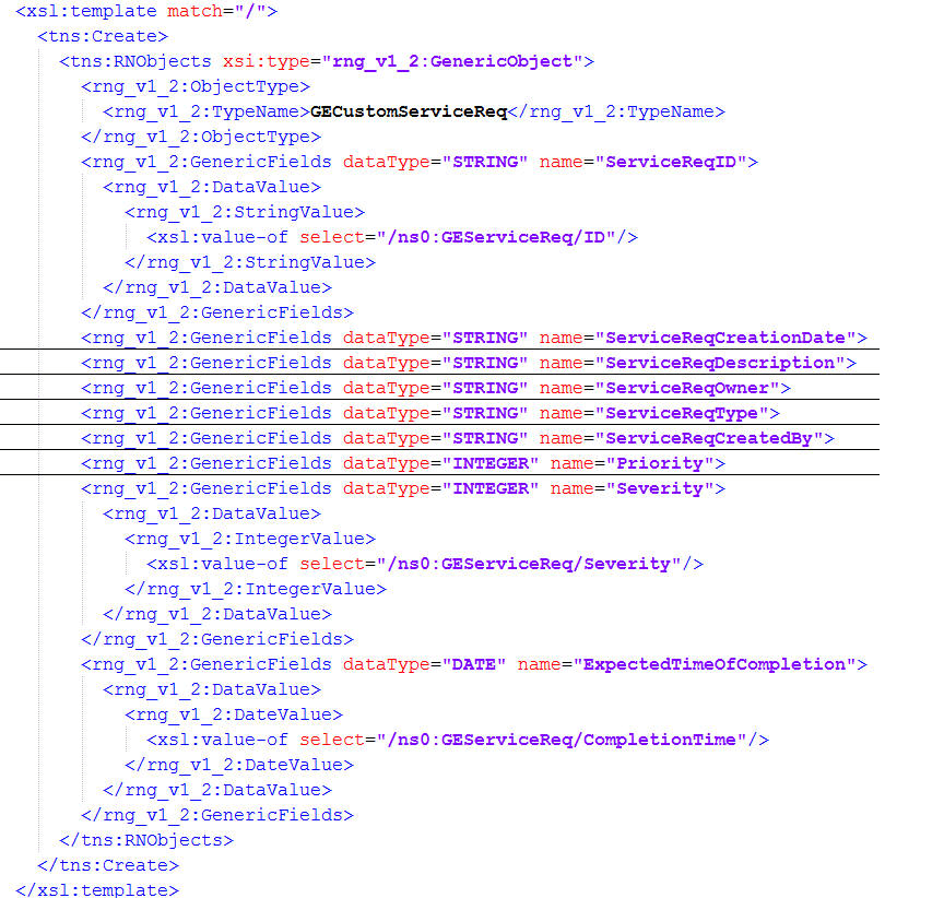

4.2.1.1 Example: Mapping an Object without Using an Oracle RightNow Adapter
This section provides information about creating a custom object instance without using the Oracle RightNow adapter. In this scenario, you create a SOA Composite and use the Web Service adapter to create a client for RightNow Service. The steps follow that are required when you create a data mapping using XSLT mapper from a client source schema to a custom object schema.
See Figure 4-1.
- In the XSLT editor, on the target schema node RNObject, right-click and select Substitution Type or Element then choose Generic Object.
 - Set Object ObjectType->
TypeName: Value of the RightNow CustomObject Name created in RightNow. - Set GenericFields->
dataType: Data type value of the custom attribute. for example, STRING, or INTEGER. - Set GenericFields->
name: name of the custom attribute. - Set GenericFields->DataValue->
StringValue: Value of the attribute.
Figure 4-1 Using XSLT Mapper to Map a RightNow Custom Object for the Schema without Using the Oracle RightNow Adapter-Generated WSDL
The source view is:

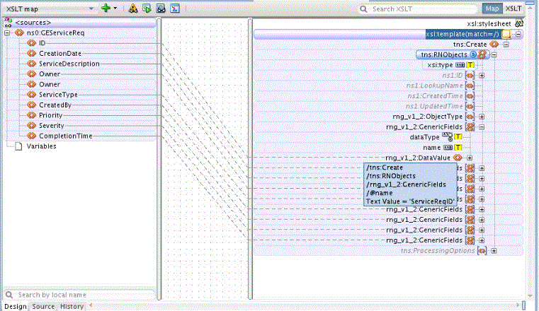

4.2.1.2 Example: Mapping an Object with the Oracle RightNow Adapter
This section provides information about creating a custom object instance with the Oracle RightNow adapter. You create a SOA Composite and use the Web Service adapter to create a client for an integration-friendly Oracle RightNow adapter-generated WSDL.
Use the following steps to create the data mapping using the XSLT mapper from a client source schema to a custom object schema (the schema is strongly typed and referred from the integration-friendly WSDL generated by the Oracle RightNow adapter). The custom object is a first class entity in generated Local WSDL Map the fields directly in the mapper as shown below.
