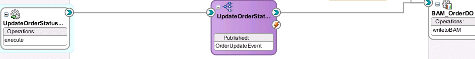

Figure 35-1 shows an OrderBookingComposite project in which a service (UpdateOrderStatus) in the Exposed Services swimlane provides the entry point to the composite and a reference (BAM_OrderDO) in the External References swimlane enables information to be sent to an Oracle BAM Server in the outside world.
Figure 35-1 Service and Reference Binding Components
Description of "Figure 35-1 Service and Reference Binding Components"

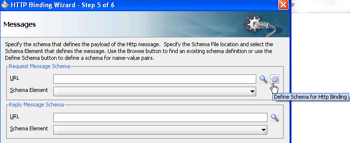

An outbound HTTP binding reference supports only XML as a response from an external HTTP endpoint. The response should contain the correct XML part name according to outbound expectations.
You cannot change the httpBinding property for the HTTP binding component during runtime in Oracle Enterprise Manager Fusion Middleware Control.

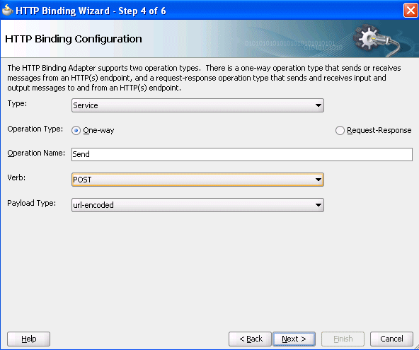

35.1.2.1 Supported Interactions
Table 35-2 shows the supported verbs, payloads, and operations for the inbound and outbound directions.
Table 35-2 Supported Verbs, Payloads, and Operations
| Direction | Verb | Payload Type | Operation | Supported? |
Inbound |
