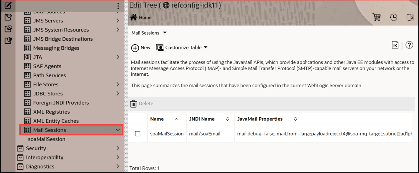

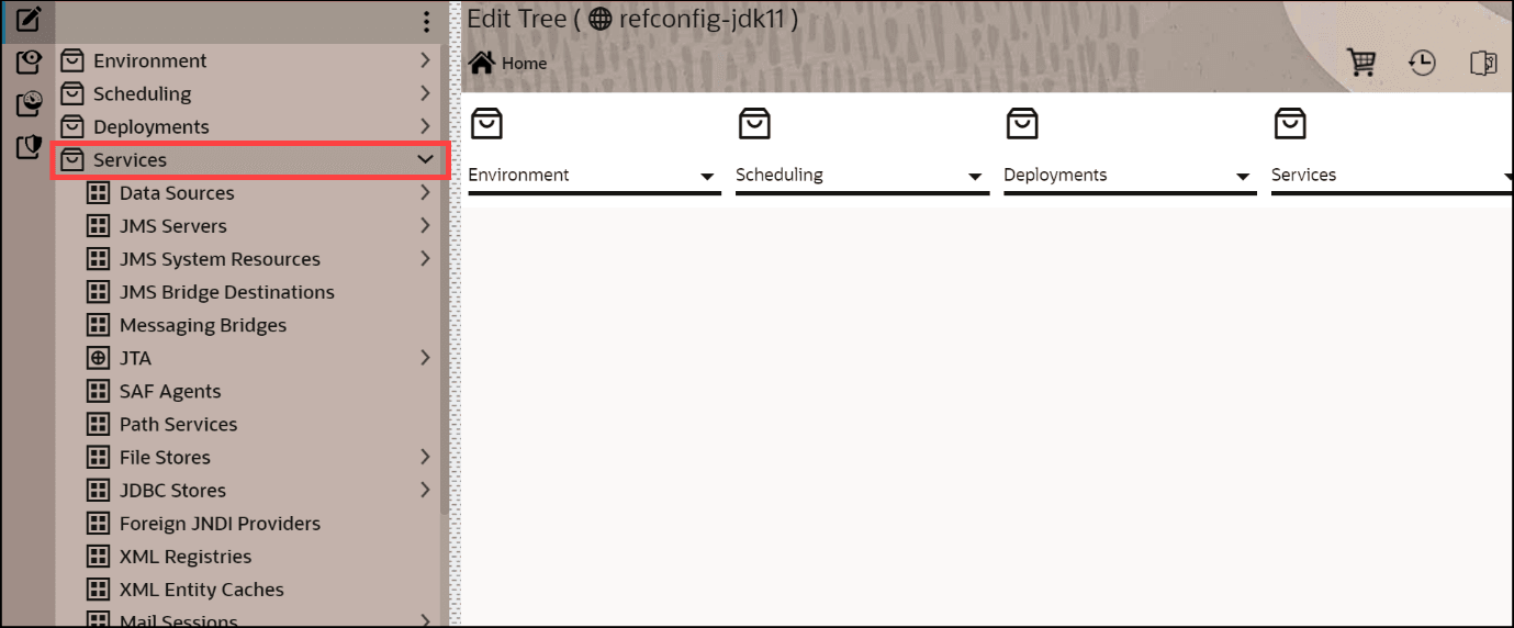

How to Configure Email Notifications for Database Resiliency Thresholds
  1. Log in to the Oracle WebLogic Server Administration console.
  2. Under Domain Structure in the left pane, expand Services.
  3. Click Mail Sessions, then select soaMailSession.
  4. Click Configuration under Settings for soaMailSession on the right side.
  5. Configure session username, password, and JavaMail properties.
  6. Under Domain Structure, expand Diagnostics in the left pane.
  7. Click Diagnostic Modules, then select Module-SOADFW.
  8. Click the Policies and Actions tab, then select the Actions tab.
  9. Click soaDBResiliencyDisableEmailNotification and select the SMTP Properties tab, then set the E-mail Recipients property.
    Repeat for soaDBResiliencyQuiescingEmailNotification, soaDBResiliencyUnQuiescingEmailNotification, and soaDBResiliencyWarningEmailNotification notifications.

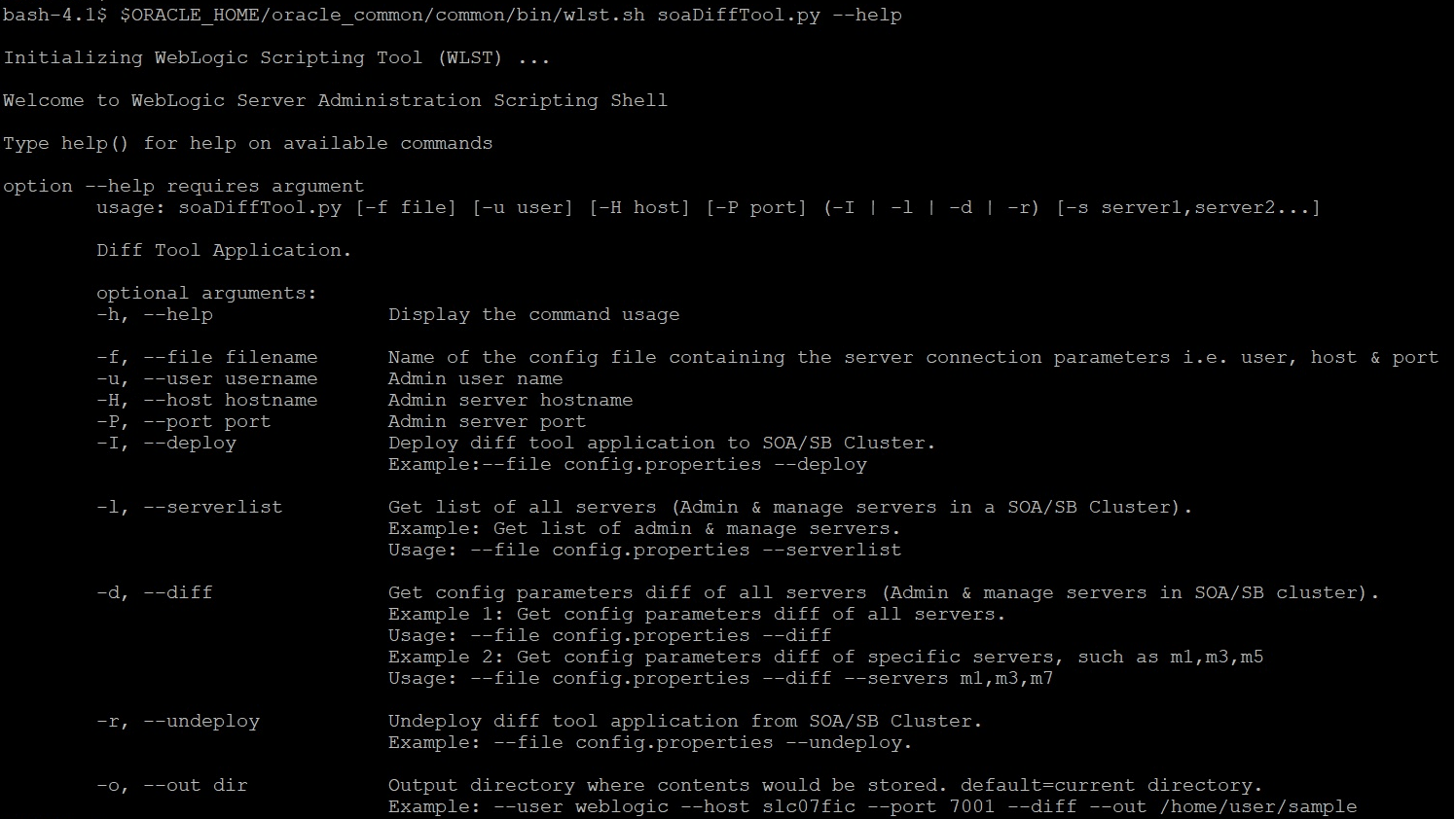

Using the DiffTool Utility for Checking Reference Configuration Domain Settings
You can use the DiffTool utility to check whether your SOA project properties match the Reference Configuration domain property values. The DiffTool utility provides a JSON report that lists the settings in the current domain and provides the configured settings for a Reference Configuration domain.
To run the DiffTool utility:
  1. Open a command prompt and enter:
    cd $ORACLE_HOME/soa/common/tools/difftool
  2. Enter the following command:
    $ORACLE_HOME/oracle_common/common/bin/wlst.sh soaDiffTool.py
    Optionally, enter additional arguments:DiffTool Utility arguments
  3. In the JSON report output, review the settings for the current domain and the settings provided for a configured Reference Configuration domain. For more information, see Configured Reference Configuration Domain Settings.

Configure the Sender Details
To configure the sender details, perform the following steps in the Remote WebLogic server console.
  1. Click Edit Tree on the left navigation pane and select Services.
  2. Under Services, select Mail Sessions.
    The Mail Sessions table displays information about the mail sessions that have been configured in the current remote WebLogic Server domain.
  3. Under Mail Sessions, select soaMailSession. In the General tab, configure the sender details with the following values.
    Field Information to Enter
    JNDI Name This value is pre-filled with mail/soaEmail.
    Session Username Enter the desired username credentials for the mail session.
    Session Password/Confirm Session Password Enter and confirm the desired password credentials for this new mail session.
  4. Save the changes.

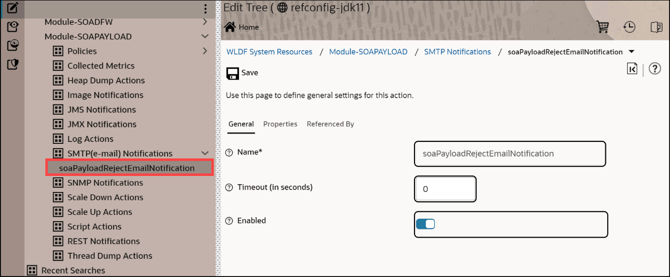

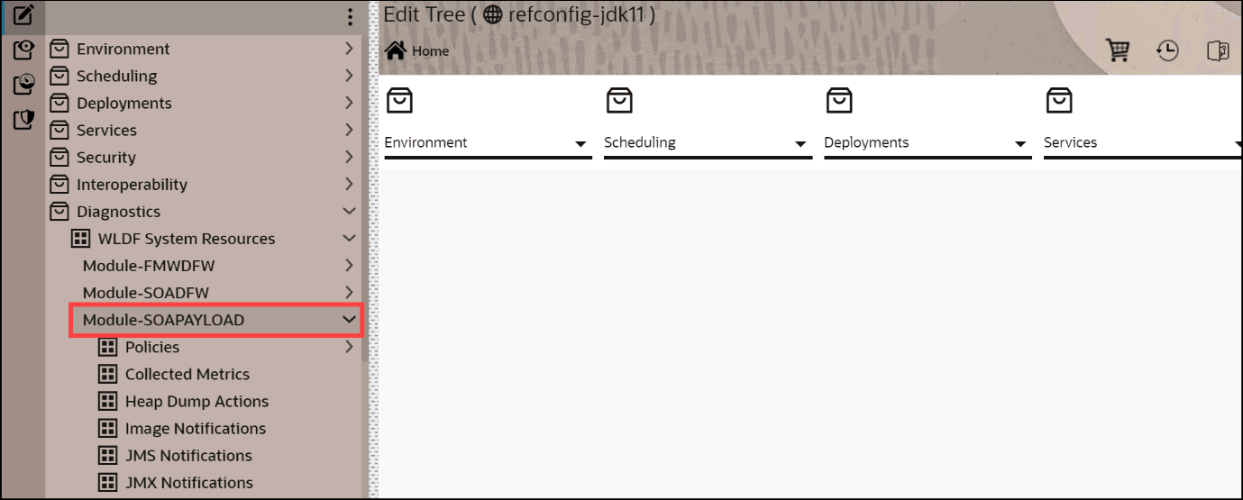

  1. Click Edit Tree on the left navigation pane and select Diagnostics. Under Diagnostics, select WLDF System Resources, and then select Module-SOAPAYLOAD.
    The Module-SOAPAYLOAD module is automatically configured in the reference configuration environment.

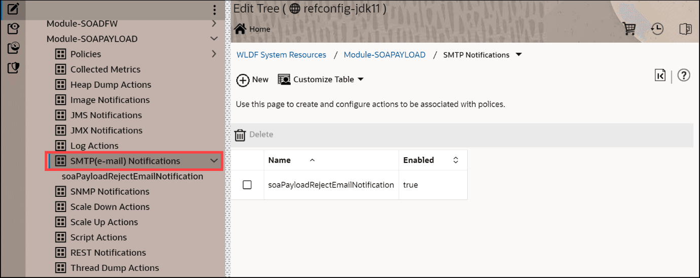

  2. Under Module-SOAPAYLOAD, select SMTP(e-mail) Notifications.
  3. Further, select soaPayloadRejectEmailNotification action.

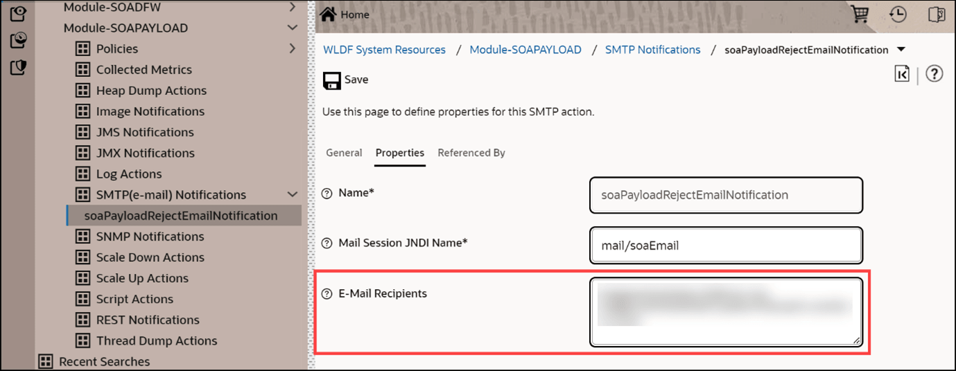

  4. In the soaPayloadRejectEmailNotification page, navigate to the Properties tab. Edit the details and update E-Mail Recipients value.
    Save the changes.
