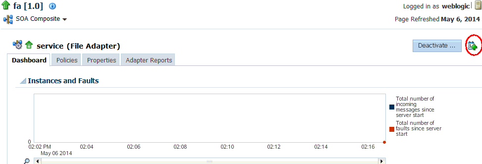

Monitor the instances and faults for an inbound adapter:
The Dashboard page is, by default, selected once you select the composite under soa-infra.
Select the Flow instance tab. Under that the Instances with Faults Section is displayed. You can view the instances and faults within the Instances and Faults section.
The details of the fault is displayed in a line chart in the Instances and Faults section, which you can search within to find recent faults. This line chart shows the total number of outgoing messages since the start of the server, and the total number of faults since the start of the server.

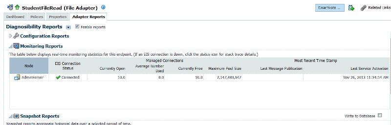

Monitoring Report
Within a Monitoring report, showing real-time monitoring statistics, the activation spec provides configuration-related information, including:
EIS connection configurations, displayed as connection factory properties.
Resources that are being accessed. These include Managed Connections and the Most Recent Timestamp for such connections.
Additional tuning information, such as Currently Free Connections and Maximum Pool Size for Connections.
Figure 28-1 shows the appearance of the Monitoring report in the context of the Diagnosability and Snapshot reports. This report shows a information related to a service endpoint.
Figure 28-1 Monitoring Report Showing Statistics for a Service Endpoint
Description of "Figure 28-1 Monitoring Report Showing Statistics for a Service Endpoint"
See Figure 28-1 for a description of the elements in the Monitoring Report.

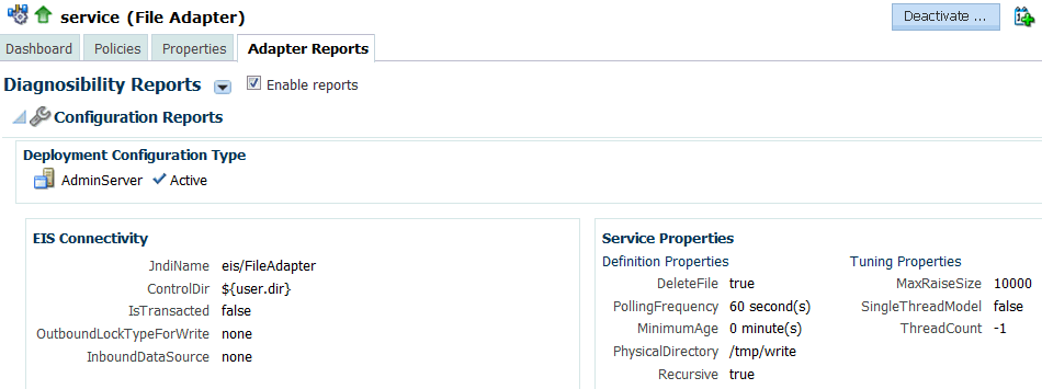

The Configuration report within the Diagnosability Report from the Oracle Enterprise Manager Fusion Middleware Control dashboard shows a summary of connection factory, binding and activation properties for a specific service endpoint.
Figure 28-2 shows an Adapter Configuration Report for a Service Endpoint, showing Deployment Configuration Type, and information about EIS Connectivity and Service Properties, including definition properties and Tuning Properties, in this case properties that are specific to a File Adapter.
See Table 28-2 for a description of the elements in the Adapter Configuration Report.
Note that you need to select Related Links (at the top right of the page) to initiate the process of configuring a connection factory within the Oracle WebLogic Remote Console.
Table 28-2 Adapter Configuration Reports Elements
| Element | Description |
                                        Deployment Configuration Type  |
                                        Indicates if the endpoint is part of an active-active or active-passive configuration. This is only displayed for a service endpoint.  |
                                        EIS Connectivity  |
                                        Provides information about connection factory properties related to this endpoint and its connection to the Enterprise Information System.  |
                                        Service Properties  |
                                        Lists Definition Properties, used to define services specific to this endpoint, and Tuning Properties, used to tune services specific to this endpoint. For Reference Endpoints, there are Reference Properties which include Definition Properties and Tuning Properties. See the User's Guide to Technology Adapters appendix for the complete list and definitions of the properties.  |

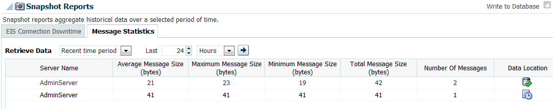

Figure 28-3 shows an example Snapshot Report, with the Message Statistics tab selected. The Report shows:
Data will be retrieved over the last 24 hours
The name of the server for which information is being collected
Average Message Size, in bytes
Maximum Message Size, in bytes
Minimum Message Size, in bytes
Total Message Size, in bytes
Number of Messages
Data Location, specifying Persisted or In-Memory, as indicated by an icon and tooltip
Write to Database-enables data persistence. By default, the data is not persisted. Note that when enabled, persistence is enabled concurrently for both EIS Connection statistics and Message statistics at once. Once you enable persistence, the value for writes to the database is displayed (for example, "every 15 minutes".)
Figure 28-3 Snapshot Report, with Message Statistics Tab Selected

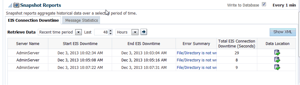

Figure 28-4 shows an example Snapshot Report, with EIS Connection Downtime, or the down shown. The Report shows:
Server Name
The Start EIS Downtime-when the connection downtime began
The End EIS Downtime-when the connection downtime ended
Error Summary-A summary of the errors that might be related to the downtime.
Total EIS Connection Downtime.
Show XML button, which when clicked on provides XML data for the information that is displayed.
Figure 28-4 Snapshot Report with EIS Connection Downtime Tab Selected
Description of "Figure 28-4 Snapshot Report with EIS Connection Downtime Tab Selected "

You can search and retrieve past data. Therefore, the Retrieve Data search control is always available for data that persists. The search feature is specific to Enterprise Information System (EIS) Connection statistics and is distinct from Message statistics.

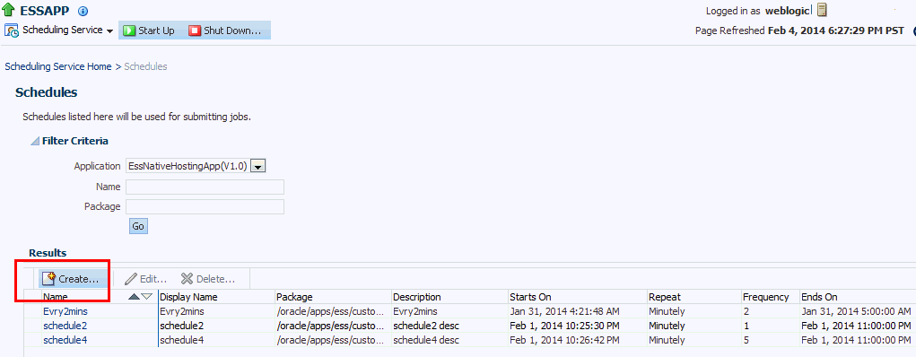

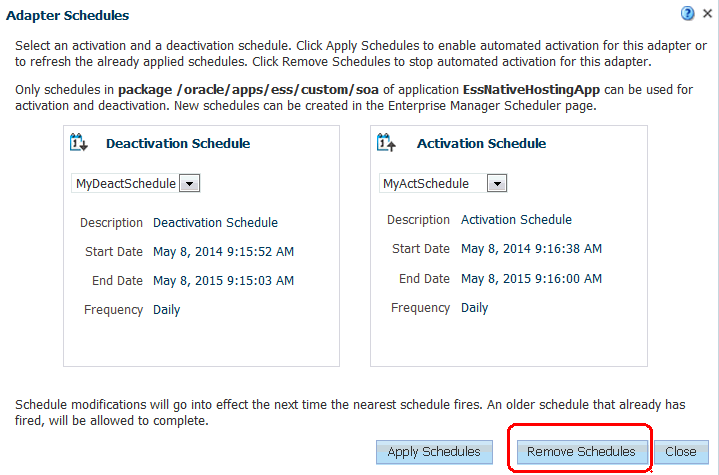

Scheduling JCA Adapter Endpoint Activation and Deactivation using Oracle Enterprise Scheduler
You can schedule activation and deactivation of the SOA composite JCA Adapter Services from Oracle Enterprise Manager Fusion Middleware Control.
Using Oracle Enterprise Scheduler schedule metadata you provide, you can:
Schedule a request for composite JCA Adapter service activation.
Schedule a request for composite JCA Adapter service deactivation.
Oracle Enterprise Manager Fusion Middleware Control also displays the current state of an Adapter endpoint (composite service), which can be either active or inactive.
You can also edit existing metadata to alter your schedule, and you can remove schedules for Adapters.
Because the Oracle Enterprise Scheduler installation is optional, this feature is not be available if the Oracle Enterprise Scheduler is not installed.

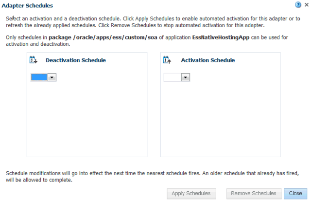

Follow these steps to schedule activation and deactivation of the SOA composite JCA Adapter Services:

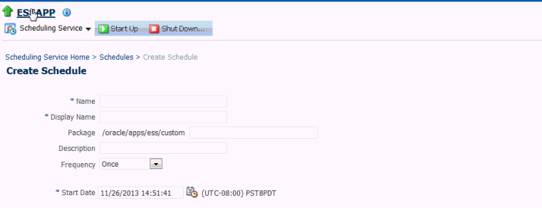

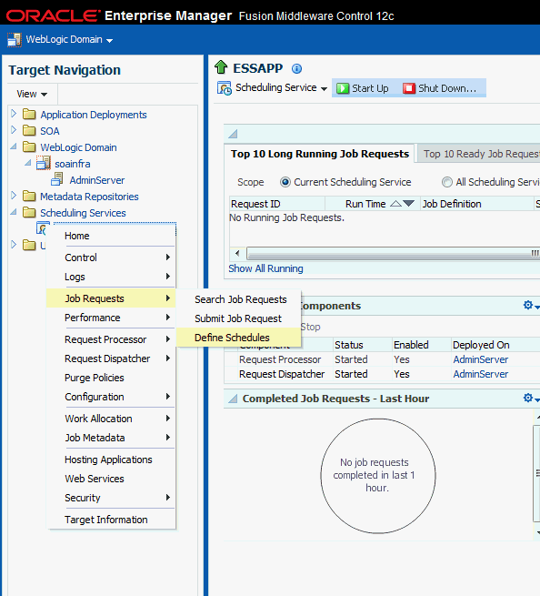

Create the Schedule Metadata
To create the schedule metadata, you fill in a form by selecting Define Schedules. The form populates the metadata.

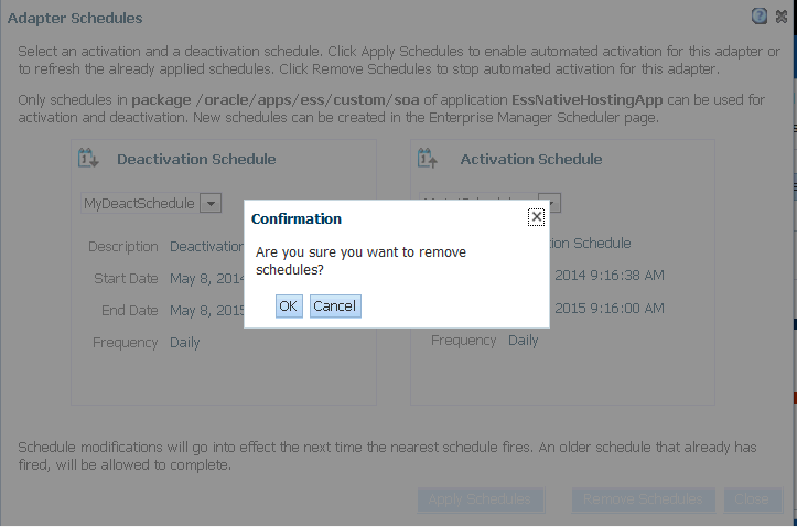

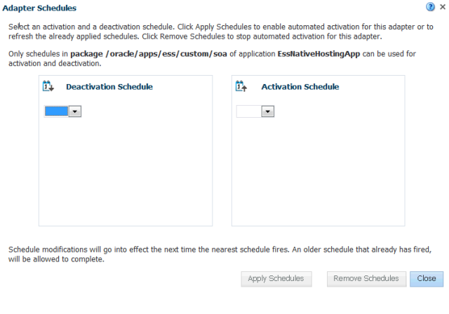

Use the Created Schedule Metadata to Schedule the Deactivation and Activation of a SOA Composite JCA Adapter
You next use the metadata you have created to schedule the deactivation and activation of an Adapter.

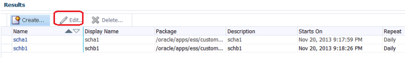

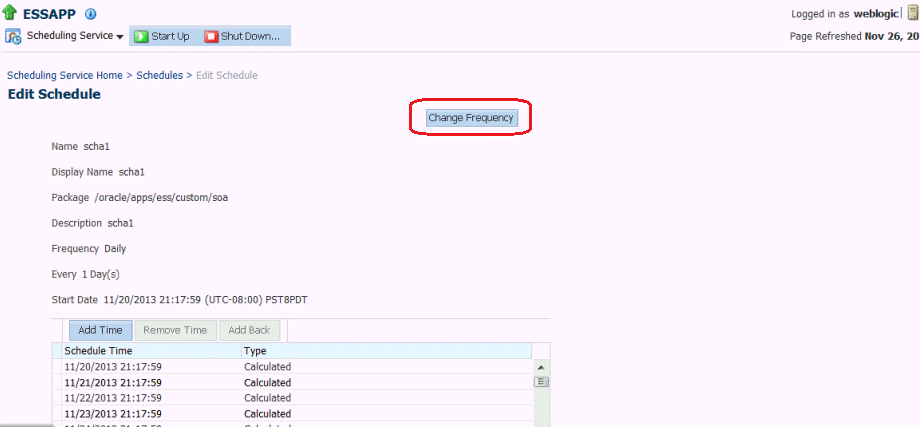

Editing Oracle Enterprise Scheduler Schedule Metadata
You can edit existing metadata you have created using the Oracle Enterprise Scheduler/Oracle Enterprise Manager Fusion Middleware Control page. To do so:
