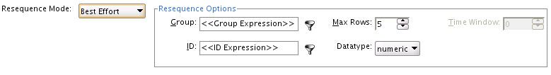

On the Mediator Editor under either the Mediator component or the operation you want to configure, select Best Effort from the Resequence Mode dropdown list.
The Resequence Options box appears and includes the option for the standard resequencer, as shown in Figure 23-6.
Figure 23-6 Oracle Mediator with Resequence Mode set to Best Effort
Description of "Figure 23-6 Oracle Mediator with Resequence Mode set to Best Effort" -
Fill in the fields listed in Table 23-7 to configure the best effort resequencer.
