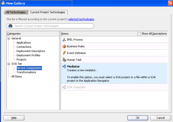

To create a Mediator in an existing project:
In the Applications window, select the project to which you want to add a Mediator.
Right-click in the navigator pane and select New.
Under Categories, select Service Components, and then select Mediator from the Items list, as shown in Figure 19-4.
Figure 19-4 New Gallery Dialog with Mediator Service Component
Description of "Figure 19-4 New Gallery Dialog with Mediator Service Component" -
Click OK.
The Create Mediator dialog appears.
Configure the Mediator interface, as described in Configuring the Mediator Interface Definition.
Define routing rules for the Mediator, as described in Creating Oracle Mediator Routing Rules.
