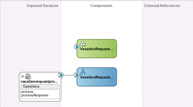

The Human Task icon appears in the SOA Composite Editor above the BPEL process, as shown in Figure 31-4.
Figure 31-4 Human Task Icon in SOA Composite Editor
Description of "Figure 31-4 Human Task Icon in SOA Composite Editor" - Double-click the Human Task icon.
The Human Task Editor appears. You are now ready to begin design of your human task.
