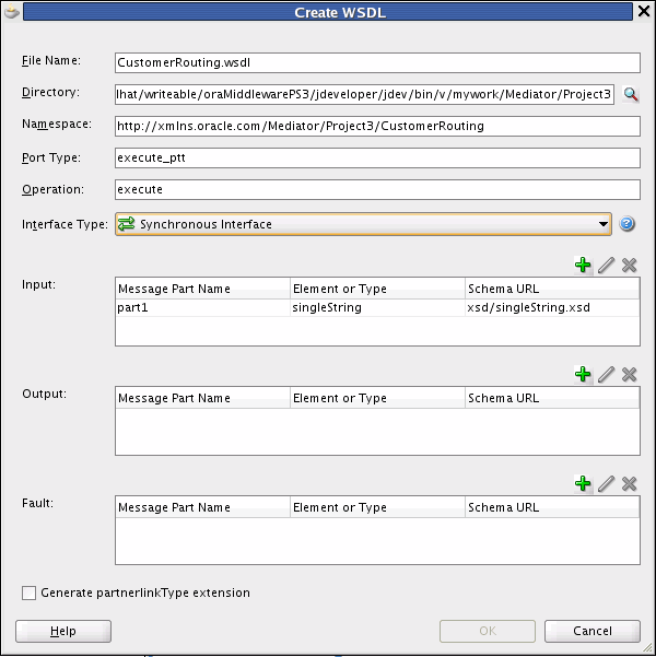

To generate a WSDL file for a synchronous interface from an XSD file:
Perform these steps after the Create WSDL dialog appears when you are creating a Mediator or when you are defining a service for a Mediator.
On the Create WSDL dialog, enter the information for the properties listed in Table 19-2.
In the Interface Type field, select Synchronous Interface.
The Input, Output, and Fault fields appear, as shown in Figure 19-24.
Figure 19-24 Create WSDL Dialog for a Synchronous Interface
Description of "Figure 19-24 Create WSDL Dialog for a Synchronous Interface" -
Repeat the same steps to define message parts for the Output and Fault fields.
The output represents the response message and is required in synchronous transactions. Faults are optional.
Click OK.
Partner link types are generally used in BPEL, so you do not need to select Generate partnerlinkType extension for Mediator.
