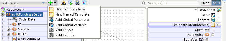

  1. Right-click any node in the source pane, and select Add Global Parameter from the context menu.
    Alternatively, click the Add icon, identified by the green plus sign, in the XSLT toolbar, and select Add Global Parameter. Figure 41-42 shows the XSLT toolbar, which resides at the top of the XSLT Map Editor.
    Figure 41-42 Adding Global Parameter from the XSLT Toolbar
    Description of Figure 41-42 follows
    Description of "Figure 41-42 Adding Global Parameter from the XSLT Toolbar"
    You can also right-click anywhere on the canvas (center) pane, and select Create > Add Global Parameter from the context menu.

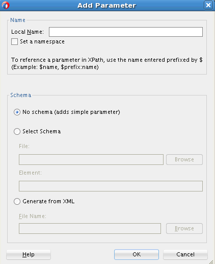

    The Add Parameter dialog appears. Figure 41-43 shows the Add Parameter dialog.
    Figure 41-43 Add Parameter Dialog
    Description of Figure 41-43 follows
    Description of "Figure 41-43 Add Parameter Dialog"
  2. Enter a Local Name for the parameter and optionally specify a namespace.
    If the parameter is a complex parameter, you can specify a schema and an element definition for the parameter. Click the Help button in the dialog to get more information on the individual fields.
  3. Click OK in the Add Parameter dialog to create the parameter.
