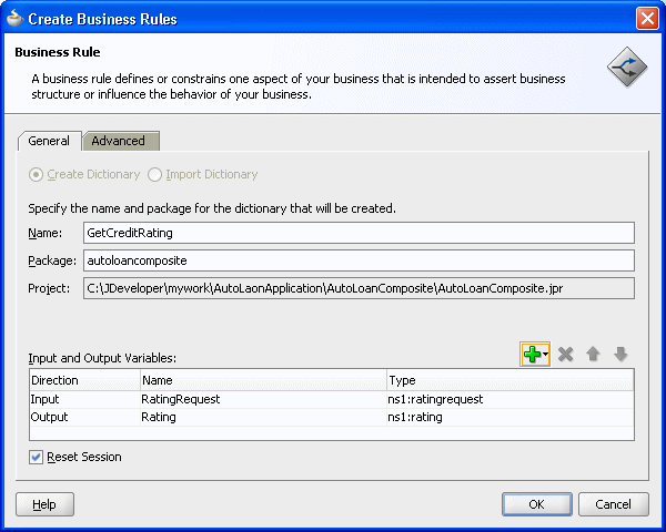

This displays the Create Business Rules dialog, as shown in Figure 25-10.
Figure 25-10 Create Business Rules Dialog with Input and Output Variables
Description of "Figure 25-10 Create Business Rules Dialog with Input and Output Variables"
