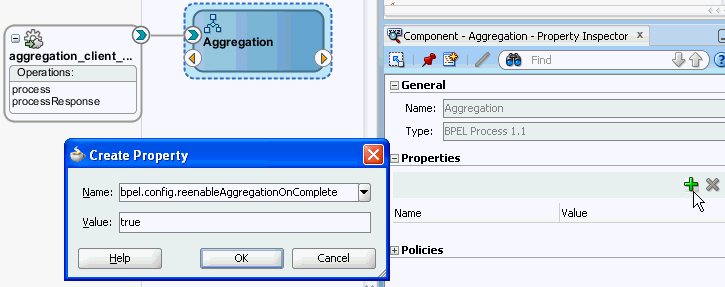

To configure BPEL process instance creation:
- In the SOA Composite Editor, select the BPEL process service component, as shown in Figure 9-16.
Figure 9-16 Selected BPEL Process Service Component
Description of "Figure 9-16 Selected BPEL Process Service Component" - Go to the Property Inspector in the lower right corner of Oracle JDeveloper. If the Property Inspector is not displayed, select Property Inspector from the View main menu.
- In the Properties section, click the Add icon, as shown in Figure 9-17.
The Create Property dialog is displayed.
- In the Name field, enter the
bpel.config.reenableAggregationOnCompletedeployment descriptor property. The prefix ofbpel.configis required for this type of deployment descriptor. - In the Value field, enter
true, as described in Table 9-12.Table 9-12 reenableAggregationOnComplete Property Settings

Figure 9-18 shows the completed Create Property dialog.
- Click OK.
The
reenableAggregationOnCompleteproperty with thebpel.configprefix looks as follows in thecomposite.xmlfile.<composite name="Aggregation" revision="1.0" label="2011-07-10_13-52-24_174" mode="active" state="on"> . . . . . . <component name="Aggregation" version="1.1"> <implementation.bpel src="Aggregation.bpel"/> <property name="bpel.config.reenableAggregationOnComplete" type="xs:string" many="false" override="may">true</property> </component> . . . . . . </composite>
