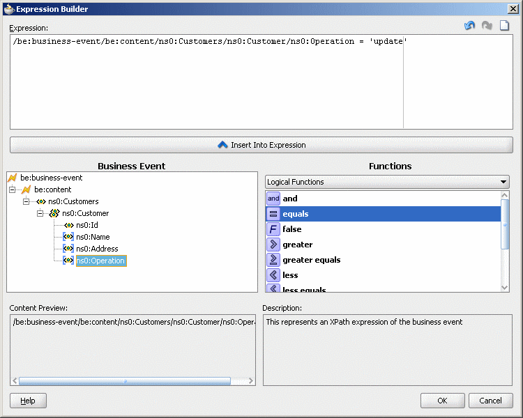

To filter the event, double-click the Filter column of the selected event, or select the event and then click the filter icon (first icon).
The Expression Builder dialog appears.
In the Expression field, enter an XPath expression and click OK.
Figure 19-11 shows a sample Expression Builder dialog.
The expression you created appears in the Filter column of the Create Mediator dialog.
