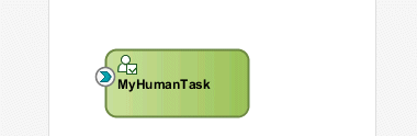

To create a human task service component that you later associate with a BPEL process service component, do not select the Create Composite Service with SOAP Bindings check box. The human task service component is created as a component that you explicitly associate with a BPEL process service component. Figure 28-2 provides details.
To create the human task service component as a standalone component in the SOA Composite Editor, select the Create Composite Service with SOAP Bindings check box. This creates a human task service component that is automatically wired to a Simple Object Access Protocol (SOAP) web service. Figure 28-3 provides details.
Figure 28-3 Standalone Human Task Component
Description of "Figure 28-3 Standalone Human Task Component"This web service provides external customers with an entry point into the human task service component of the SOA composite application.
