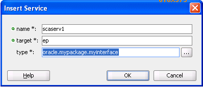

Drag a Service icon into the spring editor.
The Insert Service dialog appears.
Complete the fields shown in Table 56-1 to define the target bean and Java interface.
Table 56-1 Insert Service Dialog
Field Description name
Enter a name.
target
Enter the target bean. This action enables you to expose the bean as a service.
Note: Ensure that this target exists. There is no validation support that checks for the existence of this target.
type
Enter the Java interface.
When complete, the Insert Service dialog looks as shown in Figure 56-4.
Click OK.
The target bean becomes the service interface in the spring context.

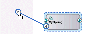

A handle is added to the right side of the spring service component, as shown in Figure 56-7.
Drag the left handle into the Exposed Services swimlane to create a service binding component, as shown in Figure 56-8.

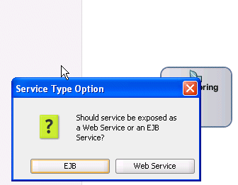

You are prompted to select to expose the service as either a web service or as an EJB service, as shown in Figure 56-9.
EJB: This exposes the EJB service through a Java interface; this selection does not require the use of a WSDL file.
Web Service: This exposes the web service through a SOAP WSDL interface. If you select this option, a WSDL is generated from the Java Interface for compatibility with the spring service component.
Select to expose this service as either an EJB or web service. A service is automatically created in the Exposed Services swimlane and wired to the spring service component (for this example, EJB is selected). Figure 56-10 provides details.

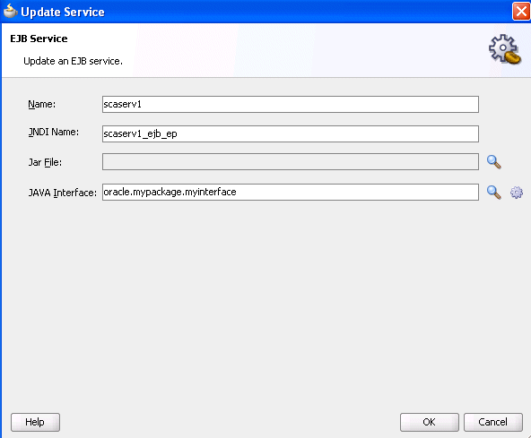

Double-click the EJB service to display the automatically completed configuration, as shown in Figure 56-11. The configuration details were created from the values you entered in the Insert Service dialog in Step 7.
Figure 56-11 EJB Service Dialog in Exposed Services Swimlane

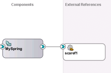

Drag the right handle of the spring service component into the External References swimlane to create a reference binding component.
You are prompted with the same spring type option message as shown in Step 13.
Select an option to expose this reference. A reference is automatically created in the External References swimlane and wired to the spring service component (for this example, EJB is selected). Figure 56-12 provides details.

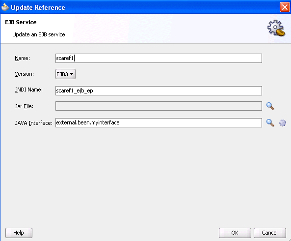

Double-click the EJB reference to display the automatically completed configuration, as shown in Figure 56-13. The configuration details were created from the values you entered in the Insert Reference dialog in Step 11.
Figure 56-13 EJB Reference Dialog in External References Swimlane
Description of "Figure 56-13 EJB Reference Dialog in External References Swimlane" -

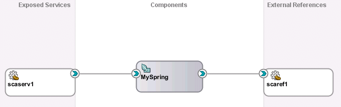

Close the dialog and return to the SOA Composite Editor, as shown in Figure 56-14.
Figure 56-14 Java Interface-Based EJB Service and Reference Binding Components
Description of "Figure 56-14 Java Interface-Based EJB Service and Reference Binding Components" -

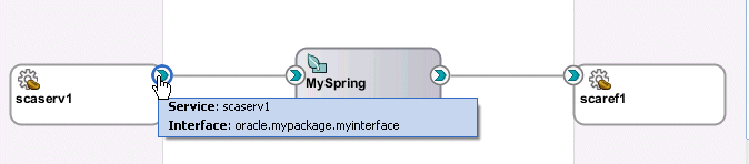

Place the cursor over both the right handle of the service (as shown in Figure 56-15) and the left handle of the spring service component (as shown in Figure 56-16). The Java interface is displayed.
Figure 56-16 Java Interface of Spring Service Component
Description of "Figure 56-16 Java Interface of Spring Service Component" -

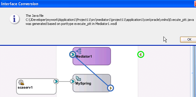

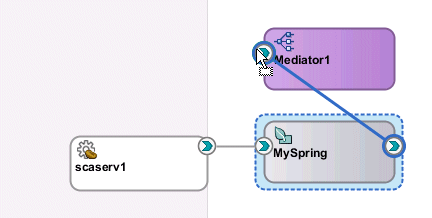

If you wire the right handle of the spring service component to an XML-based component such as Oracle Mediator instead of the Java interface-based EJB reference, a Java interface is generated from the Oracle Mediator's existing WSDL interface. The following steps provide details.
Drag the right handle of the spring service component to the Oracle Mediator, as shown in Figure 56-17.
Figure 56-17 Integration of Spring Service Component and Oracle Mediator
Description of "Figure 56-17 Integration of Spring Service Component and Oracle Mediator" -
Click OK when prompted to acknowledge that a compatible interface was created from the Oracle Mediator WSDL file.
Figure 56-18 Java File Creation from the Oracle Mediator WSDL File

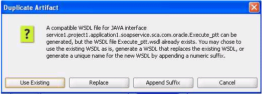

Description of "Figure 56-18 Java File Creation from the Oracle Mediator WSDL File"If you drag a wire between a Java interface and a WSDL-based component, and the WSDL file with the default name (based on the Java Interface name) already exists, you are prompted with four options. Click Cancel to cancel creation of the wire. Figure 56-19 provides details.

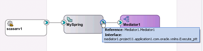

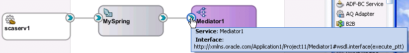

Place the cursor over both the right handle of the spring service component (as shown in Figure 56-20) and the left handle of the Oracle Mediator (as shown in Figure 56-21) to display the compatible interface.
Figure 56-20 Spring Service Component Interface
Description of "Figure 56-20 Spring Service Component Interface" -
