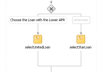

bpws:getVariableDate('loanOffer1','payload','/loanOffer/APR') > bpws:getVariableData('loanOffer2','payload','/loanOffer/APR')In this example, two loan offers from completing loan companies are stored in the global variables
loanOffer1andloanOffer2. Each loan offer variable contains the loan offer's APR. The BPEL flow must choose the loan with the lower APR. One of the following switch activities takes place:-
If
loanOffer1has the higher APR, then the first branch selectsloanOffer2by assigning theloanOffer2payload to theselectedLoanOfferpayload. -
If
loanOffer1does not have the lower APR thanloanOffer2, theotherwisecase assigns theloanOffer1payload to theselectedLoanOfferpayload.

- Add and configure additional activities as needed. Figure 11-8 provides details.
