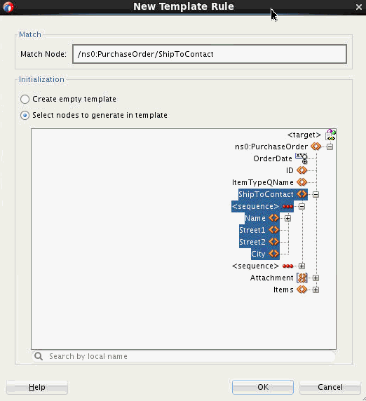

    The New Template Rule dialog appears. Figure 41-47 shows the New Template Rule dialog.
    Figure 41-47 New Template Rule Dialog
    Description of Figure 41-47 follows
    Description of "Figure 41-47 New Template Rule Dialog"
    The New Template Rule dialog contains the following fields:
    • Match Node: Specifies the value for the match attribute in the xsl:template definition.
      The match attribute contains a pattern used to match a node in the input XML document. The XSLT processor executes the instructions within a template when the node it is processing matches the pattern defined in the template match attribute.
    • Initialization Section: Used to determine the content of the new template rule.
      You can choose to select Create empty template to create an xsl:template instruction with no content. Alternatively, you can select Select nodes to generate in template to view and select target schema nodes that you would like to create when the template is executed.
      The Select nodes to generate in template option is available only if a target schema is being used.

  3. Select the content desired in the Initialization section. If you know the output nodes that you would like the template to create, select the Select nodes to generate in template option, and select the output nodes from the target schema tree that is displayed. You can use the Search by local name field to search within the target schema tree. You can select multiple nodes in the target tree by clicking each desired node while holding down the Shift key.
  4. Click OK in the New Template Rule dialog to create the template. A new xsl:template statement is inserted at the end of the XSLT.
