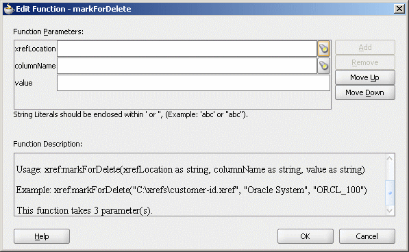

The Edit Function – markForDelete dialog is displayed, as shown in Figure 44-12.
Figure 44-12 Edit Function – markForDelete Dialog
Description of "Figure 44-12 Edit Function – markForDelete Dialog" -
Specify the following values for the fields in the Edit Function – markForDelete dialog:

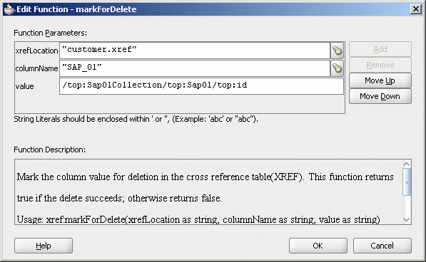

A populated Edit Function – markForDelete dialog is shown in Figure 44-13.
Figure 44-13 Populated Edit Function – markForDelete Dialog
