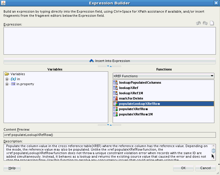

You can access the Expression Builder dialog through an assign activity, an XSL transformation, or the filtering functionality of a BPEL process service component or an Oracle Mediator service component. Figure 44-6 shows how you can select the cross reference functions in the Expression Builder dialog.
Figure 44-6 Expression Builder Dialog with Cross Reference Functions
Description of "Figure 44-6 Expression Builder Dialog with Cross Reference Functions"

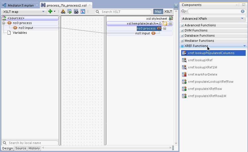

The XSLT Mapper is displayed when you create an XSL file to transform data from one XML schema to another. Figure 44-7 shows how you can select the cross reference functions in the XSLT Mapper.
Figure 44-7 XSLT Mapper Dialog with Cross Reference Functions
Description of "Figure 44-7 XSLT Mapper Dialog with Cross Reference Functions"
