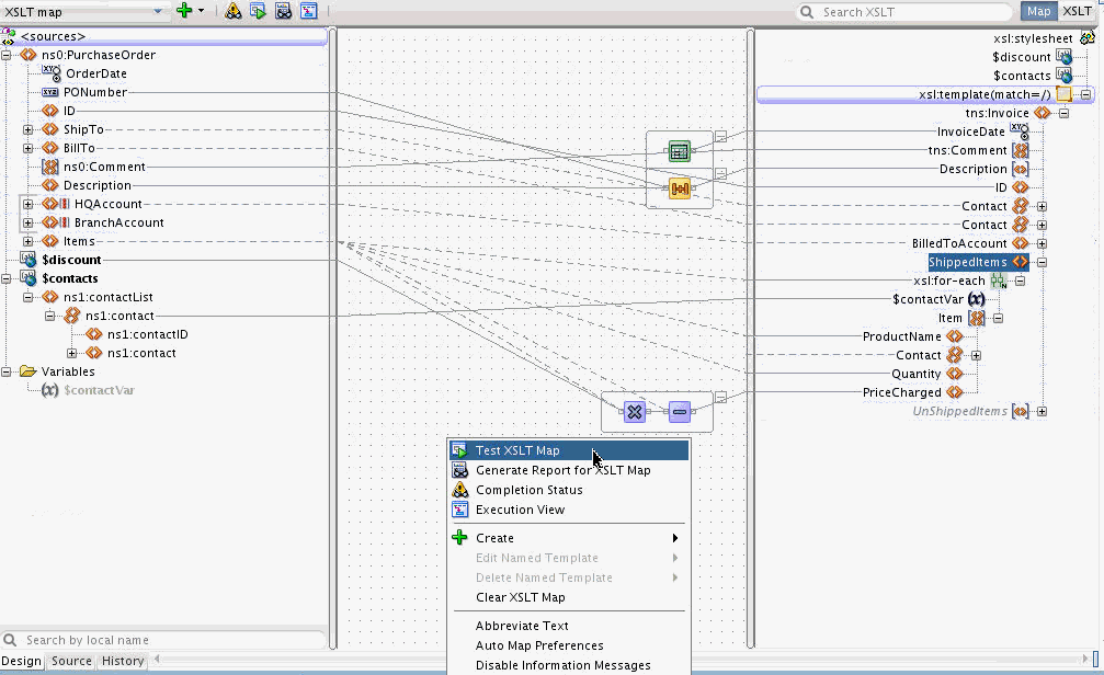

The XSLT Map Editor provides a tool to test the map. To invoke the test tool, right-click the Canvas pane, and select Test from the context menu. You can use the test tool in both Map View and XSLT View.
Figure 41-38 demonstrates launching the Test XSL Map dialog.
