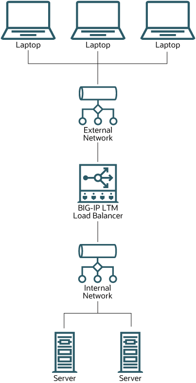

Figure B-1 shows a conceptual view of the BIG-IP system that is setup between external network clients and internal network servers.
Figure B-1 Conceptual View of F5 BIG-IP LTM

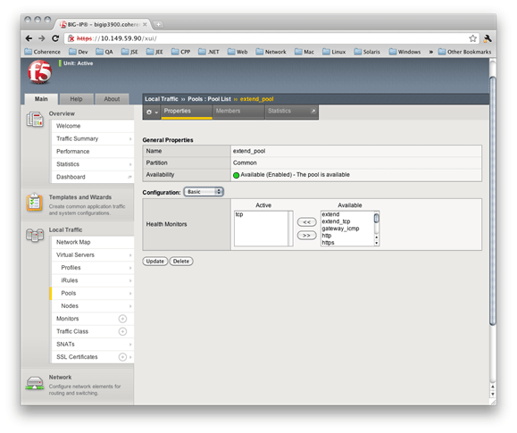

Figure B-3 demonstrates an example pool configuration.

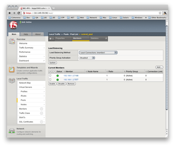

Figure B-4 shows an example pool configuration. It shows two proxy server pool members running on the previously created node and listening on ports 7100 and 7077, respectively. Additionally, the pool is configured to use a Least Connections load balancing policy.

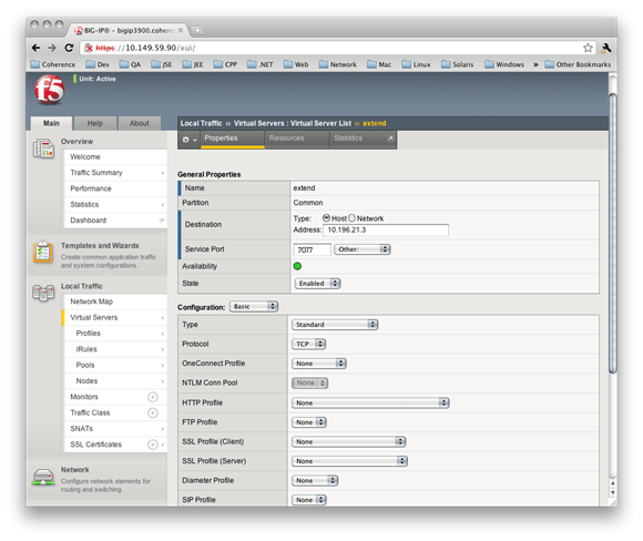

Figure B-5 shows an example virtual configuration that listens for TCP/IP connections on 10.196.21.3:7077.

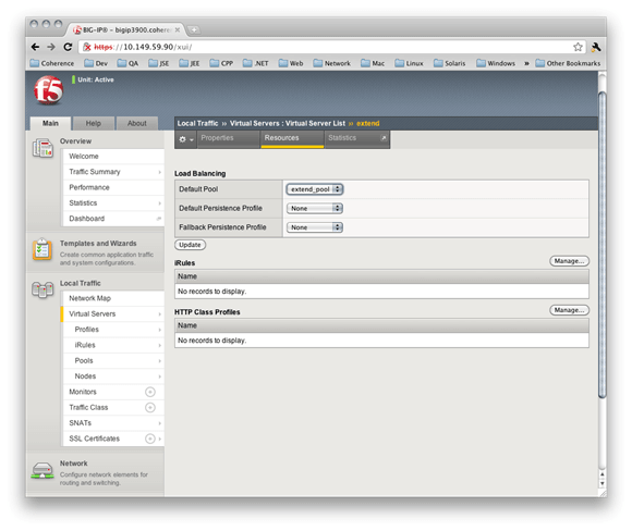

Additionally, this virtual server directs traffic to the configured pool as shown in Figure B-6.
Figure B-6 Example Virtual Server Using a Configured Pool
Description of "Figure B-6 Example Virtual Server Using a Configured Pool"

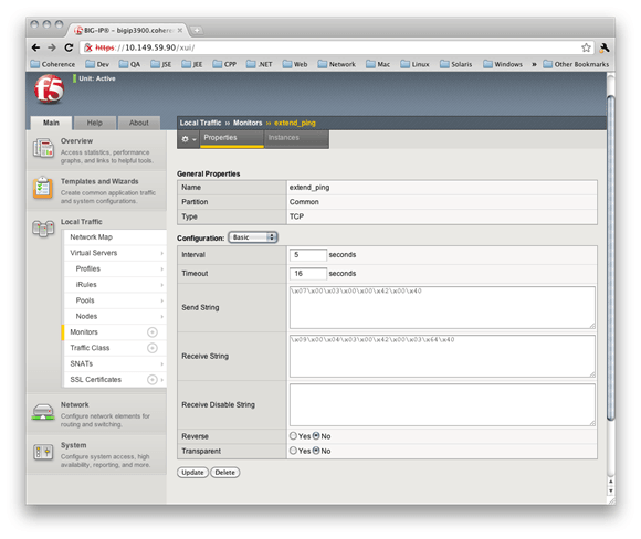

Figure B-7 shows an example custom Coherence*Extend health monitor configuration.
Figure B-7 Example Coherence*Extend Ping Health Monitor

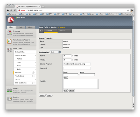

Figure B-8 shows an example external Coherence*Extend health monitor configuration.
Figure B-8 Example Coherence*Extend Health Monitor Implemented in a Shell Script

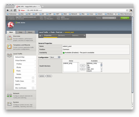

Figure B-9 shows a Coherence*Extend pool that uses a custom health monitor.
Figure B-9 Associating a Coherence*Extend Pool With a Custom Health Monitor
Description of "Figure B-9 Associating a Coherence*Extend Pool With a Custom Health Monitor"

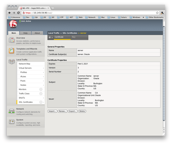

Figure B-10 shows an example server SSL certificate configuration:
Figure B-10 Example SSL Certificate Configuration in BIG-IP System
Description of "Figure B-10 Example SSL Certificate Configuration in BIG-IP System"

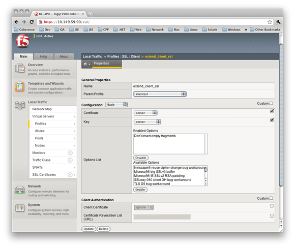

Figure B-11 shows an example client SSL profile configuration:
Figure B-11 Example SSL Profile Configuration

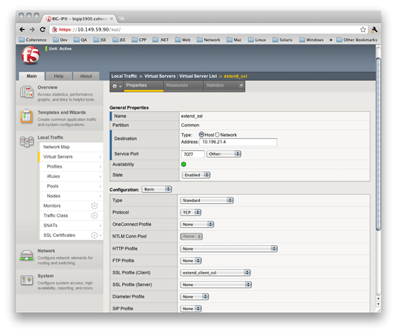

Figure B-12 shows an example virtual server configuration that uses a client SSL profile:
Figure B-12 Example Virtual Server Configuration That Includes a Client SSL Profile
Description of "Figure B-12 Example Virtual Server Configuration That Includes a Client SSL Profile"
