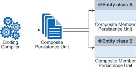

About Composite Persistence Units
You can expose multiple persistence units (each with unique sets of entity types) as a single persistence context by using a composite persistence unit.
Individual persistence units that are part of this composite persistence unit are called composite member persistence units.
With a composite persistence unit, you can:
  • Map relationships among any of the entities in multiple persistence units
  • Access entities stored in multiple databases and different data sources
  • Easily perform queries and transactions across the complete set of entities
This figure illustrates a simple composite persistence unit. EclipseLink processes the persistence.xml file and detects the composite persistence unit, which contains two composite member persistence units:
  • Class A is mapped by a persistence unit named memberPu1 located in the member1.jar file.
  • Class B is mapped by a persistence unit named memberPu2 located in the member2.jar file.
Figure 3-1 A Simple Composite Persistence Unit
Description of Figure 3-1 follows
Description of "Figure 3-1 A Simple Composite Persistence Unit "
For more information, see "Using Multiple Databases with a Composite Persistence Unit" in Solutions Guide for EclipseLink.
