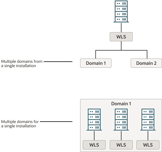

You can use a single Oracle WebLogic Server installation to create and run multiple domains, or you can use multiple installations to run a single domain.
Figure 1-1 shows multiple domains from a single installation and multiple domains for a single installation.
Figure 1-1 Oracle WebLogic Server Installations and Domains
Description of "Figure 1-1 Oracle WebLogic Server Installations and Domains"
How you organize your Oracle WebLogic Server installations into domains depends on your business needs. You can define multiple domains based on different system administrators' responsibilities, application boundaries, or geographical locations of the machines on which servers run. Conversely, you might decide to use a single domain to centralize all Oracle WebLogic Server administration activities.

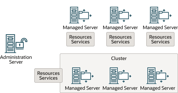

An Oracle WebLogic Server domain might consist of an Administration Server, Managed Servers, and the resources and services that Managed Servers and deployed applications require.
Figure 1-2 shows a production environment that contains an Administration Server, three stand-alone Managed Servers, and a cluster of three Managed Servers.
