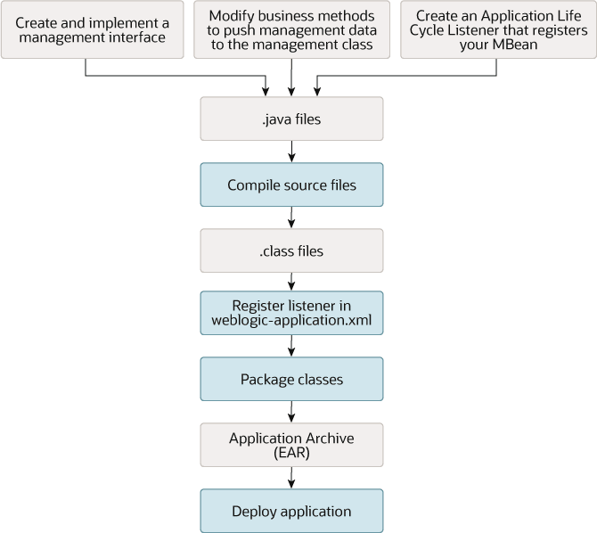

Overview of the MBean Development Process
This section describes the MBean development process.
Figure 4-1 illustrates the MBean development process. The steps in the process, and the results of each are described in Table 4-1. Subsequent sections detail each step in the process.
Figure 4-1 Standard MBean Development Overview
Description of "Figure 4-1 Standard MBean Development Overview"
Table 4-1 Model MBean Development Tasks and Results
| Step | Description | Result |
                                  Create a standard Java interface that describes the properties (management attributes) and operations you want to expose to JMX clients. Create a Java class that implements the interface. Because management logic should be separate from business logic, the implementation should not be in the same class that contains your business methods.  |
                                  Source files that describe and implement your management interface.  |
                                  If your management attributes contain data about the number of times a business method has been invoked, or if you want management attributes to contain the same value as a business property, modify your business methods to push (update) data into the management implementation class. For example, if you want to keep track of how frequently your business class writes to the database, modify the business method that is responsible for writing to the database to also increment a counter property in your management implementation class. This design pattern enables you to insert a minimal amount of management code in your business code.  |
                                  A clean separation between business logic and management logic.  |
                                  If you want to instantiate your MBeans as part of application deployment, create a WebLogic Server   |
                                  A Java class and added entries in   |
                                  Package your compiled classes into a single archive.  |
                                  A JAR, WAR, EAR file or other deployable archive file.  |
