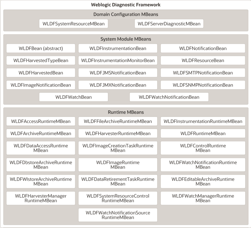

Mapping WLDF Components to Beans and Packages
Table 16-1 lists the beans and packages associated with WLDF and its components. Figure 16-1 groups the beans by type.
Table 16-1 Mapping WLDF Components to Beans and Packages

Figure 16-1 WLDF Configuration MBeans, Runtime MBeans, and System Module Beans
Description of "Figure 16-1 WLDF Configuration MBeans, Runtime MBeans, and System Module Beans"
