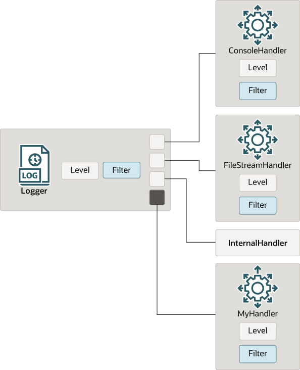

Overview of Message Handlers
Logger
objects (see Figure 4-1).
For example, if your application runs in a client JVM and you want the application to listen for the messages that your application generates, you can create a handler and subscribe it to the Logger
