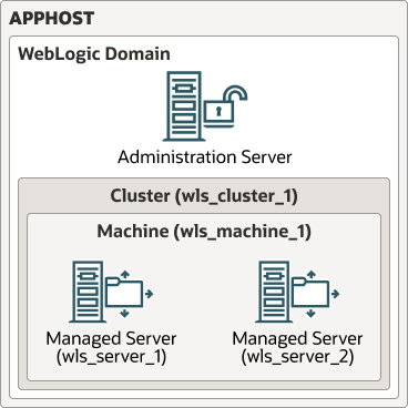

About the WebLogic Server and Coherence Standard Installation Topology
The standard installation topology has a standard WebLogic Server domain.
The following figure shows the standard installation topology for Oracle WebLogic Server and Coherence:
Figure 1-1 Oracle WebLogic Server and Coherence Topology
Description of "Figure 1-1 Oracle WebLogic Server and Coherence Topology"
This topology has a standard WebLogic Server domain that contains two Managed Servers in a cluster and an Administration Server, all configured on one host.
See these topics:
WebLogic Server and Coherence Standard Installation Topology Elements
This section describes the standard installation topology elements.
Oracle WebLogic Server and Coherence Standard Installation Topology Elements
See Roadmap for Installing and Configuring the Installation Topology for a roadmap that describes steps to create this topology.
| Element | Description and Links to Additional Documentation |
APPHOST |
Standard term in Oracle documentation for the machine that hosts the application tier. |
WebLogic Domain |
Logically related group of Java components. In this case, the Administration Server, Managed Servers, and other related software components. See What is an Oracle WebLogic Server Domain? in Understanding Oracle Fusion Middleware. |
Administration Server |
Domain central control entity. Maintains domain configuration objects and distributes configuration changes to Managed Servers. See What is the Administration Server in Understanding Oracle Fusion Middleware. |
Cluster |
A collection of multiple WebLogic Server instances running simultaneously and working together. See Understanding Managed Servers and Managed Server Clusters in Understanding Oracle Fusion Middleware. |
Machine |
Logical representation of the computer that hosts one or more WebLogic Server instances (servers). Machines are also the logical glue between Managed Servers and Node Manager; to start or stop a Managed Server with Node Manager, the Managed Server must be associated with a machine. |
Managed Server |
Host for your applications, application components, Web services, and their associated resources. See Understanding Managed Servers and Managed Server Clusters in Understanding Oracle Fusion Middleware. |
