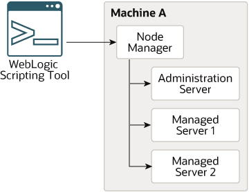

Connect to a Node Manager, then use the Node Manager to start and stop servers on the Node Manager machine. See Figure 3-1.
A Node Manager process may be associated with a specific WebLogic domain or it may be associated with a particular machine. If associated with a domain, you can use the Node Manager process only to control server instances in that domain. If associated with a machine, you can use the same Node Manager process to control server instances in any WebLogic domain, as long as the server instances reside on the same machine as the Node Manager process.
For information about the commands that WLST can use while acting as a Node Manager client, see Node Manager Commands in Administering Node Manager for Oracle WebLogic Server. For information about Node Manager configuration, see Default Node Manager Configuration Administering Node Manager for Oracle WebLogic Server.

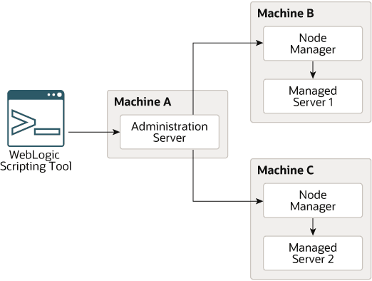

Connect to an Administration Server and then use the Administration Server to start and stop servers in the domain. See Figure 3-2.
Figure 3-2 Starting Servers in a WebLogic Domain
Description of "Figure 3-2 Starting Servers in a WebLogic Domain"
In this case, WLST is a client of the Administration Server, and the Administration Server uses one or more Node Managers to start Managed Servers.
For information about the life cycle commands that WLST can use while acting as an Administration Server client, see Life Cycle Commands in WLST Command Reference for Oracle WebLogic Server.
