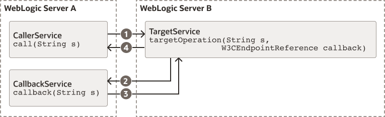

The following shows the flow of messages for the example callback implementation.
Figure 26-1 Example Callback Implementation
Description of "Figure 26-1 Example Callback Implementation"
The
call()method of theCallerServiceweb service, running in one WebLogic Server instance, explicitly invokes thetargetOperation()method of theTargetServiceand passes a web service endpoint to theCallbackService. Typically, theTargetServiceservice is running in a separate WebLogic Server instance. -
The implementation of the
TargetService.targetOperation()method explicitly invokes thecallback()method of theCallbackService, which implements the callback service, using the web service endpoint that is passed in fromCallerServicewhen the method is called. -
The
CallbackService.callback()method sends information back to theTargetServiceweb service. -
The
TargetService.targetOperation()method, in turn, sends the information back to theCallerServiceservice, completing the callback sequence.
