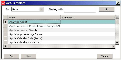

Creating an Applet for the IFrame
After adding the fields to the business object, you must create an applet for the IFrame. For this example, do the following:
Modifying Applet View Layout
When created, the IFrame applet uses a generic layout. To view and modify the layout, do the following:
