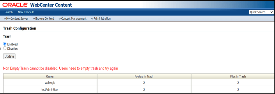

Configuring Trash
You can configure FrameworkFolders component in On-premise Oracle WebCenter Content to enable or disable trash. This feature is available to the users having Administrator access.
To toggle the trash feature:
- Choose Administration, then FrameworkFolders Configuration, and then Trash Configuration.
- The Trash Configuration page will appear. You can choose to Disable or Enable the trash feature. By default, the trash feature is enabled.
If you disable trash, the trash folder will no longer be available under the
/Users/<username>hierarchy. Before you disable trash, the trash folder should be empty for all users in the system. If there is any content present in one of the user’s trash, the system will not allow disabling trash. If you try to disable non-empty trash, the below screen will appear showing the content present in the trash folder.
